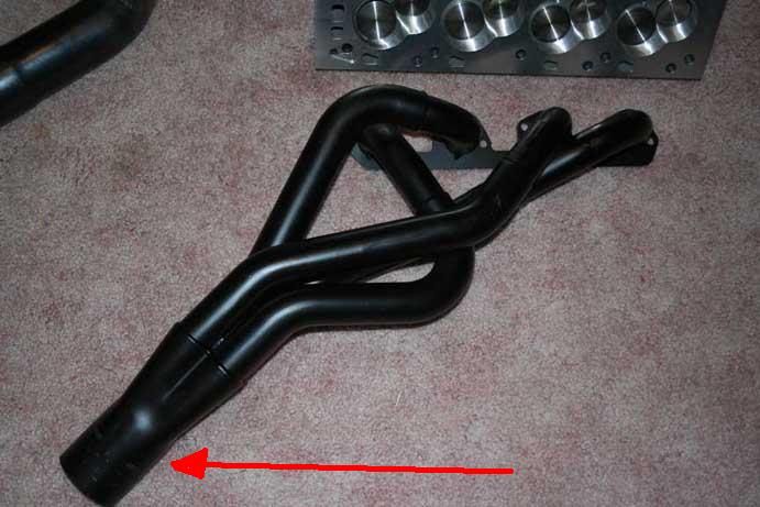

I Put My o2 where the red arrow points lol it was the easiest place when it was on the car, i just found random fittings and plugged off my egr. The exhaust under the car makes a bit more noise in the car, and might make it smell a little in the car, it did in my 97, but i havent noticed in my fox, just the noise, i plan on putting it out the back one of these days.
