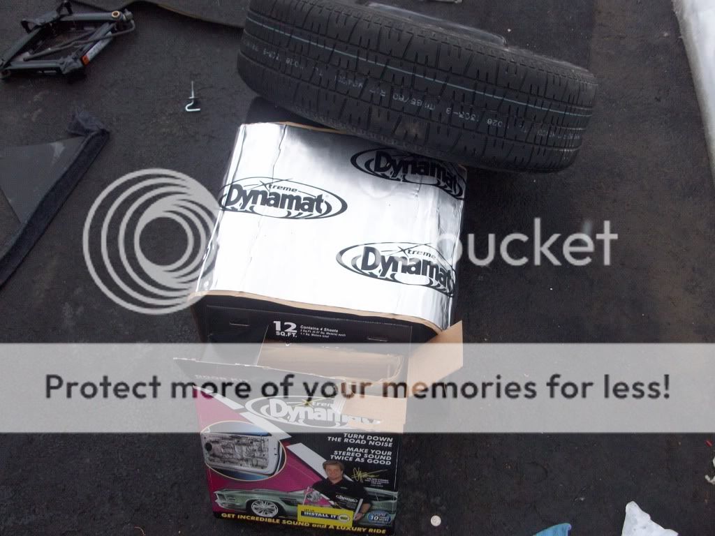

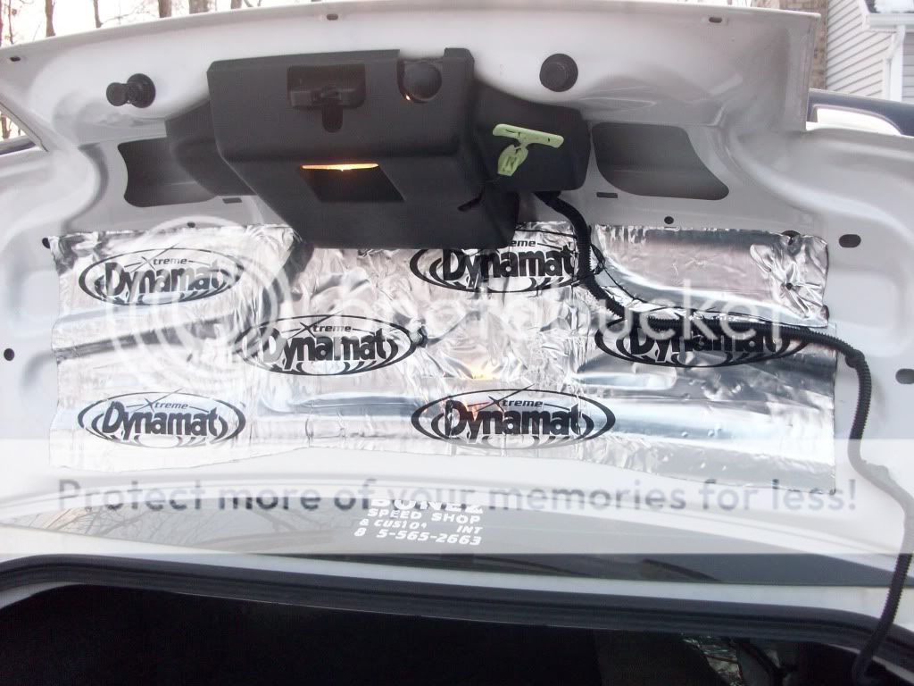

Ok 2006GTARPD3 (ARKIE) and I decided that my car was unbearable for long drives at low RPM's in the cabin. We thought of several options, including returning the exhaust to stock. I love the sound of my car standing outside, however, I love my music too, and returning to a stock style exhaust wasnt an option in either of our opinions.
We decided to go to best buy to see what they had as far as sound deadning materials. On th way there both of us agreed tht we had to do something to it. We could carry a conversation fine until fifth gear between 45 and 55 MPH. The drone was horrible, like ear bleading horrible. This however wasnt always like this. Since i moved from 3.55's to 4.10's the rpm/speeds were drone is have changed. and were I do most of my driving takes place btween 45 and 55MPH.
Dynamat seemed to be the thing to do, just to try, before I changed the sound that i have spent so much time on tinkering to achieve. We went to Bst Buy and te only DYNAMAT they had was the Dynamat door kits. a total of 12sq feet per box. So i bought the onl 2 boxes and hoped it was enough. The mron there said, " we only use the door kits, thats how we do all the trunks, one box will be plenty". For some reason i figured 12sq feet wouldnt be enough. And i was right.

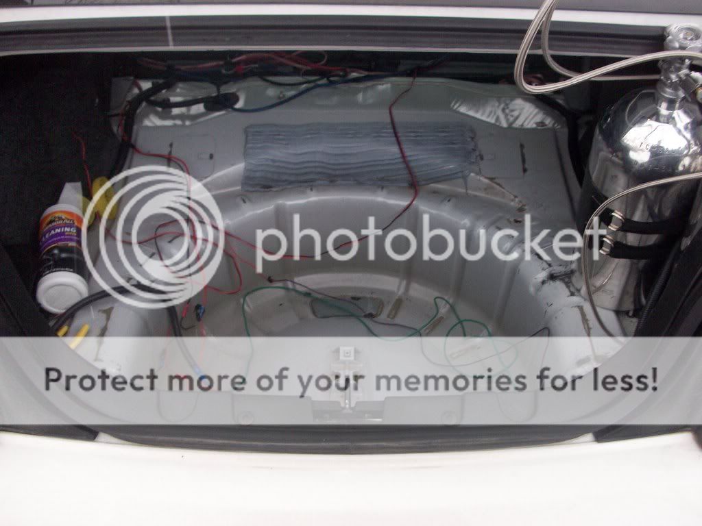

Now for the Install in the trunk
Tools Needed
1. Razor Knife or sharp scissors
2. Roller (reccomended, but i didnt have one)
3. Mild detergent, and water mixture (to clean Install surface beforehand)
4. A case of cheap beer ( cheap because the dynamat is expensive as hell
Install like the directions say

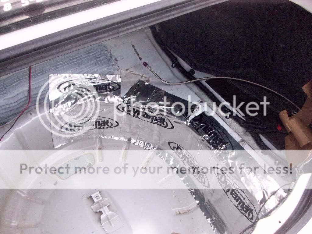

Tips for the S197

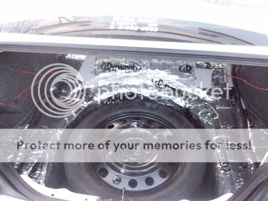

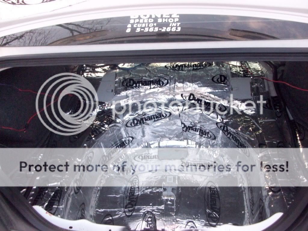

start with the spare tire well. run a peice along the vertical part, cut it to the flat surface and it will allow you to fold over onto the actual trunk deck and continue in the circle.
Save all your scrap. The dynamat absorbes Vibrations. Stick it in little areas
make sure you dont cover your fuel pump doors.
Lift up your wire harness and lay the dynamat underneath. then push were the bold comes out for the harness to clip on. The dyna mat will rip right through it allowing you to utalize the same chanel for your wires in the trunk.
Lay the dynamat like a vinyl. It is very sticky. Lay one ide down and press out towards the other end. This will keap a nice surface.
Press hard and form it to the contures of your trunk. It flexes very easy.
Have fun.

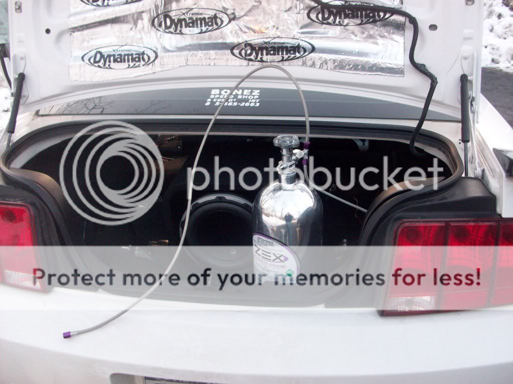

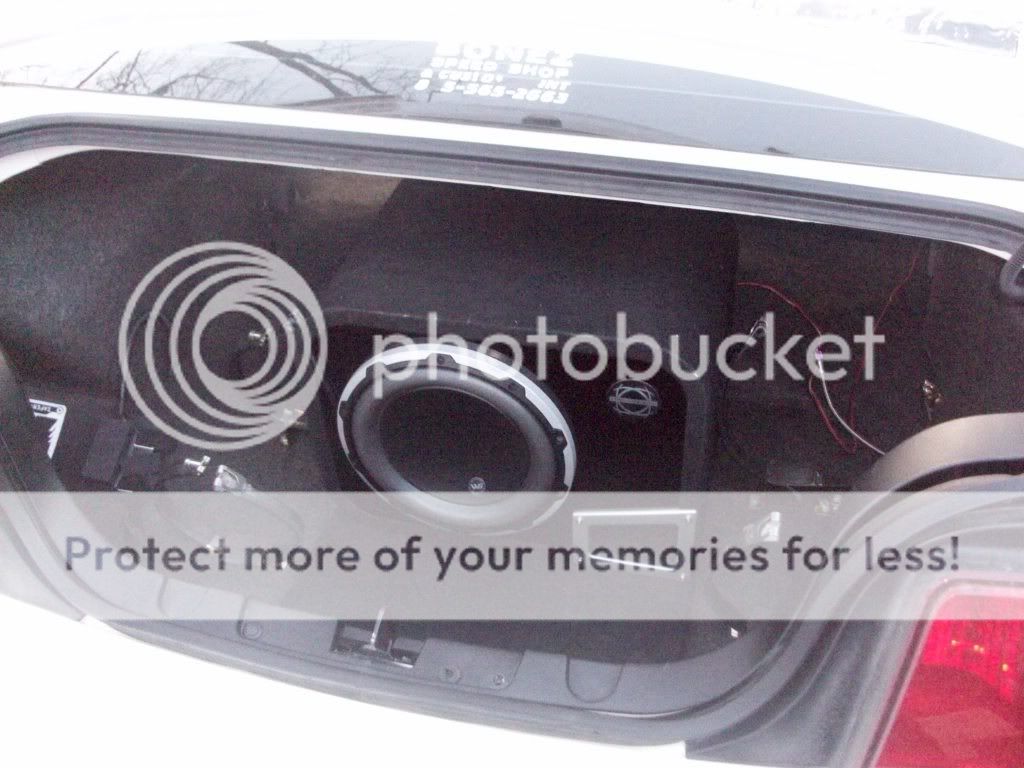

THE RESULTS
AMAZING.....
It tigtened up the sound of my music. Removed rattling noises i heard from my trunk. And my exhaust sounded similar in decibals to when i purchased the car.
Bass def. Hits harder. i had to turn down th amp.
Arkie and i took a ride. We carried a conversation, and i could even hear my intake sucking air again (its been a long time since i heard it).
When i talked to arkie on the phone while i was driving (something i dont condone ! Just a test ;o) arkie couldnt tell if i was in m car or truck because he couldnt hear the exhaust.
The only real downside i would have to say is the weight. It is pretty heavy for bieng a liner, however, the two boxes total couldnt be more than 8 pounds, and if that 8 pounds matters, just eat salad and quit drinking soda for a month .... You will lose eight pounds... maybe more, and it will make up for the weight.
The dynamat is in the trunk so i guess you could argue that the 8 pounds helps keep the rear down, Not sure if 8 pounds would make a differeance.
AND THE BEST PART ABOUT IT IS I DONT HAVE tO CHANGE MY EXHAUST !!!!!!!

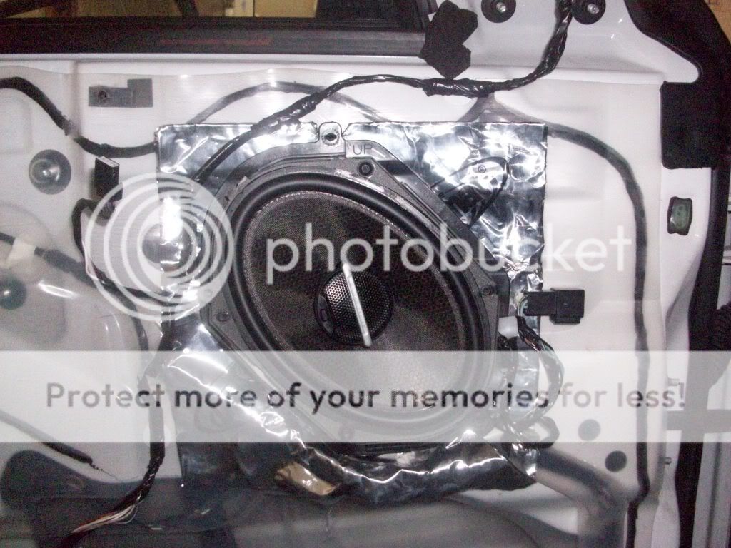

i only got dynamat cause thats what they had. yeah thats next for me, floor and doors

iTrader: 12 reviews
Interesting that you put it on top of the weather seal in the door...

no just the ends are... it is cut behind and stuck to the metal... i overlapped the end of the dynamat over were i cut the plastic...however... i think if water were to get in there the speaker would be ruined
