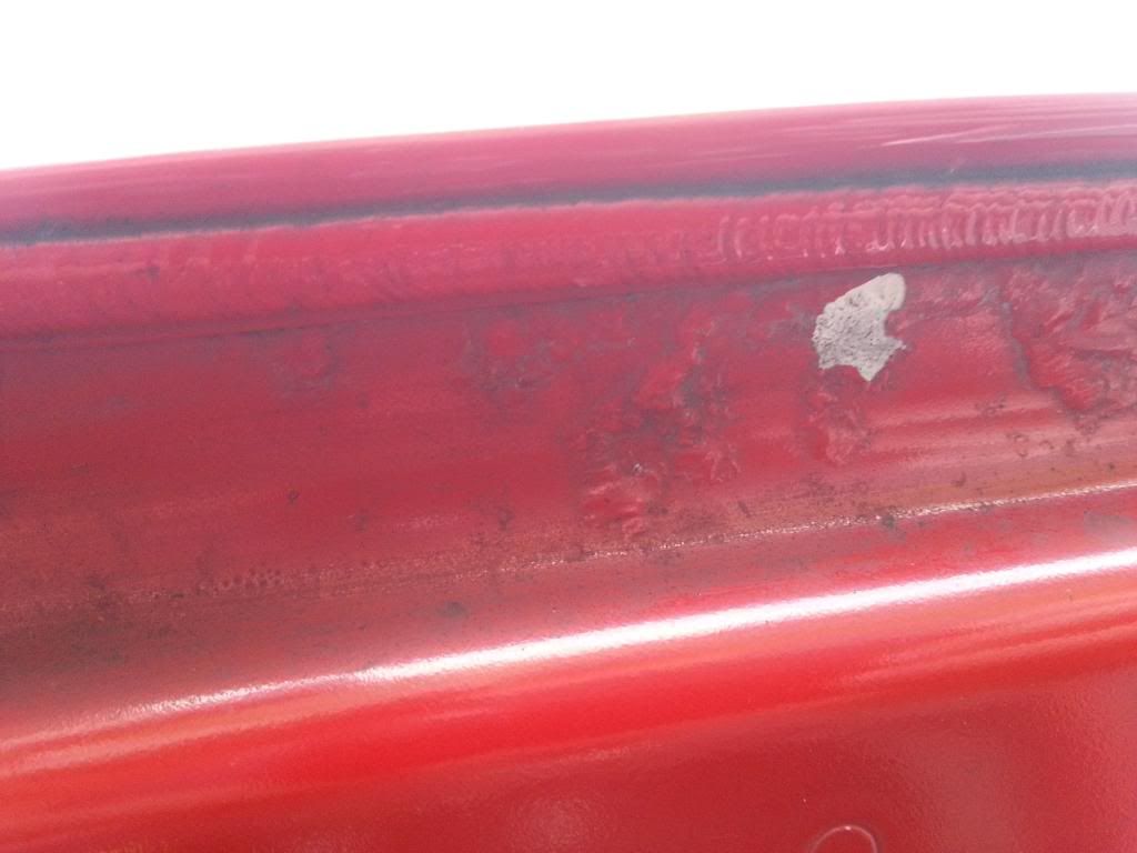

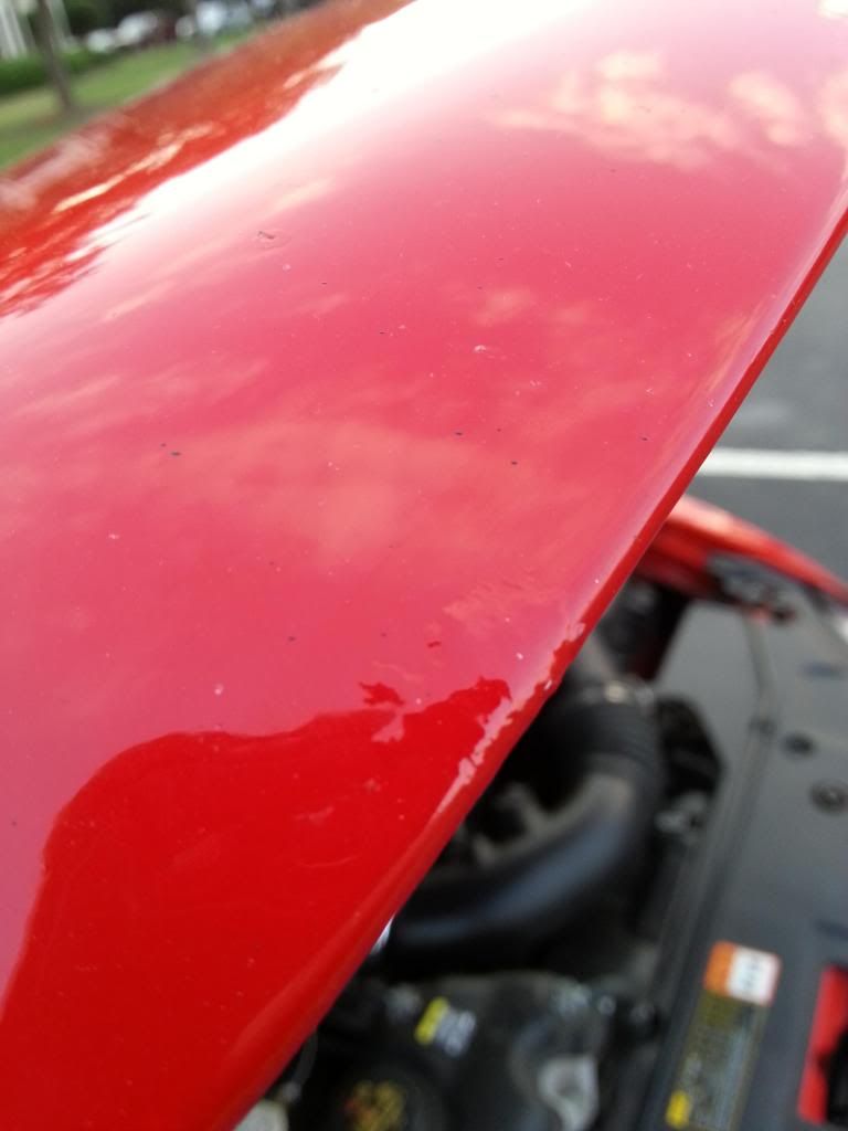

That's what it is Priddy.
I took a few pics. Disregard the tar specs on my hood. Roadwork going on in my daily commute. Washed the damn thing yesterday and it's already looking rough. Unfortunately mine is significantly worse on the underside than yours. Not the only spots but the ones that came out the clearest in pics.
Yes that white spot is where the paint has peeled because it's so bad. The other spots under the lip of the hood are cracking slightly.
Will be taking it in soon. Maybe they'll help. It may end up being a widespread issue and recalled. My mother had a 01 Trans Am and they had issues with the clear coat peeling, they recalled them for that and fixed them on GM's dime. Who knows what Ford will say.

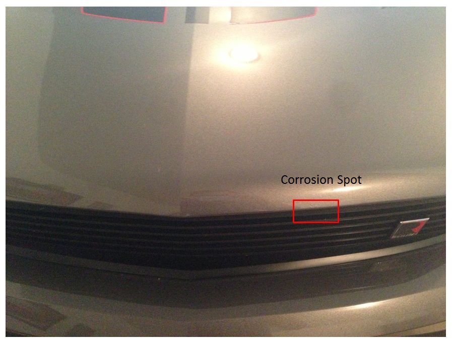

wow. you guys have it lucky... im the second owner and 47000 miles... i have a strip about 4 inches wide going about the complete lip on my hood :facepalm
