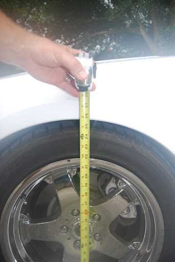

So i haven't got to the bottom of my rubbing issue, its also eating the top front of the plastic wheel well. But have some better info and would like help on what springs to buy. My front end has 03/04 Cobra H&R Race springs. (51659) on a 99 Cobra vert. From all that i have read, if you use 99-01 Springs on a 03/04, the drop will sit about a 1/2" higher than if you used 03/04 springs of the same make. Is the opposite true? If i go with steeda sports (aprox 1-1.25" front) for the 99-01, strictly by the numbers, it goes from 1.6(h&r) to 1.25(steeda). Would i expect any extra gain going from 03/04h&r to 99/01.. Lastly,, I'm pretty sure i can just go with stock springs form a 99-04 and be ok,,can anyone confirm and does anyone have stock springs they would like to sell. Tried to post in classified, but need 100 posts.. Any thoughts would be great. Posted this pic already,, just a reference.

I don't have any facts, but I'm pretty sure using a spring for the 03/04 Cobra on a 99, would make the car sit higher than it would on an 03/04 Cobra, because the Termi's should have more weight up front, therefore would sit lower....
