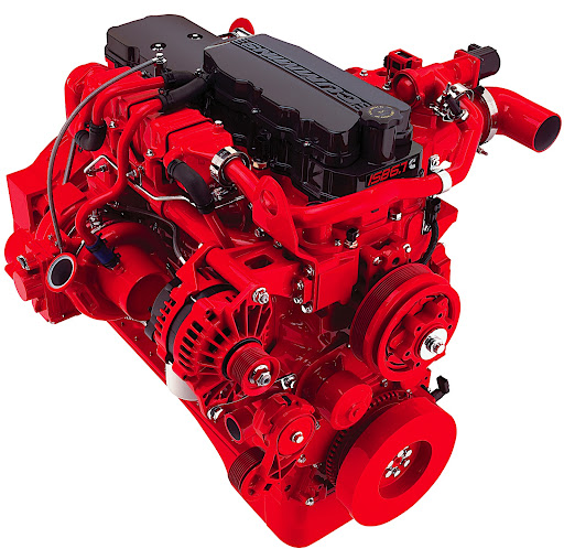

Maybe we're having a problem with words again. We do refer to application specific designs on engines as both "separators" and "coalescing filters." "Breather" is also an acceptable term here, though to some this would mean an open filter on the valve cover.
Take a look at this:
See that big ass black box that sits on top of the valve cover? Call it what you want, separator (after all, it does separate oil from blowby gas), coalescing filter, or breather. It's a big ass box where blowby gases go in, oil is filtered out and returned to the crankcase, and the filtered air is sent on its merry way (you can see the tube that goes into the turbo inlet). That is what I mean when I say any of the above terms.
Ya dig?
