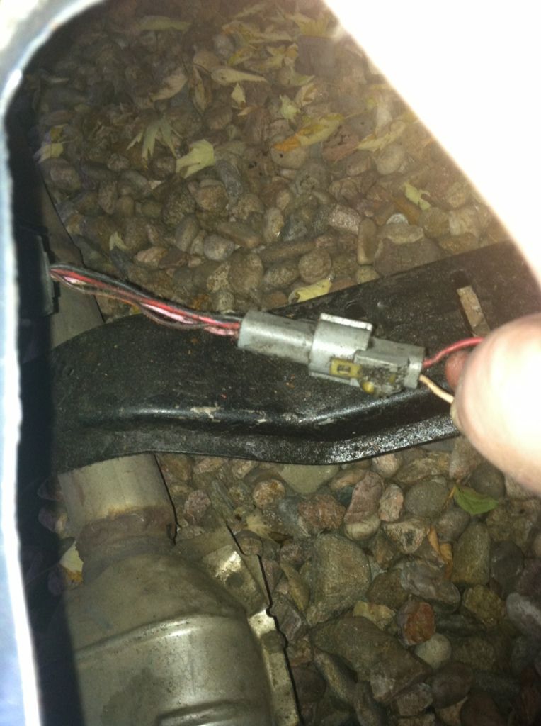

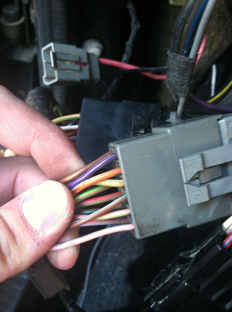

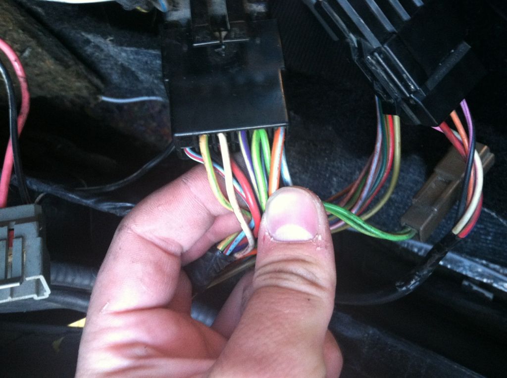

The 87 harness color is not the same apparently as the 88 as in his write up. I got the whole thing done except for the VSS signals. Do you guys know what colors I need to tap into for that? Everything I have read is DG/W and O/Y wires, but this car nor the other 87 I have does not have these wires. I have two options on the VSS so If worst comes to worst, I will figure it out by trial and error, but I would rather not.
Here is my harness options.
Under the car.
ON the kick panel
Thanks guys

That's odd, when i converted mine they were right their in the open. Is that the correct connection, because their are a few in the kick panel? It might be something with cruise control as nxcoupe alluded too.

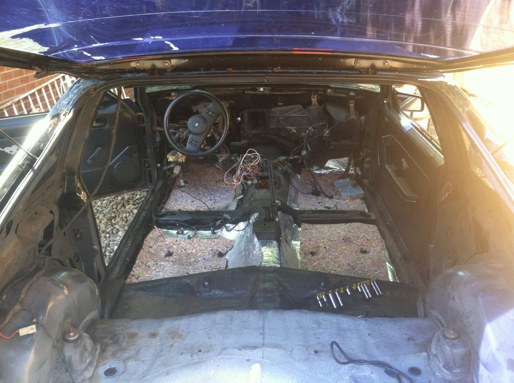

Now I just wonder if I am color blind or dumb or this car is weird...
Here is how I bought it...
How it looked a few weeks ago...
And how it is today.
I have a total of 700 bucks into it as of now, and I have a fresh rebuilt 5.0 for it and a t5 that I need to rebuild included in that cost!

Nice! I can appreciate the budget build, I have about $1600 in mine but had to piece the motor together and rebuild myself. Make sure you have the right connector. It runs from the Trans tunnel up to the dash and either behind the radio or left kick panel. Mine was behind the radio but it's a 86.

That connector with the loop in it is for the reverse lights. Vss will be a separate hrness down there. If it didnt have cruise, it wont have a vss
