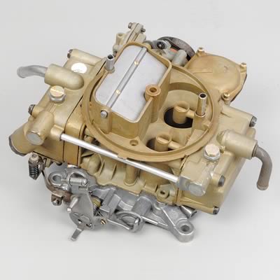

does anybody know if i could eliminate the 2 lines going to the floats at the sides?

You can. They are emission recovery vents. Use gasoline proof epoxy if you remove the tubes completely.
