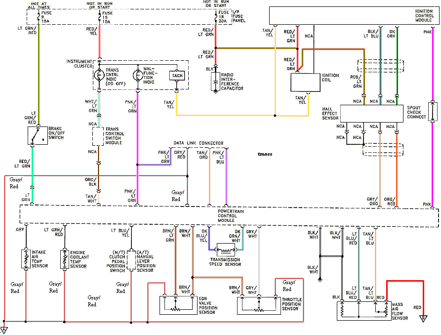

Originally Posted by SNmustang95 View Post
I have 1 volt going to it.
1 volt when? Need more specifics.

With the throttle closed and I mean .1 sorry. And open it's barley .90

You're checking this with the key on correct? Going by this diagram, You'll need to check between the vref and sig return wires to make sure the TPS is getting the proper 5v signal in and ground reference. Gray/red should be your vref and brwn/wht should be your sig return. Put the black lead of your meter on the sig return and the red lead on the vref and you should see 5 volts with the key on. If you do then you need a new TPS. If you don't then you have issues with your wiring, a connector, or the EEC.
Edit: if your meter reads-5v then I have the vref and sig return backwards. Either way will work. Just as long as it reads 5v or -5v. All -5v means is that the leads are backwards.

Ok so wait, black to the middle wire, and red to the red and grey? Or vis versa? I never got anything to either.

The brown/white wire should supply 5v to the TPS (Vref) so you need to tap that one and a ground to find out if you're really getting a 5v reference voltage.
The output voltage from the TPS to the PCM is carried by the middle wire (grey/white). You need to tap that one and a ground to measure the voltage with ignition on, engine off. It should be around 0.95-1.00v with throttle closed, and increase gradually as you slowly open the throttle blade to a maximum of about 4.5v. If there are any voltage spikes or dips as you open the throttle, the TPS is shot.
The third wire (grey/red) is the ground.
This article explains everything:
Setting the Mustang TPS Voltage
