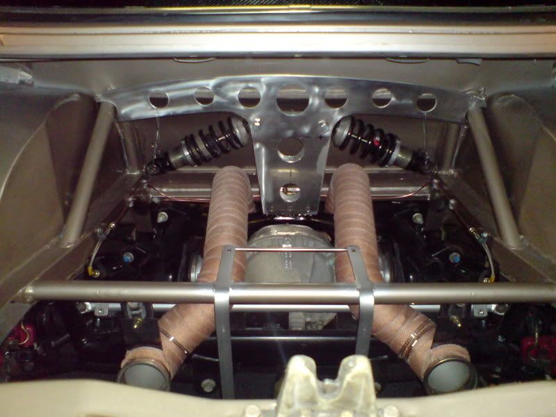

With this serious motor combination sitting under his hood Joel now needs an efficient means to plant the power produced by this very lethal combination. Not wavering from the blue oval, Joel decided on a new rear suspension setup courtesy of a Cobra R. A complete independent rear suspension swap.
Above is the modified independent suspension from a Cobra R Mustang.
This swap was not your usual “bolt-in” style swap. Joel needed to create his own mounts to tie the new independent rear axle into the factory Ghia frame. Here Ingar came in handy and created his own bracing to mount a set of canti-leverŽed coil over’s.

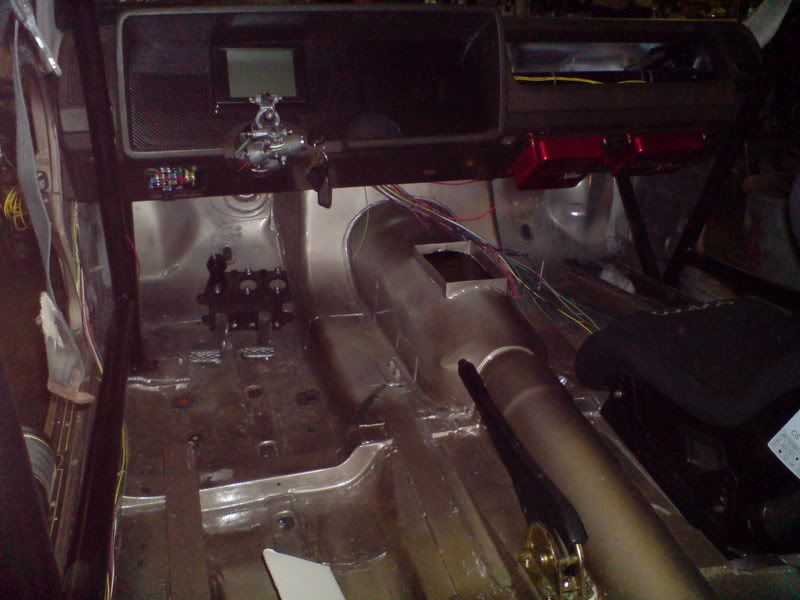

In between that nice new rear end and the back of the motor Joel would need a stout gearbox and a heavy duty driveshaft. To pull those duties Joel chose a Liberty built 5 speed transmission with an external fluid pump and cooler. It has a Tilton 4 plate carbon clutch is allowed to slip a fraction more than your std clutch to lessen shockloads to the driveline when it is dumped slipper clutch to absorb some of the shock the drive train. The car also employs a Nascar certified 1600HP driveshaft. Some serious modification had to made to mate all the components to the Ghia. Below are some pictures to show some of the work done.
Above is a mock-up with the new Liberty 5 speed in place while making the new transmission tunnel.
New Tunnel almost complete with the beginnings of the driveshaft tube in place as well.
New transmission tunnel and driveshaft tunnel just about complete.
View from front to back of the new locations of the new driveline.
