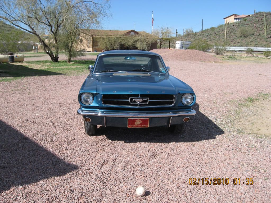

This is where I was:
This is where I is:
I bought this car new in 1965 from Jim Sanders Ford in Houston Texas.
