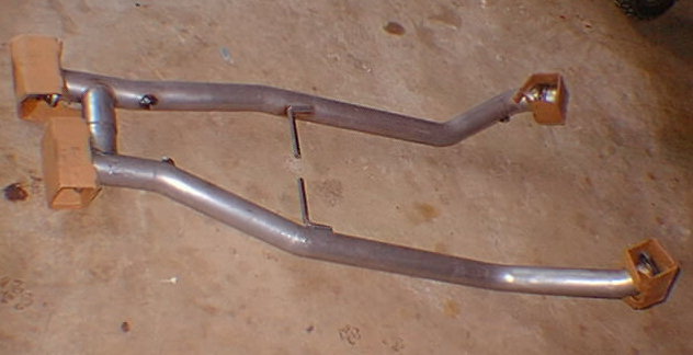

heres what an offroad H pipe looks like for shortie headers.
