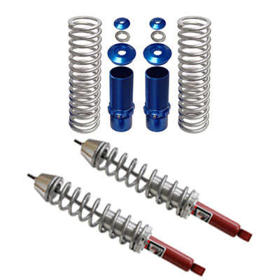

Killax15
qua1 k member kits are cheaper.
tubular k member/coil over kits are primarly recomended for drag racing to reduce weight but not a fan for street or track use--acording to sean hyland book. here's why.
moly tubing is more brittle than mild steel and can crack after a while, then u need to weld.
high maitenance..
so if u really want one get mild steel--kenny brown k member, i want one too cause they look really cool and would be a fun project to work on, but for now i'm just gonna stick with basics.
2nd problem coil-over kits require bearing plate between top of spring cup and underside of camber/caster plate. they usually come with torington roller bearing thrust washer, which can quickly become contaminated by water and dirt.at this point the bearing becomes self destruct, and or merly creates additional friction in the steering system. and he goes on and on and on.
for rear alternative supension panhard and or torque arm, or relocating suspesion links and all sorts of other things, mixing and matching all these different systems u get a car that doesn't work properly because someone has changed the antidive or roll centers, and average owner doesn't have the time or expertise to sort it all out.
stick with basics-- springs, anti-roll bars, bushings and buy best dampers u can afford. u won't be sorry--sean hyland high-performance mustang 1994-2004 builder's guide.

That's all well and good, but Maximum Motorsports builds their stuff for one purpose: road racing. They do sell a kit for the straightline crowd, but their parts are designed from the ground up to hold up to the abuse that a race car sees.
I would highly suggest that you read at least one more book on Mustang suspension; I'm not saying Sean Hyland's book is wrong, but it's good to get a few different points of view. How do you know that his setup is what will work best for YOU? You don't. You just know that it's what works best for him. You also don't know if he figured out something different that works better after that book was published.
Just as a curiousity, what's the copyright on that book? The American Iron series has really pushed Mustang suspension; it's only in the last 5 years that can now buy a bolt-in double-wishbone front suspension; that used to be a custom build requiring custom dollars, now you can pick one up for the price of a mediocre foxbody.
Again, I'm not saying that anything in that book is wrong, but I'd be VERY hesitant to read just one book and take it as gospel.

what does anyone think about coil-over without k-member and how does it work i don't understand these spring rates, are they for drag racing??

CO's are a wonderful way to go, but don't recommend you go into them on your own. I think you are best to purchase from someone who can set up your ride for you. Most will be happy with standard springs/shocks/struts as you will get improved handling (if not too aggressive on drop, spring rate, etc...)
This is really a better question for the good Reverend or MM97GT (the OP of this thread) Both are MUCH more knowledgeable than me on these things and can be of better technical assistance.

or these, anyone know the specs on these?--79-04 MUSTANG BILLET FRONT & REAR COIL OVER KIT QA1 GT
