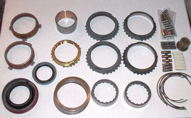

Got the engine built. Still need to paint it, but I will run if I want it to. Forgot to get a pic though. Tore the tranny down. All the bearings and gears are in good shape so it will not take much to get it going again. I'm going to get a basic kit. I don't know if I should get the billet keys though. The stock ones were fine.
The rebuild kit
T5 Transmissions
The picture of what I get
Before
After
