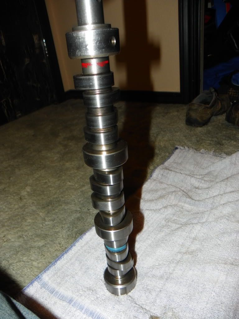

For those of you interested in a Cam or N/A build, I will give you my dead honest opinion being that I have just done this. Dont... Simple as that.
Now its hard for me to explain this and add up costs, simply because I had to buy entirely to many parts twice. But if I bought it all up front and had no issues, its still scary. Had I spent the same amount to get it dyno'd turn key, I could have done a basic turbo kit on a stock engine and put 300-350rwhp and probably would have been easier to do. I know FI sounds scary, but if done right and a good dyno tune used, it can be very safe so please dont let that be a factor. So if your looking for power and track times, N/A is not the way to go at all !!!!

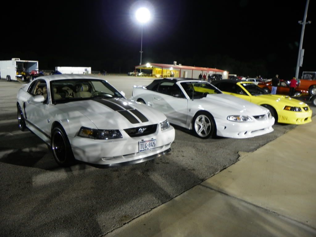

I will say I really really like my car, I get many compliments on it, and many people have said its the best sounding cammed 6er they've heard. 14.37 and 9.23 track times on a stock auto aren't bad but aren't good either !!! If your interested on a FULL mod list, please view my garage. Im only 20 years old, Ive been good about saving most of my life and spent a shit load on this project. I was not working full time during this but was going to school full time and work prn (20 or so hours a week I guess). Paramedic shool is no joke either! Also know that the day I started this project, their was Ice/Snow on the ground, ice sickles dripping off the roof. I did this in an open car port, and thankfully it was on the south side of my house, so it helped block the north wind. Most of my work was done In th evening as well, some nights I was up till 2am working. 20* weather. It was cold. It sucked. Life story huh?

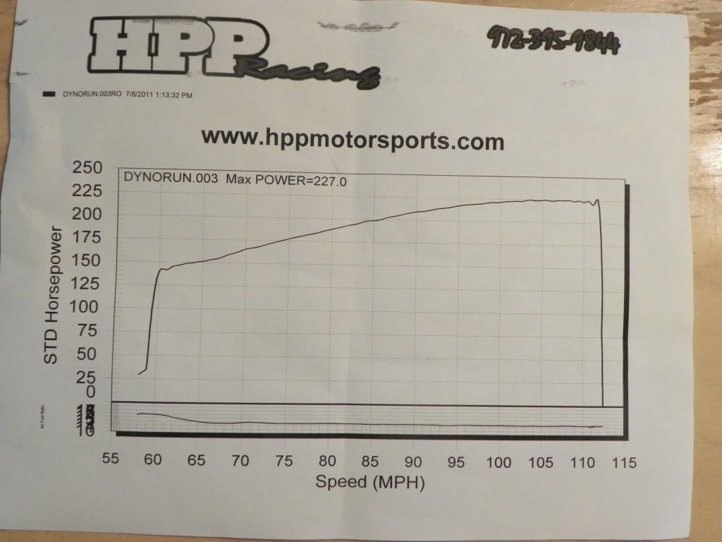

For a teaser:
Hope people have enjoyed this thread, I know its long and lots of bs included. Im sorry all the pics are gone. But Ill be more then happy to give whatever I can to anyone. I still have all my pictures !!!!
And just for an update, This friday or maybe next monday, I have a 3200 9.5'' stall from revmax on the way. Engine is out and getting peiced back together after my head gasket leaking ordeal ...
Cant wait to see new 60' and ETs !!!
227whp N/A V6

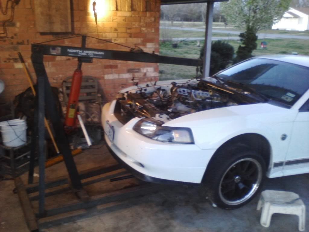

didn't we just say them all? honestly i don't know how we can go more in depth without making a video/a write-up with pics of removing every bolt. But, here it goes...
Drain Radiator
Disconnect necessary electrical connectors (including crank/cam position sensor)
Remove upper intake
Remove Lower Intake
Remove Valve Covers
Remove Rocker Arms
Remove pushrods/lifter holder thing/lifters
Remove fan
Remove alternator/PS pump bracket (I'd recommend removing the alternator because you just leave the PS pump/bracket hanging there IIRC)
Remove the Camshaft Pos. Sensor
Remove Cam Synchronizer Assembly (while cyl 1 is at TDC of compression stroke, there is a mark on the balancer to line up. Then mark the whole assembly with a marker for proper re-install alighment. tooth should be in middle of window at this point)
At some point, you've got to remove the crank pulley with a puller tool (can carefully reinstall with a piece of wood and sledge hammer)
Remove Engine Front Cover
Remove...i don't remember right now...it should be very obvious after this point. when removing the timing chain, you have to prop the tensioner back. should be easy to follow the rest in a manual.
Just be careful when removing and installing the cam (timing marks should all be lines up), not to clunk it around and damage the journals at all.
it's really not that hard. then reverse and refill fluids. and change oil too in case you got water in it, which is pretty likely.
Everyone feel free to correct me in case I missed anything.
hope this helps! just ask if you need more help.
