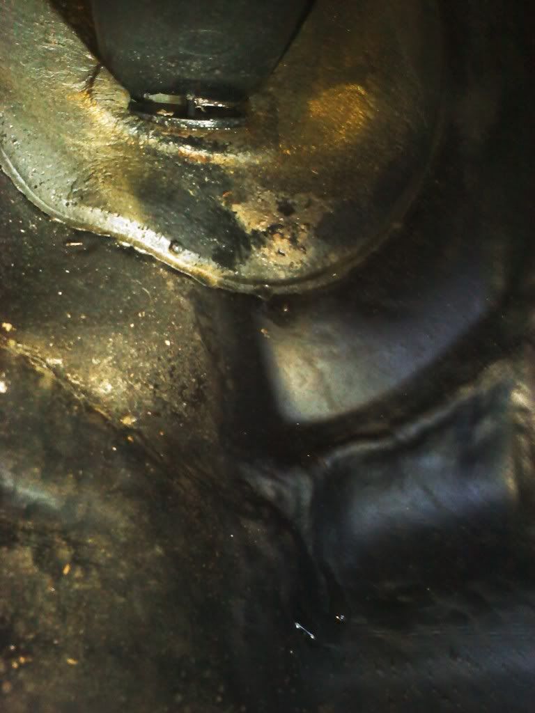

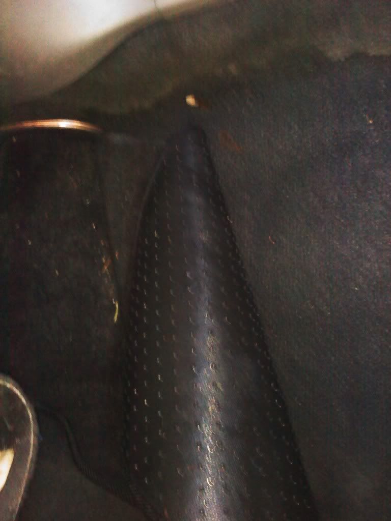

post #10 of 13 Old January 6th, 2011, 05:43 PM Thread Starter
T2.
T2.'s Avatar
Location: Tallahassee, FL
Posts: 78
Send a message via MSN to T2.
under the Carpet from the Firewall,
Under the floor mat (how bad it is)
T2. is offline
post #11 of 13 Old January 6th, 2011, 06:14 PM
Join Date: Oct 2009
Location: Jacksonville, Florida- in a van down by the beach
Posts: 717
Yeah that weird foamy gasket. Mine is still drizzling from there. I'm really not sure how to fix it. My mechanic took a rod and checked in the drain Sid on the firewall but it's still coming in the car idk - but yeah we have the same thing, hopefully someone can offer a solution.
