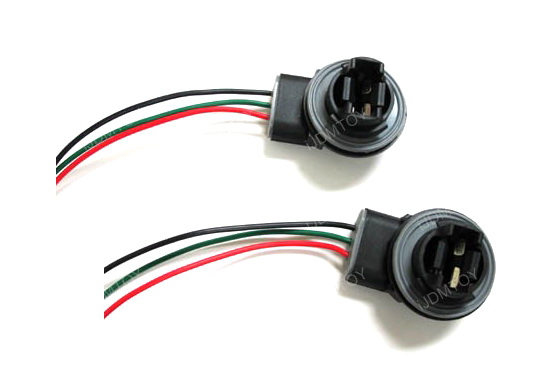

okay take a look here.
red= low power
green= high power
black= ground
all you have to do is cut the green wire and splice into the red wire(green wire coming out of the socket) then it will send current to both bulb filaments making both of them light up. Or you can eliminate the red and and splice only the green to the red one so only the Bright filament will light up constantly.
Its all a matter of understanding your wires.

ok, but what if you switch the red and green?
so run the red where the green was and green where the red is. wouldn't you still get the flashing effect?

it will be backwards obviusly and will work, but why would you want a Low flash when you put your turn signal?
