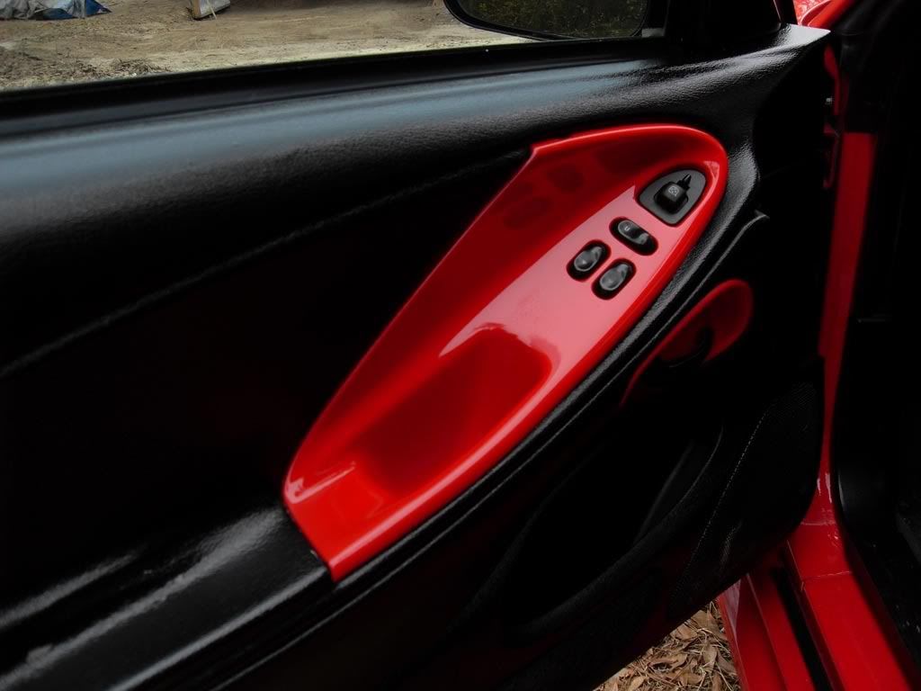

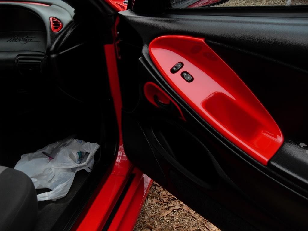

This is the kind of results you can expect from these techniques:

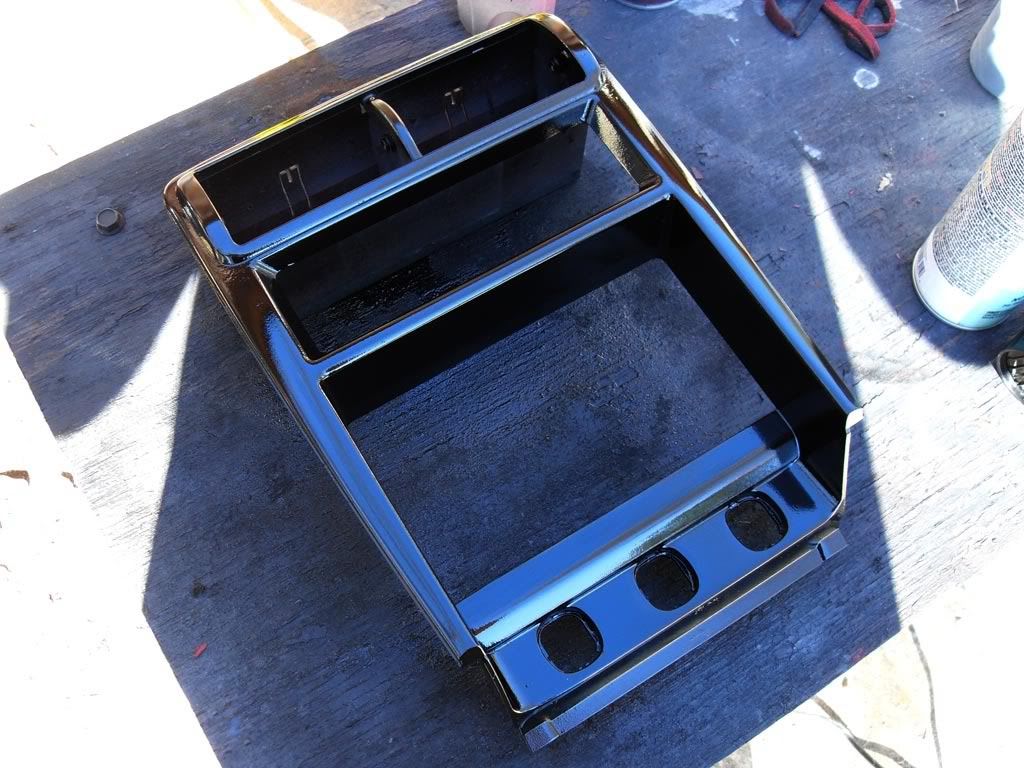

updated the post with some pics

Naw, I kinda don't like a LOT of red. Honestly I am considering painting the cup behind the door handles black hehe.

Any more pics? Like maybe a full interior/mid section?

This is an old one tho... The center piece is now black.
