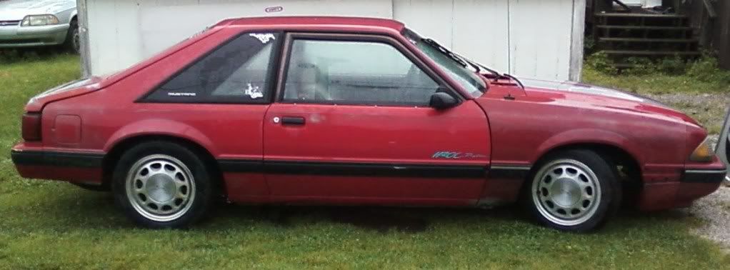

Bad picture, but ill get a better one soon.
Before

Its amazing how much btter they look with newer mustangs stock wheels! Very nice.
