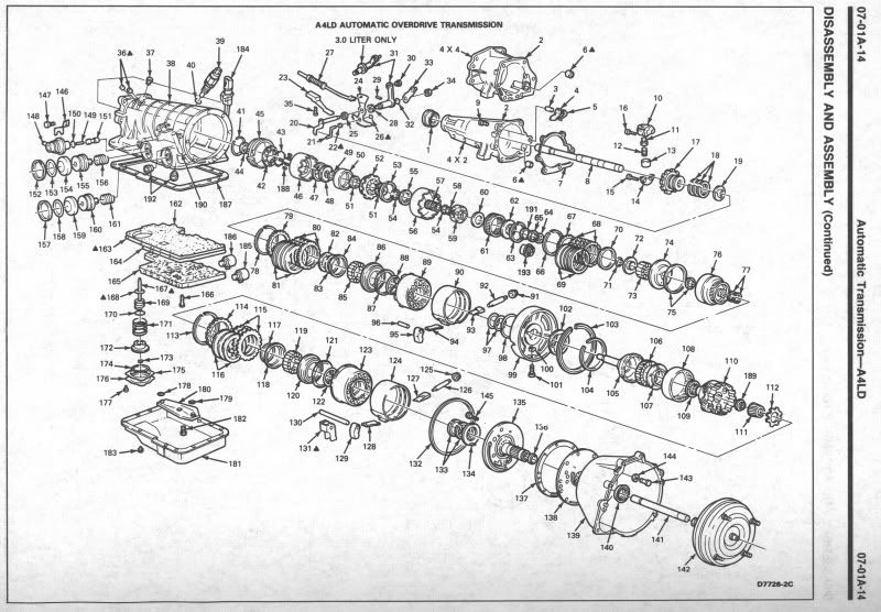

Behold, the A4LD!

I can see why it's a pain in the ass. That's more confusing than the car's wiring diagram.
Went to the junkyard today. There was ONE fox body: 1986 5.0 LX convertible. It had nothing for me... I mean the motor/trans would bolt right in the wagon, but I blew that money on the coupe. Did get a few Ranger 2.5L intake pieces I've been needing. I now have a spare, and a couple fuel rails, to upgrade my older 2.3/SVO stuff with. Once that's all together I'll sell the useless K&N horse crap my dad got for the truck.
Thanks for the diagram, enjoy the Chinese!
