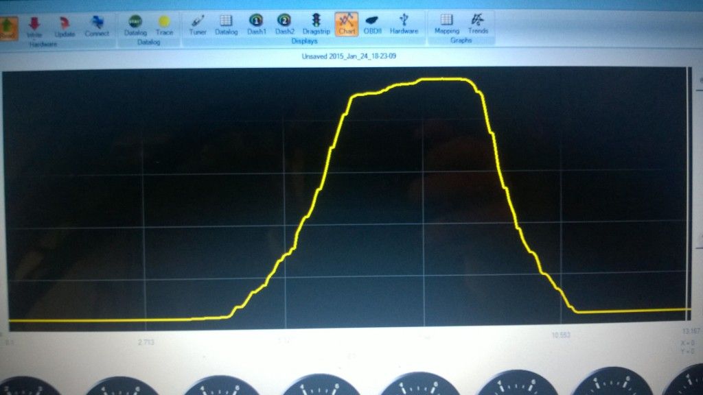

I have a graph of the tps signal, using the tuner i started a data record then slowly rolled on the throttle and slowly back off (automotive school training kicking in) and it looks good no bad spots i can see.
