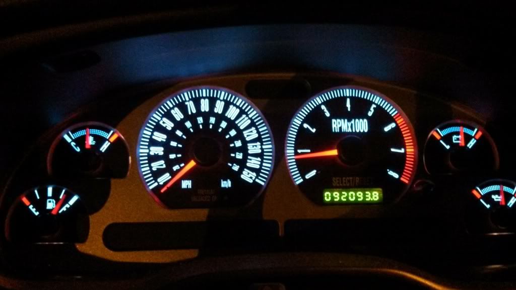

I don't think the 194 series will fit behind the speedo. Maybe behind the hvac controls, I remember those were bigger than the ones behind the gauge cluster. I have 74-xHP3 from SBLeds behind my cluster in warm white. A few dim spots but not noticeable unless you look for them. I'll upload a pic to photobucket and paste it here in a sec, I'm actually in my car now.
---------- Post added at 06:56 PM ---------- Previous post was at 06:53 PM ----------
Ok here you go. You can see one of the dim spots between 110 and 130 mph. Like I said, hardly noticable.
---------- Post added at 07:01 PM ---------- Previous post was at 06:56 PM ----------
And I have a WLED-xT-CB in warm white for the gear select. Output isn't stellar, but slightly better than the stock incandescent. Color looks OEM, the camera just makes it look like a darker green.
