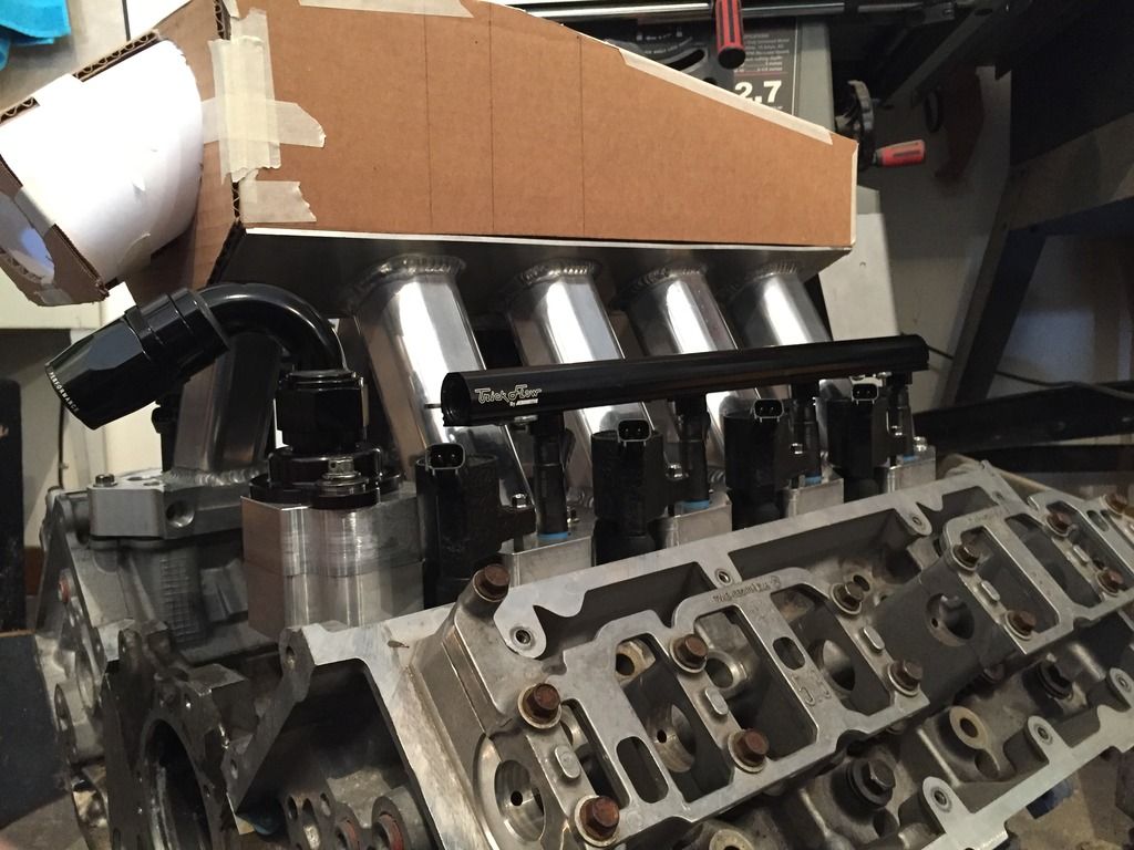

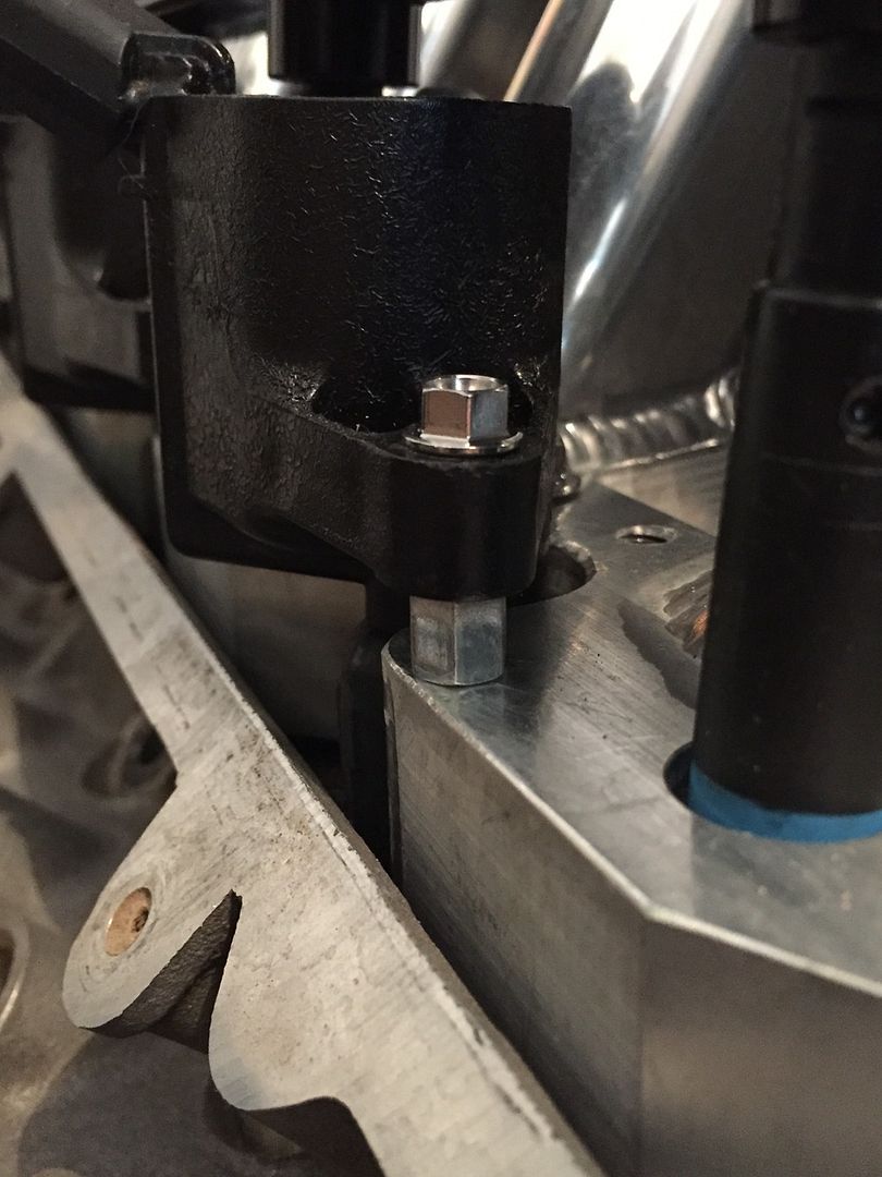

Fabbed some COP stands today for the intake. Bought some coupling nuts and drilled out the threads. I then cut them down to fit snuggly under the COP tab.

Don't think that cardboard and tape is gonna hold 20psi. .
You're right. Rated for 45psi.

So what's the total cost of this intake? If you don't mind me asking.

Well intake mock up is officially finished. Bringing the material and drawings to my fab guy this coming weekend.

Scott that's a really nice mock up. Your guy should have no problem making you something nice from that. My grandfather was always great at making mock ups and drawling up plans. He showed me how to do it when I was a kid. His projects always turned out great because of his meticulous preparation. I wish I had better welding skills and some metal working tools. I have limited fab experience but my last exhaust I did at home. It turned out nice considering I completed it without a welder and it was not prefabbed unit for my car. I used mac lt's cut before the ball flange to keep it a true 3" collector, custom 3" X-pipe I had made for my last set up unfortunately not mandrel bent pipe. Some summit mufflers that look like flowmaster knock offs. 3" tail pipes from the muffler back for a 94 5.0. It went over the axle fine but was a couple inches short. I used 3" to 4.5 clamp on dynamax tips with a rolled lip to bring it out passed the bumper. I had to cut off the hangers on the tail pipes since they were in the wrong place. Then using regular muffler clamps and some flat steel stock I was able to relocate the hangers to correct position like the stock exhaust. The other techs at work were surprised how well it turned out. Point being it feels good to fab or design something that works well yourself. I want to get a decent small welder and get better at welding. Plus some metal shaping and working tools and work on my fab skills. Building something with your own hands is very satisfying. I've considered going back to Wyotech and taking their chassis fab course.
What are you using for a TB? On my TFS I have the oval plenum and run an Accufab Single blade TB for the 98 Cobra. I had to make a cable bracket and use a cable for the 98 Cobra. I had to look forever find the cable. They sell 2 single blades one is a little smaller but I got larger one that was called the special single blade. With the 11.8:1 C/R how much timing can you run safely even with E85? What is a2w?
