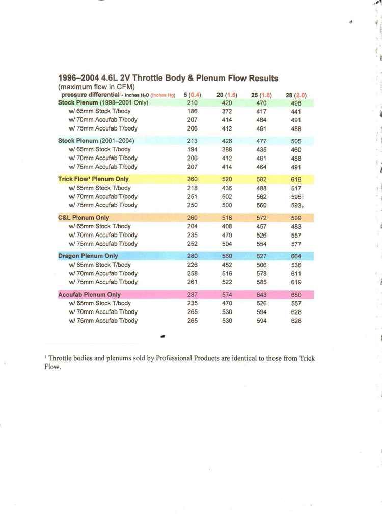

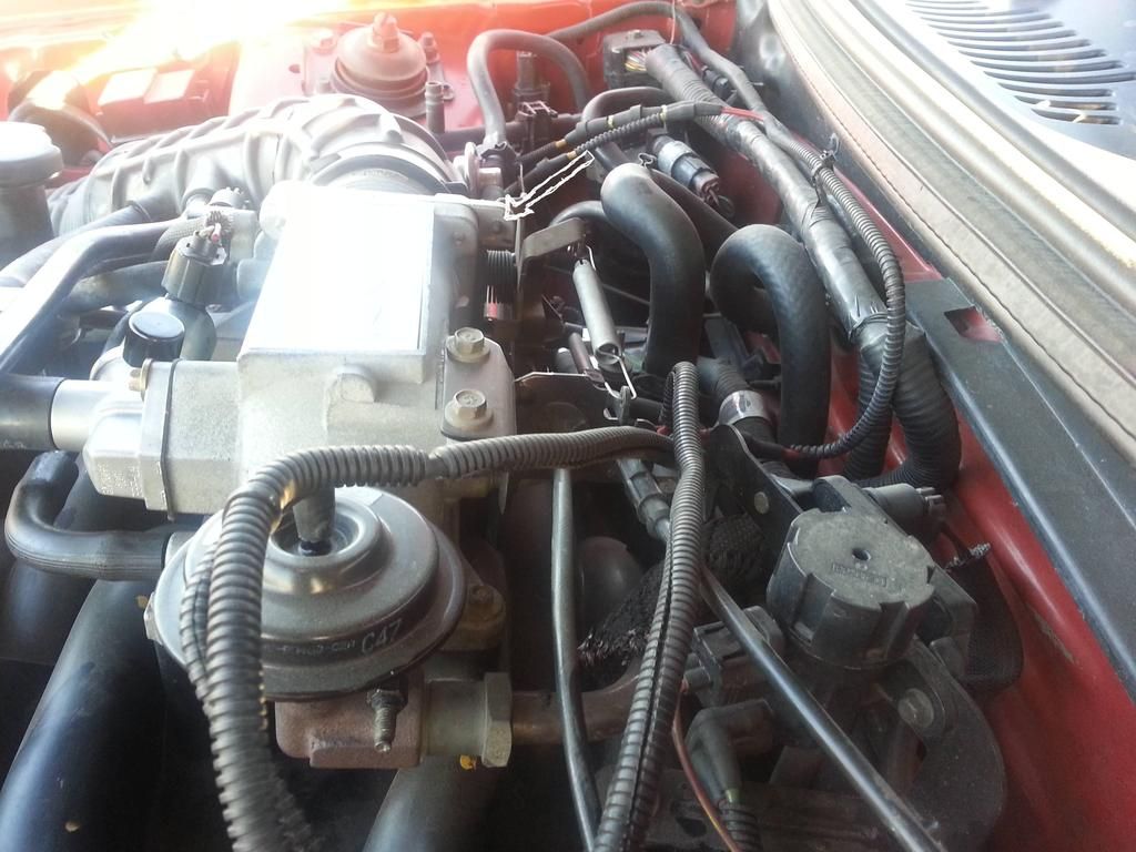

Originally Posted by Eagle2000GT View Post
The biggest restriction to air flow is the plenum not the TB. If you can afford to replace only one then replace the plenum. Here are the results of Accufab testing.
He's talking about the butterfly valve inside the throttle body. It controls the amount of air flowing into the motor. If it shuts too tight it will vacuum lock. That is when the engine's vacuum holds it closed causing the it to stick when accelerating from idle. If the butterfly valve shuts too tight it also cuts off the by-pass air that is needed for the IAC to work properly. This results in the engine surging and sometimes dying when slowing down and turning. On my car it did both.
The TB butterfly valve sometimes need to be adjusted even on stock TB because of wear on the stop screw. The stop screw controls the amount of by-pass air. It does not control the idle. From the driver's side fender turn the stop screw clockwise about 1/16 of a turn. If that doesn't fix the sticking or surging then do it again. If you actually do change the idle then you have gone too far. Experimenting on my car it too more than a full turn to affect the idle.
The arrow in the picture below shows the TB stop screw. Aftermarket TBs have a screw driver slot, stock TBs do not so you need to use locking pliers to turn it.
CliffyK explains air flow and TB adjustments in more detail on his PaladinMicro site:
PaladinMicro

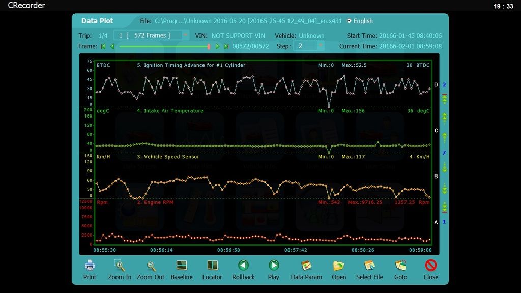

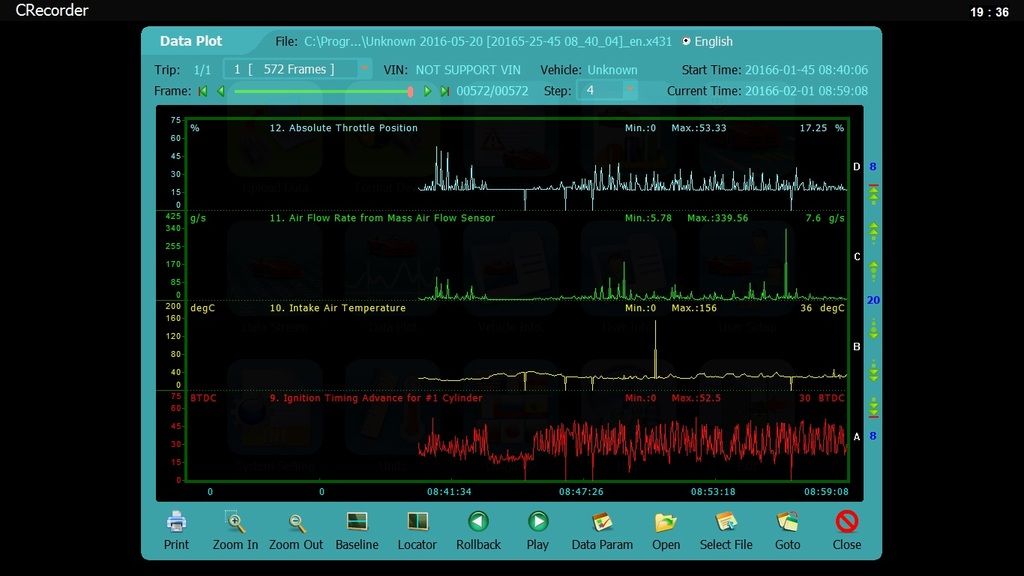

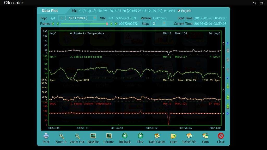

Thanks Eagle. I have re adjusted mine. I set it so that there was 0.010" of an inch away from the throttle and the adjustment screw. Then turned it one full turn.
I've always played with it just to experiment and nothing changes.
I've been through 3 IAC's, and I'm using a brand new motorcraft one currently and I'm still having trouble with keeping it at idle. I've checked for vacuum leaks, I've checked the IAC, 7 ohms of resistance, and the harness is getting 12V with the key on.
Here are some quick data logs. First picture was on its own, last two are from the same log. Looks like the car literally shuts off when I'm at an idle.
Any ideas on whats going on? I can't get my blower on till I get this figured out.
Sorry, I can't read data logs. I'm more of a shade tree mechanic. If I had done all of that I would then intentionalyl open the stop screw enough to change the idle taking the IAC totally out of the picture. If it still surges at idle then its not related to the IAC. If it stops then I would back it off until it started again then turn the screw 1/16" clockwise to stop it.
I've actually had the IAC unplugged and opened the throttle body up with the screw once the engine was warm and it ran amazing. So I guess I just had back luck and got a third bad IAC in a row?
Or else you are adjusting the butterfly valve too tight. Cliff was an engineer. He believed in precise measurements. I'm a shade tree mechanic. I believe in what works.
P.S. I had a truck break down out of town. I took it to a dealership. They changed a lot of thing and charged me over $1,000 but didn't fix it. Their computer couldn't tell them what was wrong. My hometown mechanic fixed it in a day for a couple of hundred. He could trouble shoot without computers.
