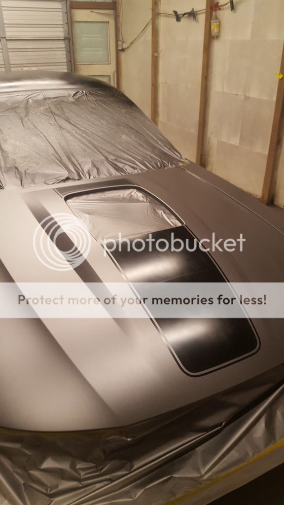

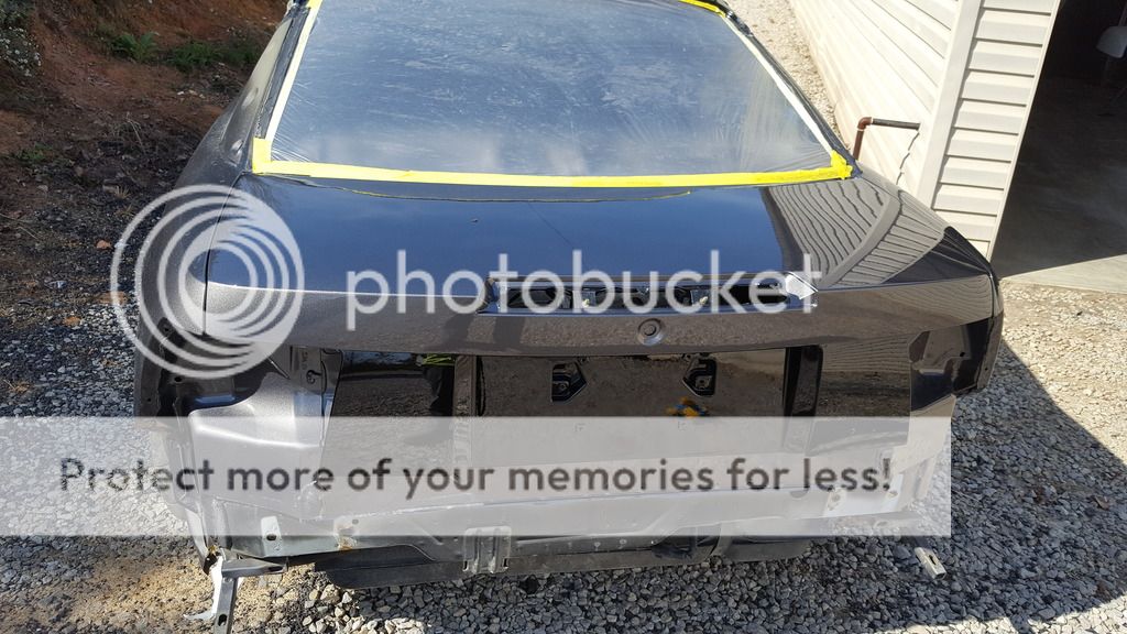

Got the body work finished up and sprayed the car tonight. Turned out great. Still have to paint the decklid which still needs blocked after I filled the holes from the spoiler. Also painting the roof black and respray the hood. Now for a few pics.
Time to make it shine!!
The car should be finished up sometime next week. Taking a trip to Gatlinburg TN this weekend otherwise it would have been finished this weekend.

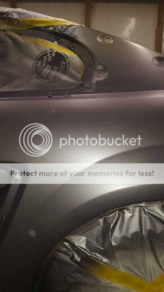

Thanks man, Panel painting didn't work out to well. Doesn't match to my liking. I expecting it to not match to well when I was mixing the color, DSG has alot of pearl and metallics from the silver. So ill be painting the car all over since I'll have to blend the the fenders and doors. I'll spray a couple coats of base on everything come Monday and then get the car put back together as quick as I can.

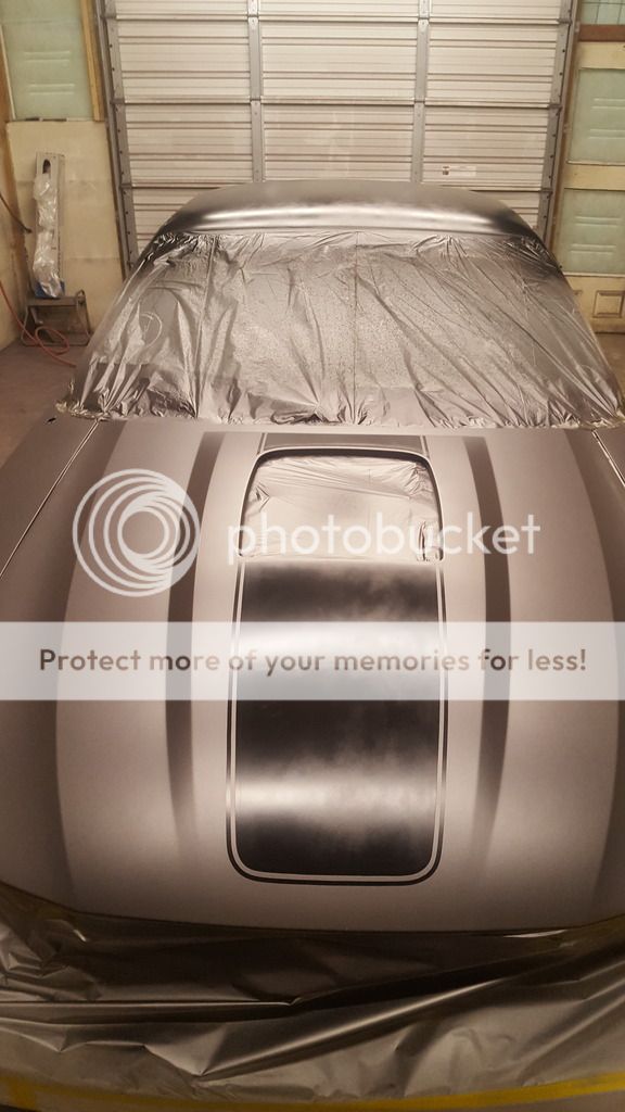

Just got the black sprayed on the roof, decklid, and hood. Gonna give it some dry time then mask off the mach 1 stripe and the decklid panel. Looking like it's gonna be a late night.

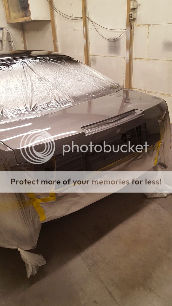

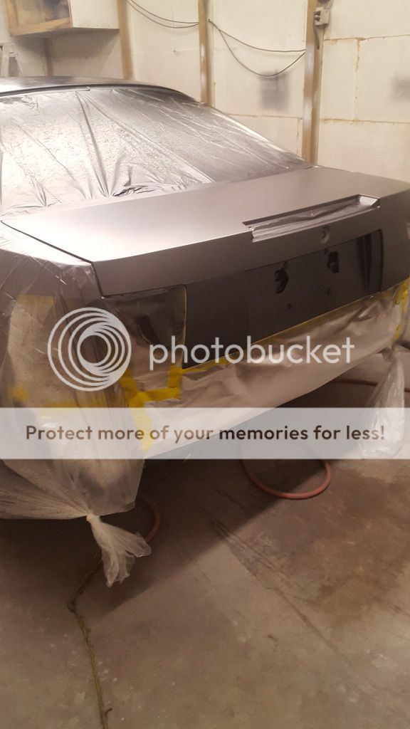

Can is painted. All that's left is my 01 front bumper and my new rear bumper. Finally starting to see the end. Car turned out great, I'm really pleased with it.

Did you do that yourself? Looks very good!

Yes sir, It's what I do for a living.
