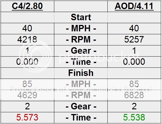

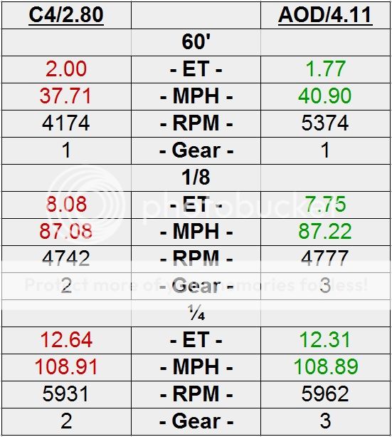

I decided to run my math again with my own 66 Mustang and its 289. I've been debating back and forth about whether or not to keep the C4 and stock 2.80 gear it has now or swap in an AOD with a 4.11 gear. It kinda shocked me how little the difference is between them.
From a dead stop, 4k stall converter in both.
Big advantage to the 60ft of .23 seconds for the AOD, but then look at the 1/8 and 1/4. That advantage doesn't carry out. The 1/8 advantage is .33 seconds and 1/4 is the same .33 seconds. The C4 with the 2.80 gear stays in 2nd gear the entire way from about the 330ft onward.
From a 40-85 roll.
A difference of just .035 seconds. Not even half of 1 tenth of a second difference in a roll race.
Both of these cars would cruise right at 2600rpm @ 70mph. Well... the AOD would in lockout. The C4 with a 10" 4k stall would have about 10% converter slip cruising down the highway so it would be more like 2860rpm.
From a 40-85 roll.

3 tenths seems like a pretty good difference to me in the 1/4. But if the cost is huge maybe not.
For the extra $1k, I could upgrade the doors, hood, and trunk lid to all fiberglass. (gotta replace them anyway) Or I could put that $1k into a FiTech EFI system. Just better uses for the money than gaining 3 tenths in the 1/4 when the car will be 90% street driven.
