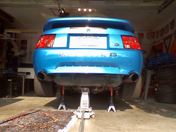

Here's the car jacked up and ready to go. I would highly recommend using jack stands for this operation, as you'll need quite a bit of space to drop the tank. A lift would be even better, but I haven't quite installed that in my garage yet.

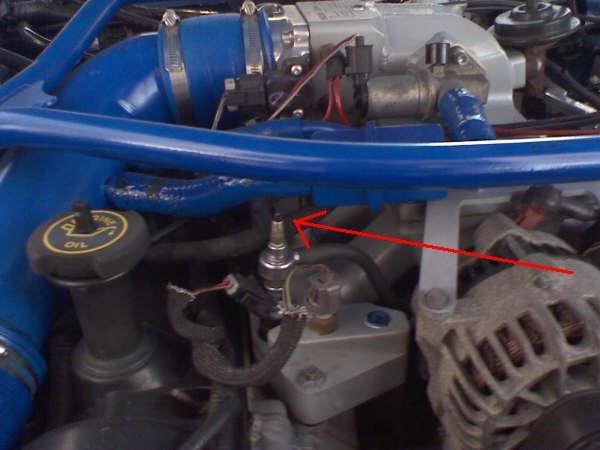

You'll need to do a few things first before dropping the tank. I read online that its always a good idea to disconnect the fuel cutoff switch, so I did that. It's located in the trunk.
Disconnect the battery for sure. Don't want power running to anything. Then make sure you bleed off the fuel pressure in the engine compartment from the fuel rail:

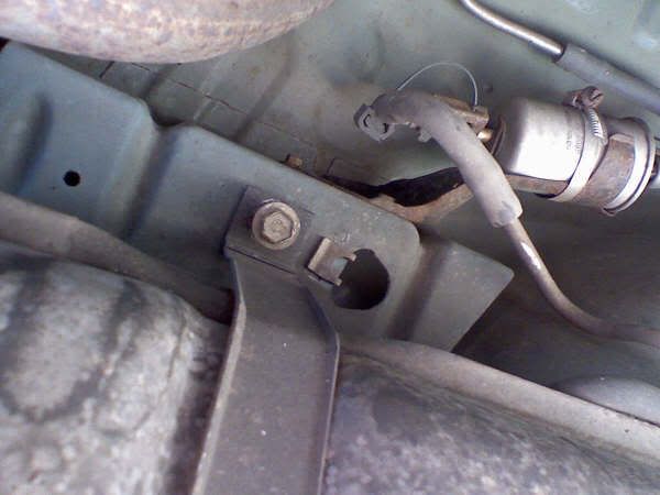

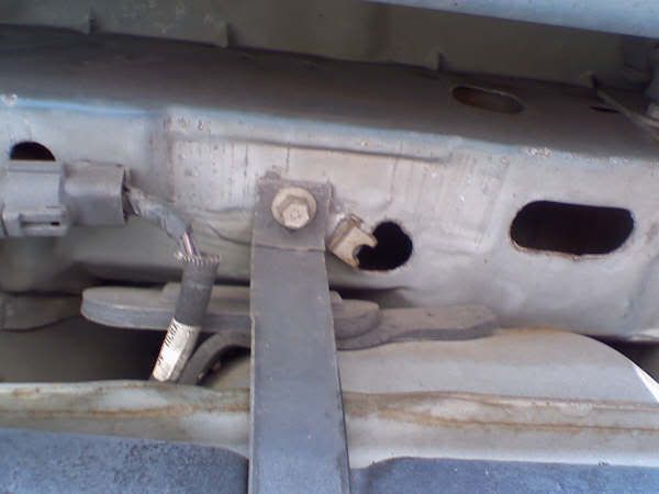

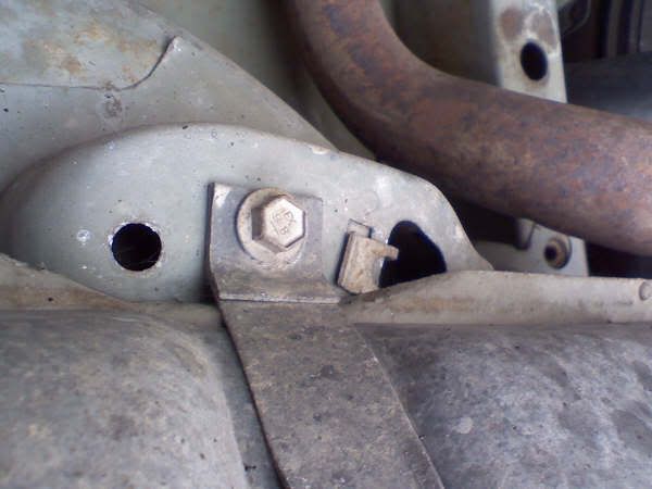

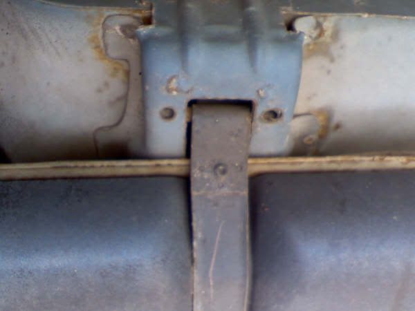

After that, you'll need to remove three bolts in order to lower the tank. There are two metal straps that hold the tank up; one comes off completely (right side looking at the back of the car) and the other has one bolt and swings freely from its other end (left side of the tank). Notice the fuel filter in the first picture, I'll touch on that in a little bit.
After you loosen and remove the three bolts, you should be able to lower the tank. Definitely have a jack or something underneath the tank to gently lower it down.

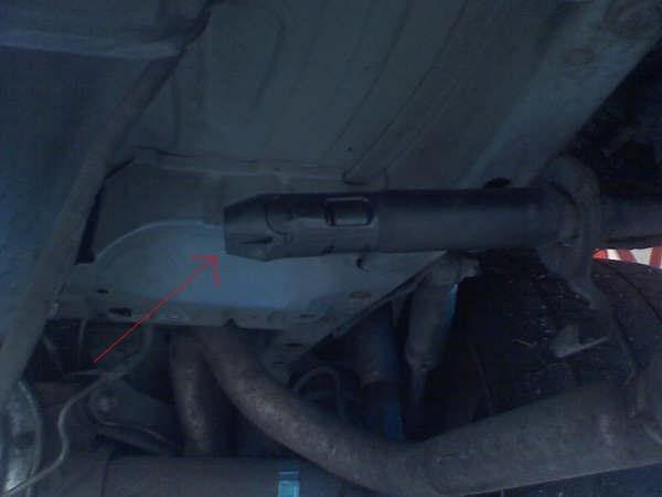

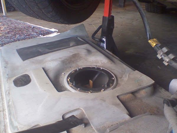

It's hard to get the filler neck completely out of the tank. You'll need to disconnect all lines before trying to pull it out. Here's the part where you'll need to run to Advance Auto or NAPA unless you were smart and read this all the way through before starting. You need a fuel line disconnect tool in order to get the line disconnected from the tank. MAKE SURE you don't try and use some other tool (i.e. screwdriver and a hammer) to try and disconnect it; you might end up having to replace the fuel line. I believe the line is 5/16"; buy the right size tool accordingly. It was about $6 at Advance Auto for me.
There are a few other hoses you'll need to disconnect, notably up by the filler neck near the location of the gas cap. You don't have to disconnect everything; just enough so that you can set the tank on the floor. Once you're able to do that, I removed the fuel pump because half of the gasket had dropped inside of the tank. It was pretty hard to fish it out of there but definitely something you don't want to leave in there.

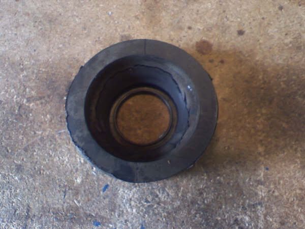

Here's the end of the filler neck once the tank was dropped. On the end of it there is a little plastic piece that clips onto it; I found it inside the tank. It might come off when you pull the tank out, make sure you look inside the tank and clip it back on.
Here's what the old gasket looked like:

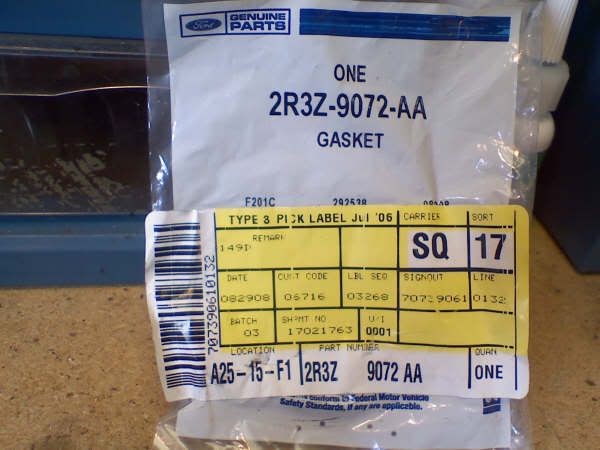

Here's the part number of the gasket. If you don't remember to bring it to the Ford dealership they should still be able to hook you up as long as you tell them what you need.

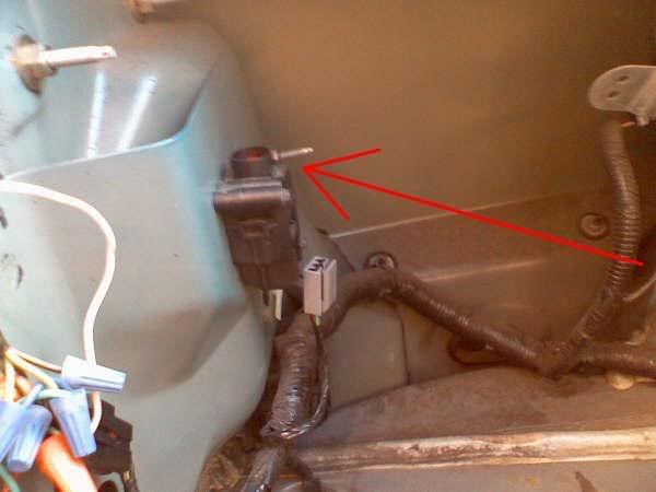

Additional Pics
Here's an additional pic of the filler neck partially inside the tank, this is where I was still disconnecting lines in order to get enough wiggle room to get the tank to pull out all the way. If you look behind the filler neck tube you can see the two other lines you need to disconnect from the gas cap feed. Also shows one half of the old gasket loosely hanging there.
