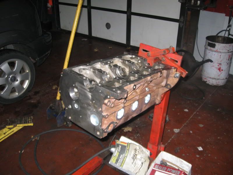

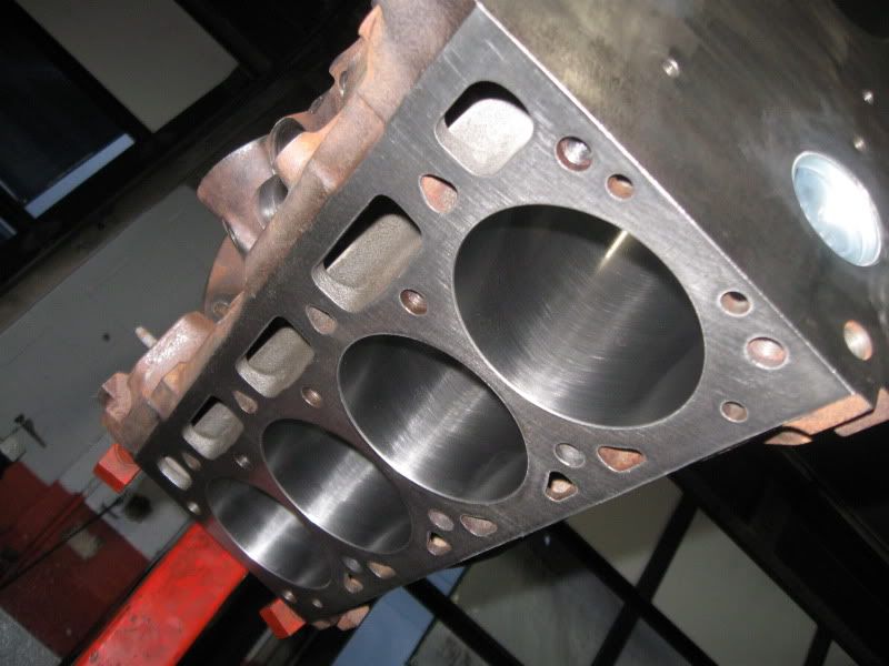

Now, as of today, 10/23/09, i got the block back from the machine shop...
Its bored .030" over, cleaned, new cam bearings, new freeze plugs, and polished the crank.
Now i just need to get my bearings for the crank and rods, .030 over pistons and the Lunati cam at my buddies house. i'll post pics of the cam later this weekend. The rest of the engine has to wait to be built untill i get the original engine out of the car. the one i'm building i got from a friend out of a 92 parts car, and it was just the block, crank and connecting rods w/ a burt up piston.

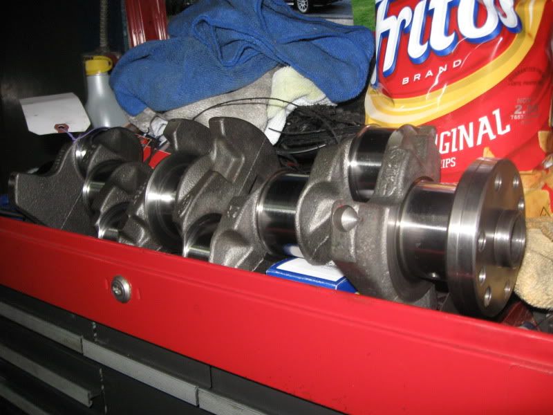

The final product...
2.3 bored .030" over, Lunati cam, 1.7:1 rockers, shaved head, grind out combustion chamber on the head, port and polish, header, 7lb flywheel, 5 speed swap, Contour SVT front and rear disc brakes, Moog control arms with poly bushings, rear sway bar, Mustang cobra R rims, black w/ machined lip, grey interior with red piping on the seats, Tuxedo black paint with candy red met w/tint stripe around the car. sounds plain and simple and not too exciting, but watch the build and hopefully you guys like it as much as i will.

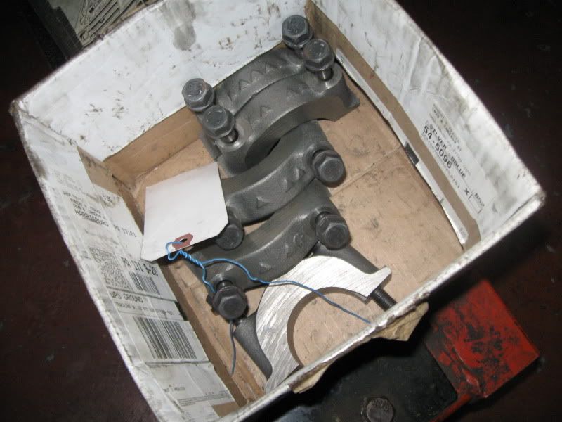

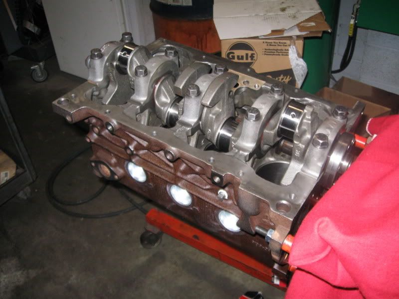

so far, have the crank and cam in, waiting on pistons, then have to take the connecting rods and pistons to the machine shop to press the piston pin in.
