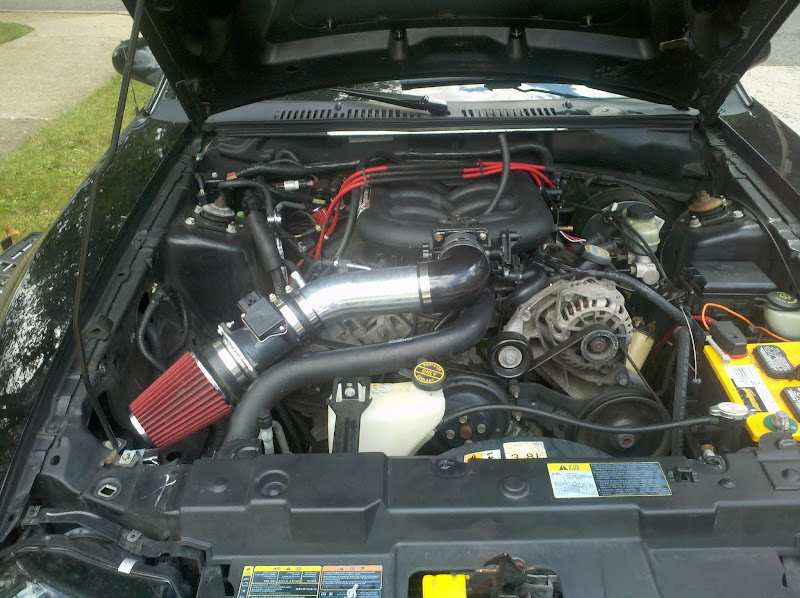

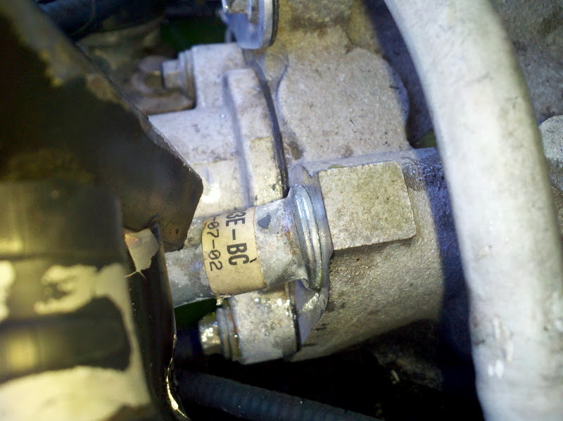

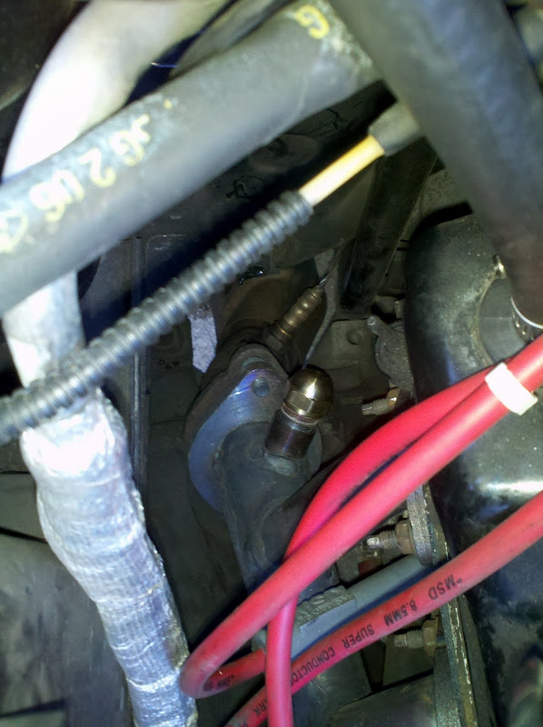

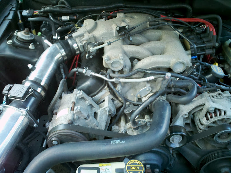

So today I decided to give it a go on the EGR and delete it in preparation for the Windstar...
It wasn't as bad as I thought it was going to be.
First list of things you're going to need:
8mm wrench
10mm wrench
Adjustable Pipe Wrench
EGR delete Plate (got mine through a member on here, but if you have the tools I can't imagine it would be difficult to fashion yourself one.)
5/8 flare brass cap Here
2x 6.0mm 1.0 thread 16mm depth screws
3/16 rubber cap Here
EGR Suppression Tune
I started by disconnecting all of the electrical connectors to the EGR components, as well as, the vaccuum line to the intake. Fairly simple enough. There's only one so disconnected both ends. The next step I took was to disconnect the brass pipe from the EGR solenoid (looks like a flying saucer, idk if it's even called solenoid). For this I used the adjustable pipe wrench to grab it and just loosen it up and pop it out.
At this point I was left withe the UFO attached to the bracket, I chose to remove them separately but you can try removing them together. The screw sizes are UFO to Bracket 10mm, Bracket to Intake 8mm. The location where the bracket grabs the intake is where the egr plate will go. I pulled off the bracket and at this point I was just left with the pipe connected to the passenger's side header. When you put the EGR plate on here you need to use shorter screws (the 2x 16mm 6.0mm's you bought would be handy) because the EGR bracket fills out some of the space of the longer screws.
I removed my air intake at this point because my forearms are kinda bulky ( I never thought I'd regret working out) and I only have one elbow. After that was disconnected and out of the way, inspected where the pipe connected to the header. It's kind of deep and I figured I would need to use the pipe wrench although I can't imagine how I'd fit it down there. Luckily for me, not 2 months ago, I had my entire EGR tube replaced due to a crack. The numbskull mechanic who did it must've never tightened the EGR tube to the header because I was able to unscrew it with my fingers.
So anyway, I was left with this
Not too difficult to see down there. I used the 5/8 flare brass cap at this point and it felt like it fit pretty snug. One day, I'll probably go in and seal it off but for now it works. Also one thing to note! If you're hesitant about getting the 5/8" flare cap, the threading the part that connects the pipe to the UFO is the same as the threading on the header, so you can use that to test fit without disconnecting the header.
Finally, the engine bay I guess looks a little bit cleaner...
Before:
After:
To wrap it all up, the car is going to throw a code for EGR missing, so if you have a dedicated tuner, get them to throw on a EGR delete to the tune so you're not throwing codes.
All in all, this was more of a preparation for doing the windstar but I thought I would ive some people who are following this a quick run through of the EGR delete.
Also, dont blame me if you dont pass smog! I know Cali is bad with that.

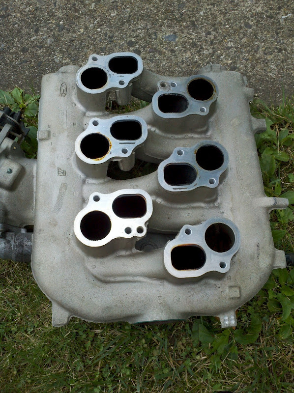

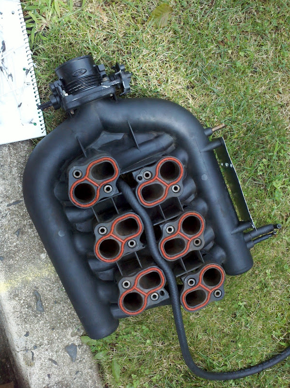

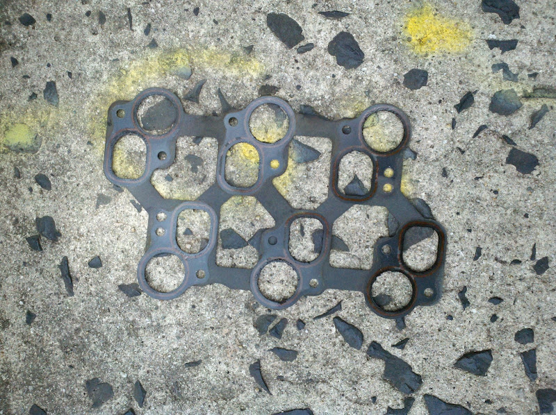

So today was day two grinding away and I finally completed the windstar swap.
Gonna try to keep this short and sweet but somewhat of a walkthrough for the folks.
Started by disconnecting the throttle cable from the throttlebody and bracket.

Next up was removing the coil pack from the intake along with all of the vaccuum hoses.
1 for the brake booster in the back, one for the PCV outlet, and one for the fuel line, I already deleted my EGR, otherwise that would be another one there. (blue cap)
After that, removed the CAI from the throttle body and all adjoining vaccuum hoses, (defroster under the throttle body), a small 1/4 line

At this point the intake should be ready to be pulled. I pulled out all 12 screws so anyone else trying would know where they were to target them.
The Intake popped right off
Several years of EGR on the lower.
Engine:
Gasket off:
And this is where the nightmare began...
So no matter what anyone says, there is absolutely no way the intake will fit without modifying the coolant line. I tried using a crowbar to pry the black part with the release down near the coolant tube but it was becoming rather difficult so I literally started smashing at it with a hammer. Well the car decided to puke coolant all over the place (I felt like wickedsnake) as the car was physical vomiting all over the street green shit.
Some how I got a hold of the situation and learned that this was here that the actual coolant was leaking from.
I know you guys don't like to use it but I just jb welded the damn thing shut and that was the end of it...
Using a dremel I got fancy with the bottom of the intake (saw this on another forum) and decided to snake a house under the housing (I didn't end up using this because the outlet was in the way of my bracket in the final stages of the swap.
Continue'd in next post

One thing to note, this is NOT the final version. Looking at the intake, you'll notice where the intake has the bump still from the stock IAC for the Windstar Throttle body. This part would NOT fit under my stock hood, so I used a hack saw and just leveled it off.
Crude but effective.
The rest is pretty much just putting the shit back together in the end.
