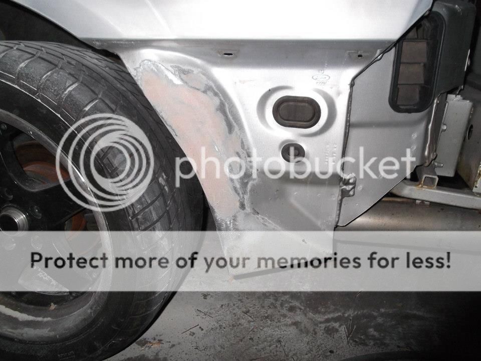

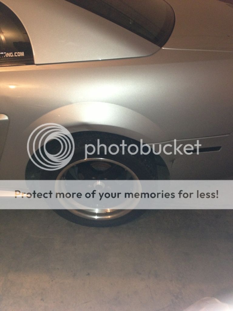

Some before pics
dent on the door
some punks shot my car with a bb gun
qp dent
I have all the paint i just need a compressor

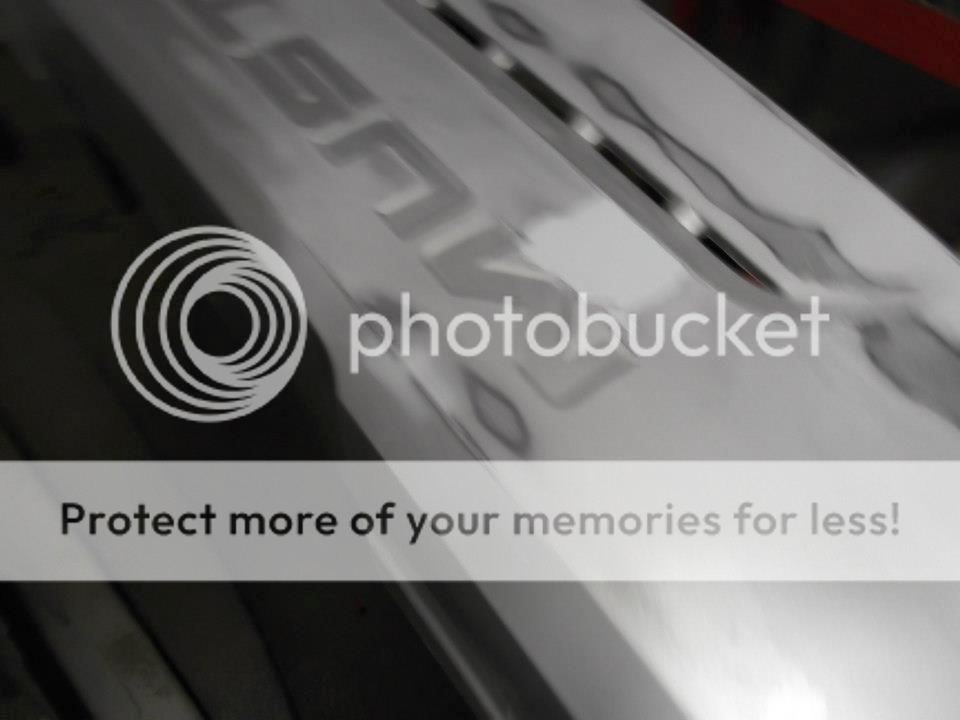

Finished the body work!!!!!!(well most of it anyways) I am pretty happy how the color blended, I forgot my camera with the durring pics at my dads but i have some after shots
Point out the flaw^^^

I did alot of the prep work i had a buddy that had a nice Gun shoot the base and clear id did the primer. First i beat the dents out with a weld stud slide hammer(dont know real name of tool lol) hammer, dolly, used some body filler, then sanded a few coats of primer few coats of base, n clear then wet sanded, then buffed the car. I am happy with how paint came out. Look at haynes manuals for some great body work tips

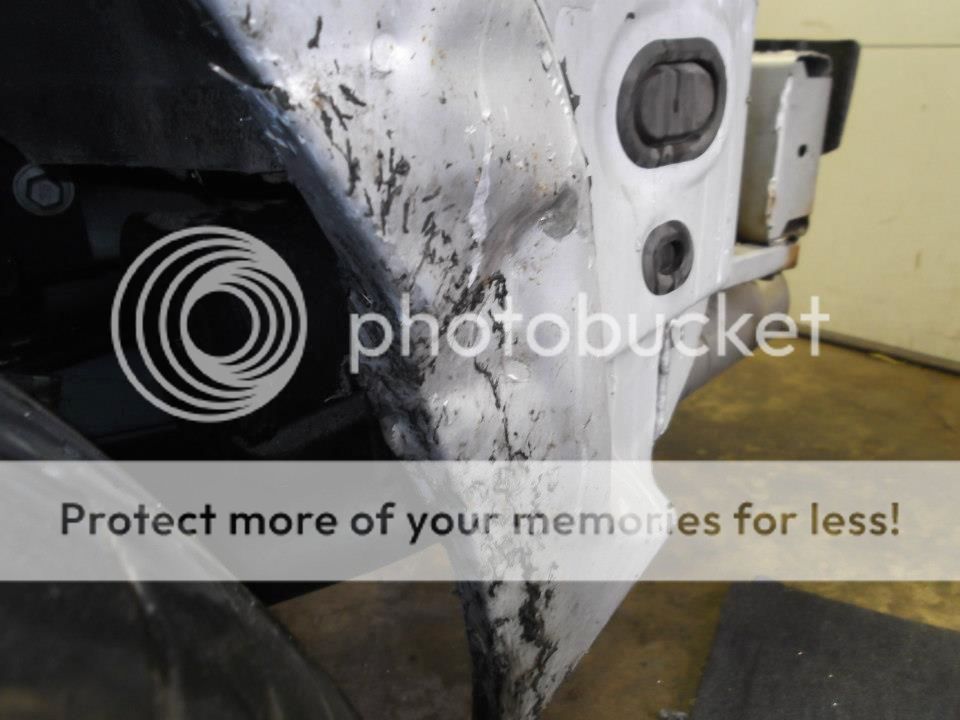

Got the durring pics (not in any order)
