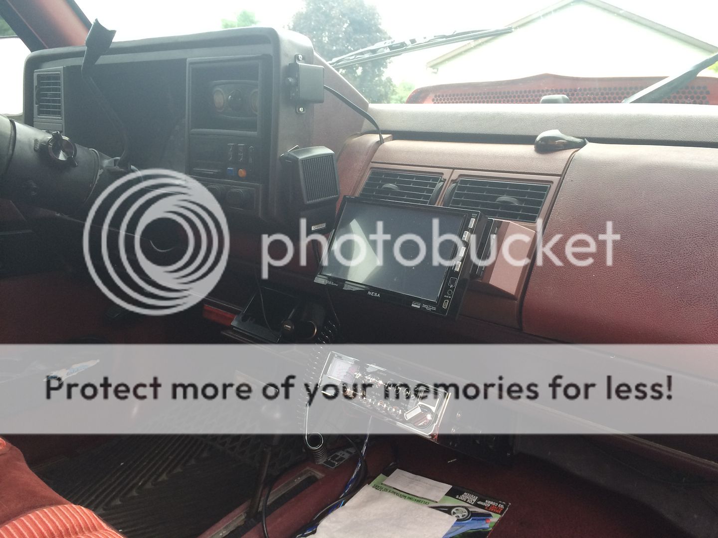

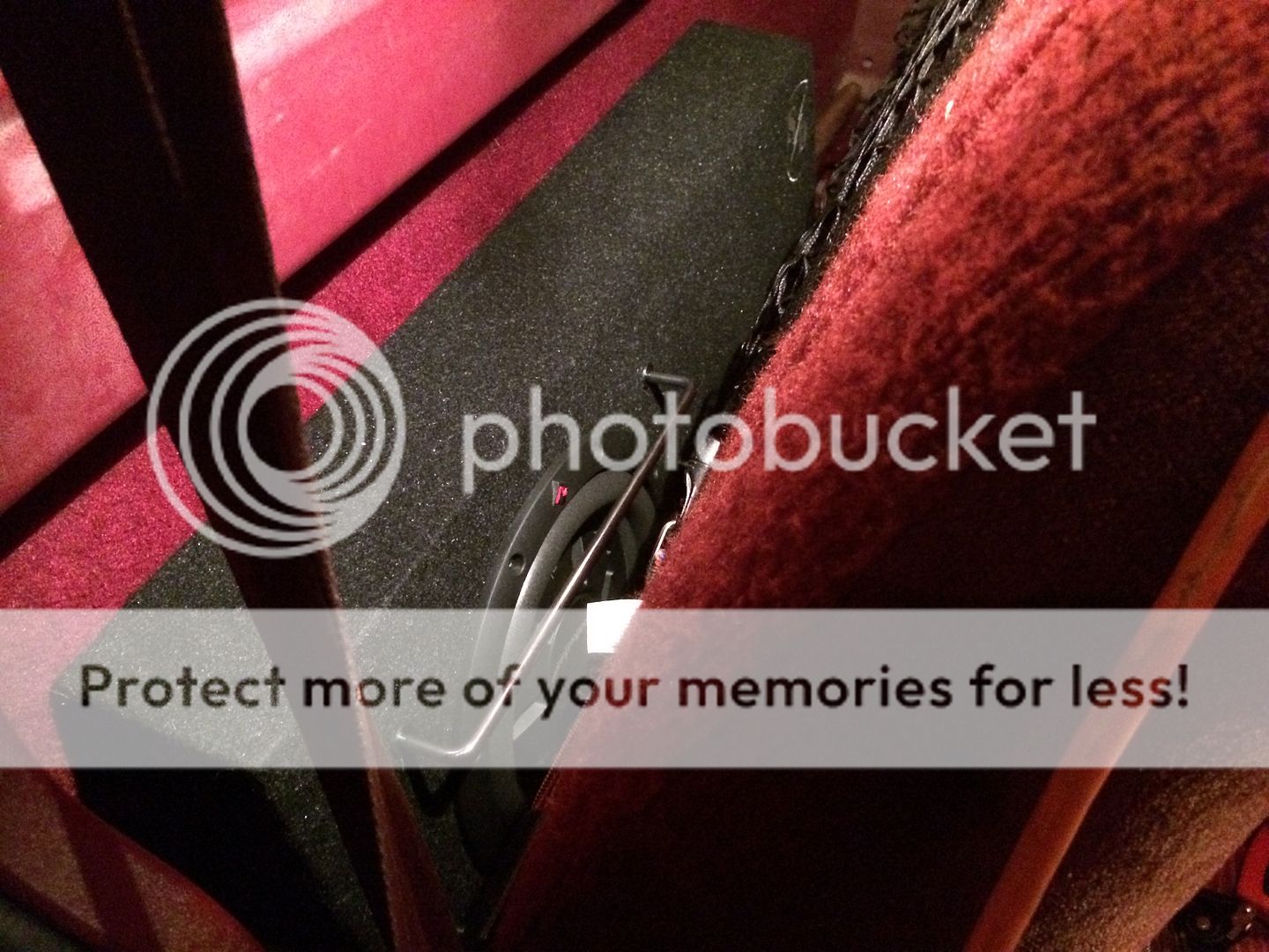

So far nothing much has changed with the truck. Did how ever just put a 10" Rockford Fosgate subwoofer with a Sound ordinance amp and box into the truck. I was surprised to how well the sub fits behind the seats even with them all the way back. Had to remove the tool box that sat behind the seat, but that wasnt a huge deal to me. Plus even being a low power sub (400 max rms), it kicks pretty good. Thats the benefit to having a single cab truck
the amp was awesome because it came with a remote bass gain knob and a free wiring kit.

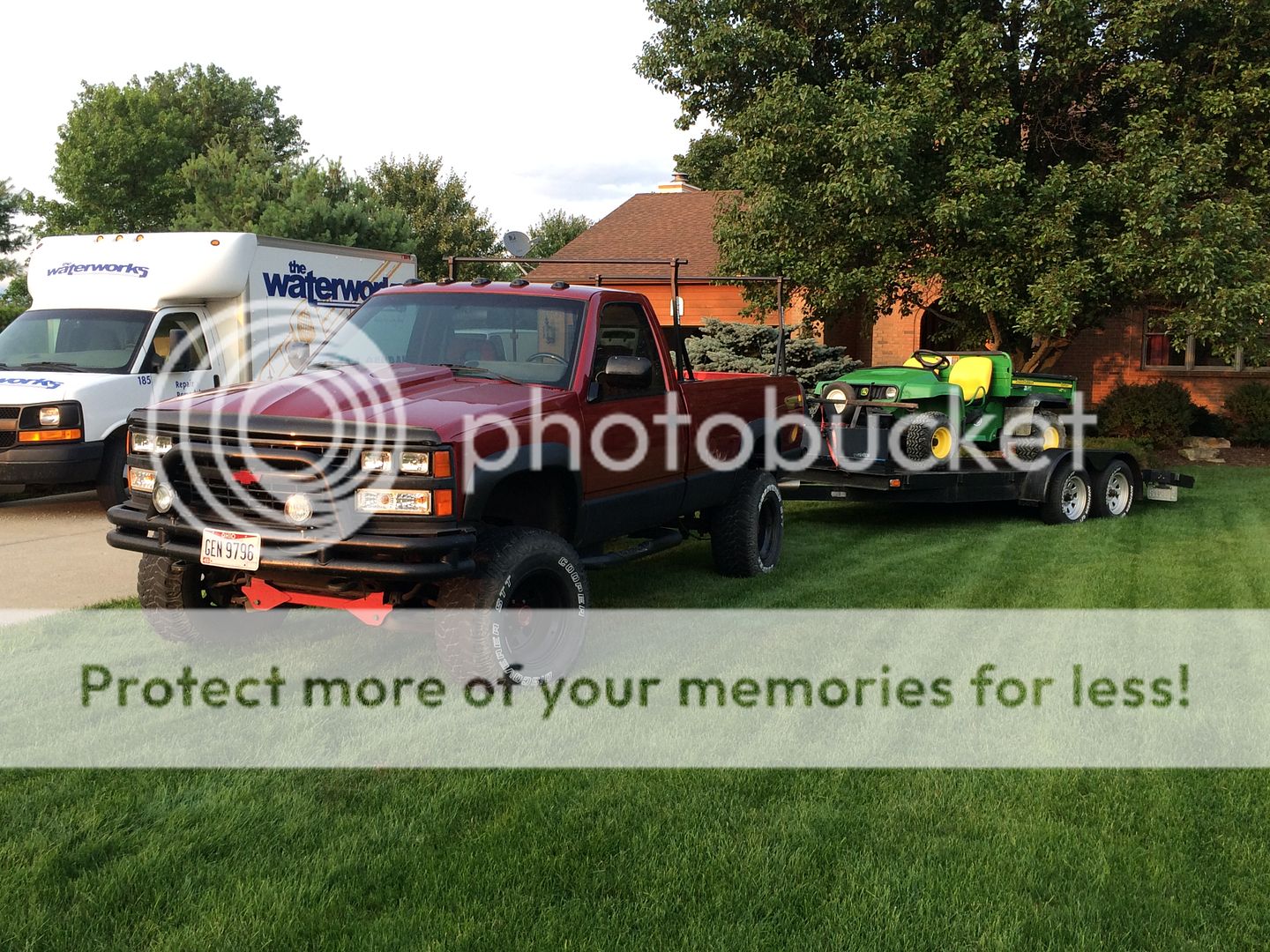

In other news. Hauled my first major load (lol) over the weekend. Had to haul at first a gator and a yard tractor. Big whoop I know. But fter that, I had 2 golf carts, a big ass inflatable bounce house, the garden trailer again, and around 400lbs of sand bags. Truck did well with it. she hates the slightest hill though and has to shift out of overdrive, but she did well.
first load
the heavy load
and now shes going to be getting ready for a trip to Tennessee next Wednesday. I have a feeling she'll make it no problem. Though the spark plugs and wires are due for a change any day now.

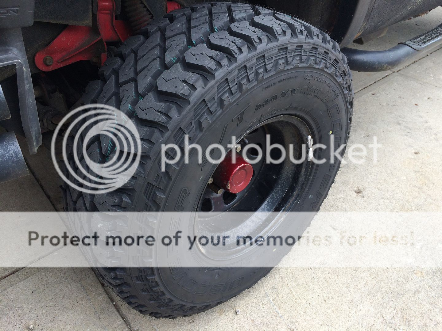

and now the biggest update.... Finally got some tires. $1300 later, Im now rolling on Cooper Discoverer ST Maxx 315/75/16.
holy shit what a world of a difference from my old bald tires. Those were 285/75/16 cooper discoverer STT. Over all the truck gained about 2.5 inches in height and looks a hell of a lot better. (will have a comparison of the new tires with the old side by side later. Currently they are strapped in the bed and Im lazy)

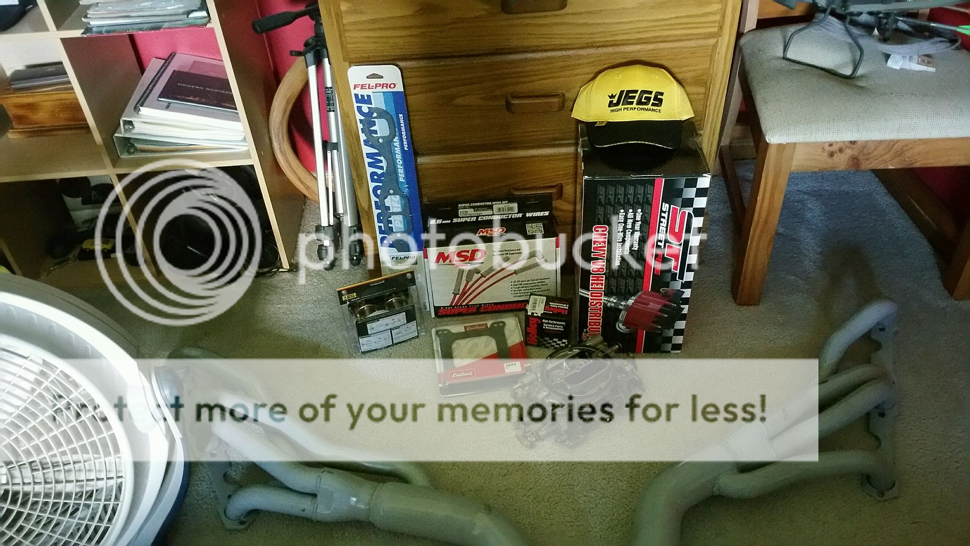

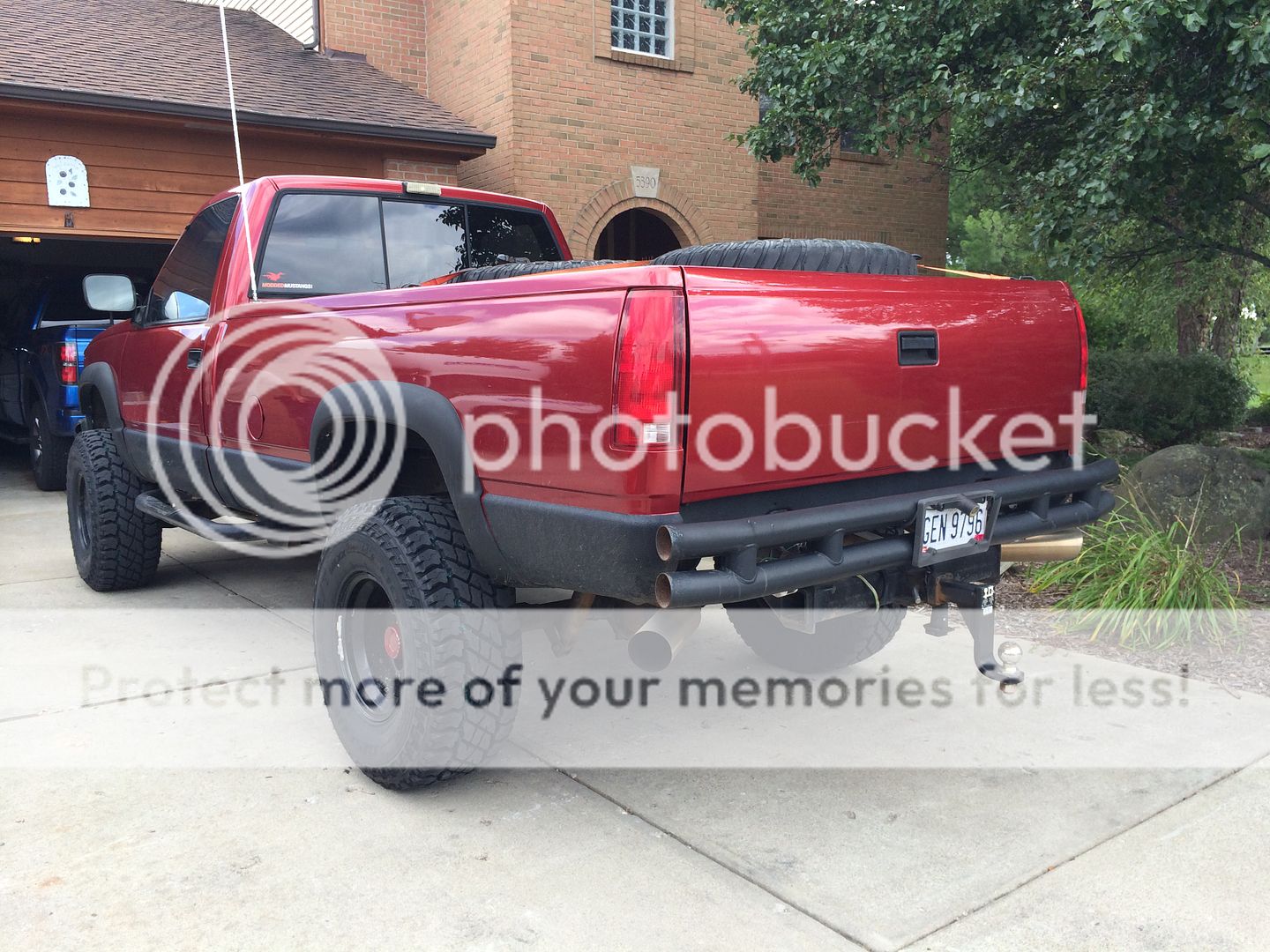

so itss been forever since Ive posted in here but I think its about time ssince the engine is about to get some work done finally!
so as an update picture, this is its most recent state.
anyways, the engine is about to get a small overhaul! Heres the goal!
Eldelebrock Intake
Eldelebrock 4bbl 650 CFM carburetor
MSD Distributer with MSD ignition system
Inline electric fuel pump
CompCam thumpr cam w/ springs, rods, rockers
all that should be happening with in the month. should hopefully wake the engine up a good amount.

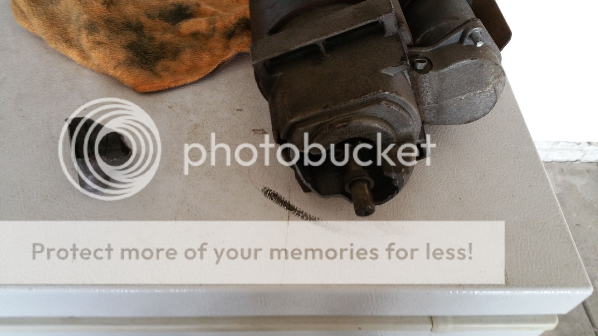

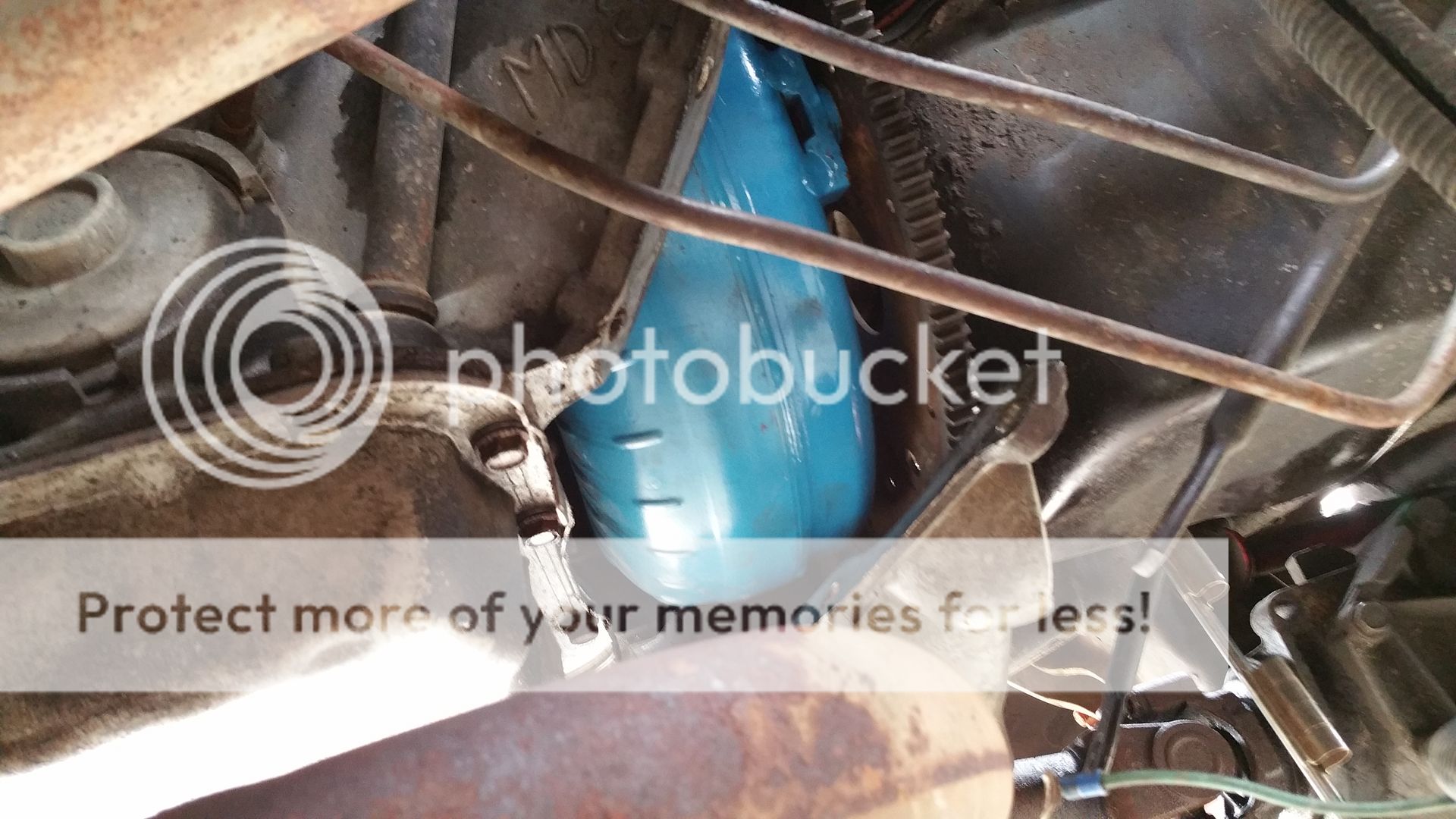

Went to go to the store with the truck. Came back out to start it and heard the infamous starter grind. Well at least it happened 2 miles from home. Called up my dad and had him pull me home.

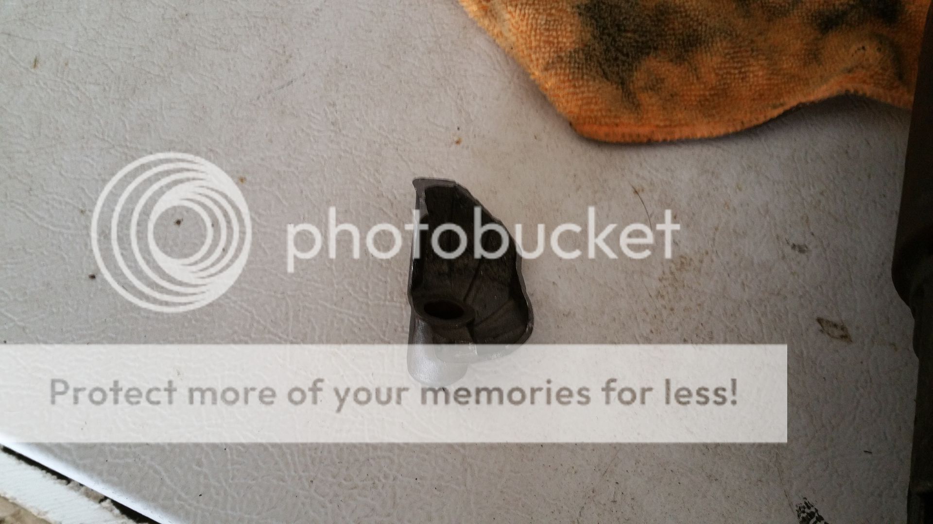

Took off the starter and saw this piece wedge in between the bell housing dust cover and the flywheel.
bought a new starter, put that in (fuckers are heavy) and all was well.

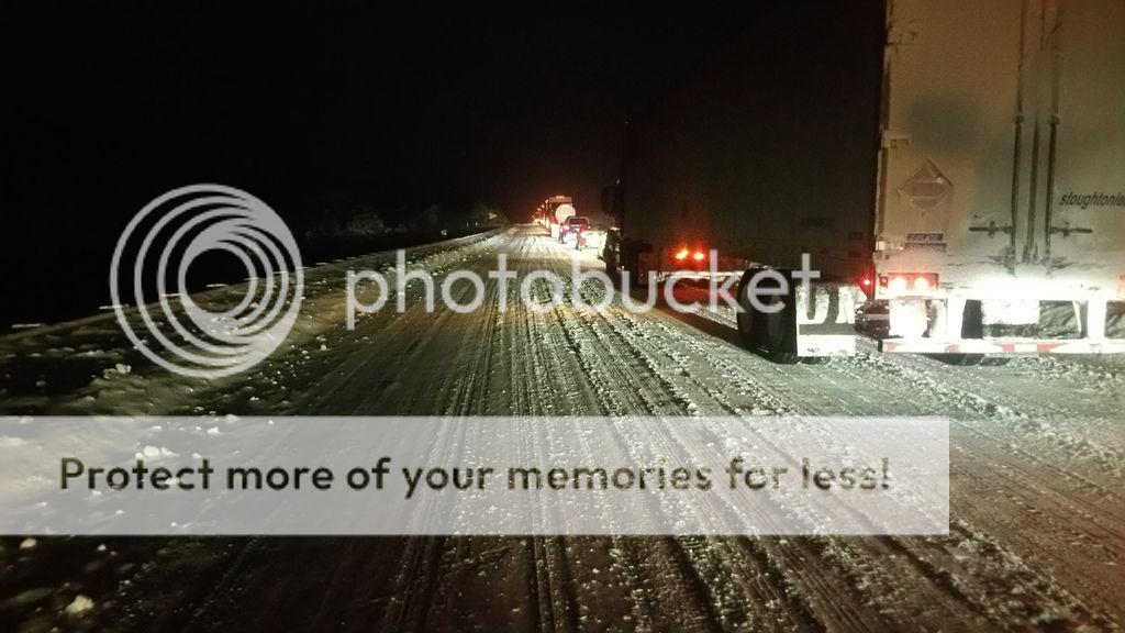

The date is January 22nd and I had planed a trip to Tennessee. Unfortunately, mother nature wanted to make that trip be as slow as possible. I departed ohio around 1pm and set south. Server snow was moving in and the worst was to hit in kentucky. About 65 miles from Lexington and the I71 / I75 interchange, the snow began to fall, and it fell hard. Ever mile progressively got worse. Eventualy I was going about 40 on the freeway avoiding snow patches while doing my best to stay in the narrow tracks where pavement could still be seen. I eventually pulled off to get fuel before I knew the worse would come. While filling up, I was interviewed by the local TV station as to why I was out. I literally told them because I was stupid, but wasnt going to let it stop me. No idea if I actually aired on TV or not but hey.

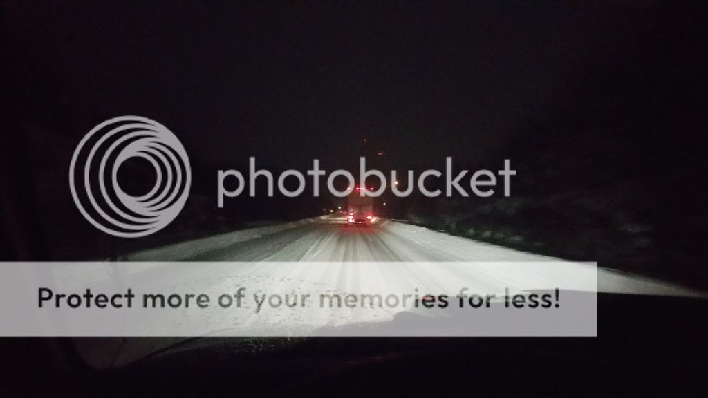

So I set back out and by now I have driven 20 miles in solid snow. There was no freeway. You made your own lane avoiding any massive snow drifts and clumps from vehicles. Several times the ass end would start to fish tail from no weight. I drove about 20 mph for about 2.5 hours before traffic started to stop around mile marker 65 on I75. I think I moved about 2 miles in that hour there. But I knew that as soon as that traffic stopped, I wasnt going anywhere for a while.
The whole time I was listening to the CB and found out that they had shut down the freeway due to many accidents. It was official that I was spending the night on the freeway. Good thing I got fuel!
20160122_164847_zpssnhts2df.mp4 Video by MachStyle | Photobucket

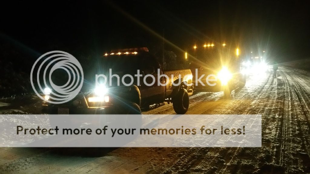

it was about 4pm when we stopped, and they did not get us moving till about 2am.
when 2am rolled around, they decided to take us down some back country road to bypass the freeway.
but go figure, that didnt last long. we made it 7 miles before a semi overturned, blocking the freeway. So there I sat from 3am till morning.
11am rolls around and finally I got word over the CB that the freeway had opened up back where they took us off. So I pulled a U turn and left all the truckers, to whom I made decent friends with at the time. I turned around and followed the roads in which we came in from. this is what I saw.
got to a gas station to fill up, and got on the freeway and continued south. All was smooth from there. The freeway was open and surprisingly empty.
so in that event, I left the truck running for heat for aprox 19 hours and burnt a half of tank of fuel. That day 22 inches of snow fell in about 5 hours with another 4 or 5 inches throughout the night. I was right in the worst of it.

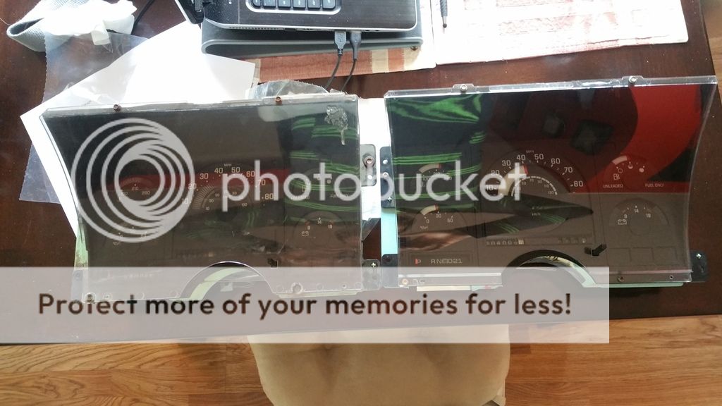

At this point, I owe my truck a lot for what we've been through. So recently I started freshing her up some more. This actually goes back to original problems I had back when I first got the truck.

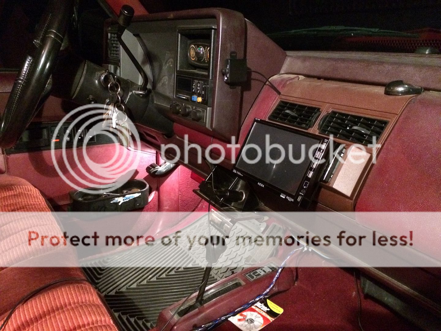

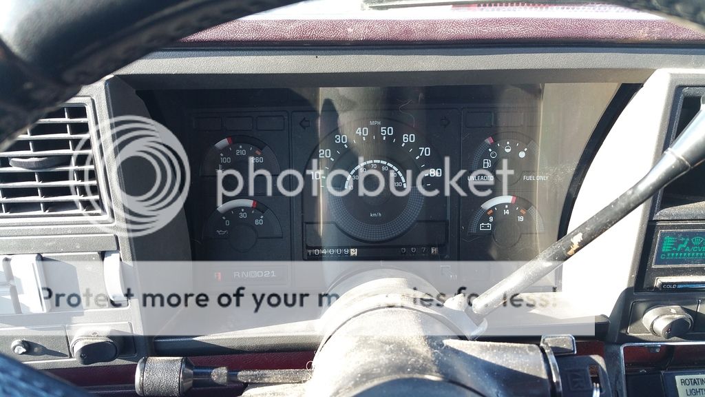

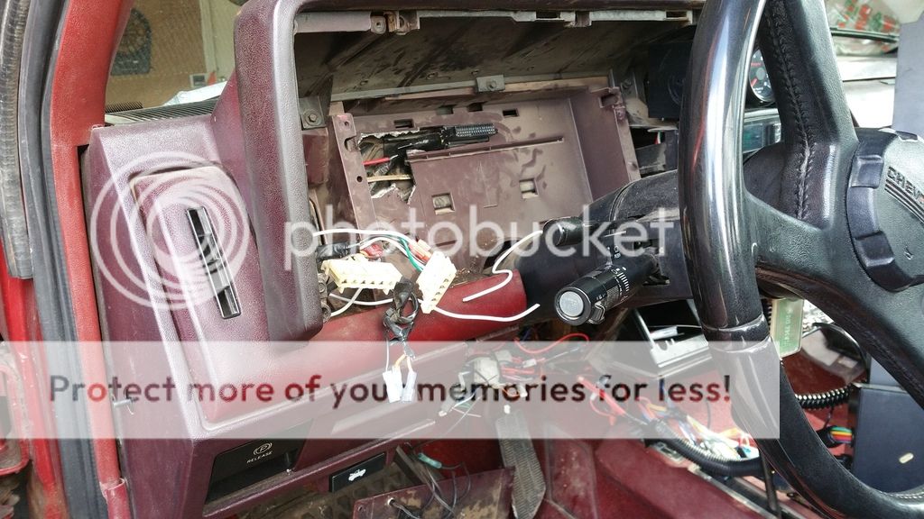

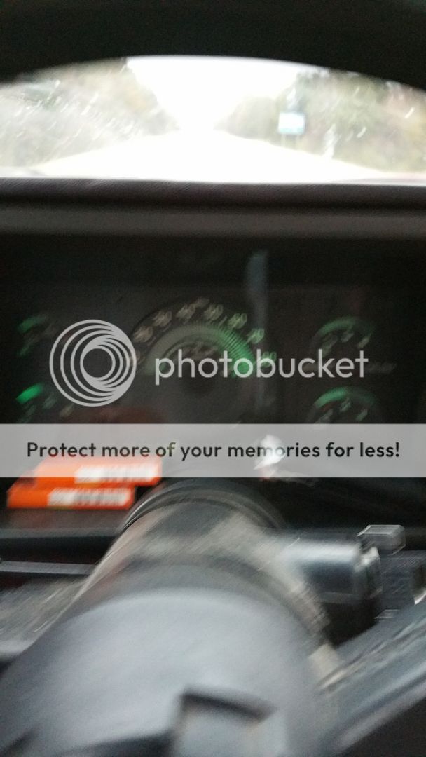

I finally got a new gauge cluster that looks a million times better than the old. Plus it had a working odometer! The guy I bought it from refurbished the gauges and could set the mileage to what ever I wanted. I bought the truck 2 years ago at 91K miles. So I figured I had around 104K now and had it set to that. Along side of getting a new gauge cluster, I replaced the HVAC control unit to something that works. I now know what the display says as the old one didnt work.

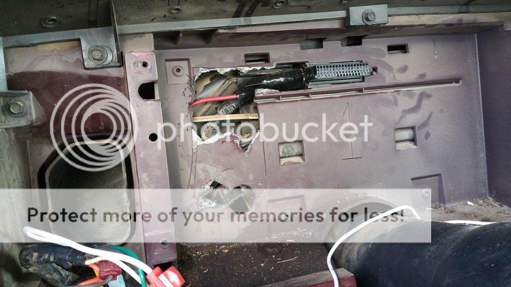

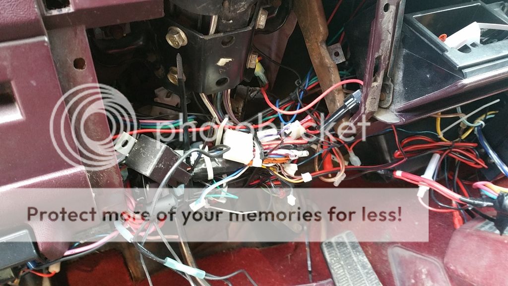

First lets admire the beautiful wiring job the previous owner left me again.
so now.. the new cluster next to the new one! Night and day difference!
So yay! New stuff!

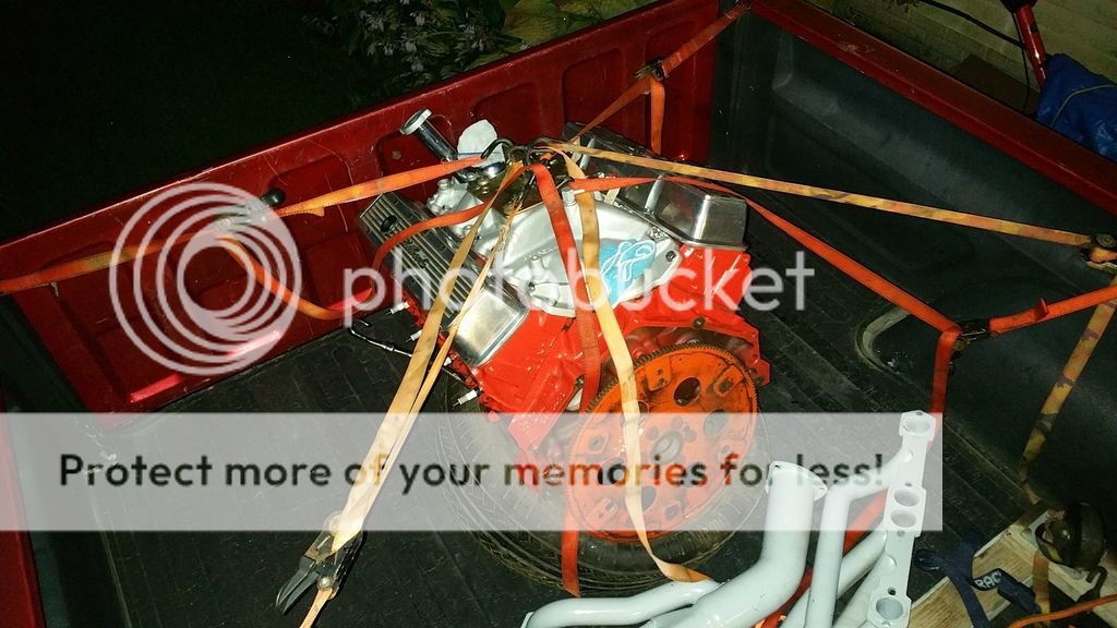

well considering I just picked up a 383 today...
Looks like very soon!
engine is a 78 block, 383 stroker
bored .030 over with 3.75 stroke
speed pro hypereutectic pistons with new rings
.488/.510 lift cam
new chrome oil pan,new chrome timing chain cover
new melling oil pump
new 1.5 ratio roller rockers
arp main cap studs
aluminum edelbrock intake with edelbrock 750cfm carb
10.0:1 compression.
what I need to get for the install
HEI Distributor
plug wires
holly fuel pressure bypass valve (to run the factory fuel pump with the carb)
maybe a better radiator or electric fan for cooling
random shit that im sure will turn up.

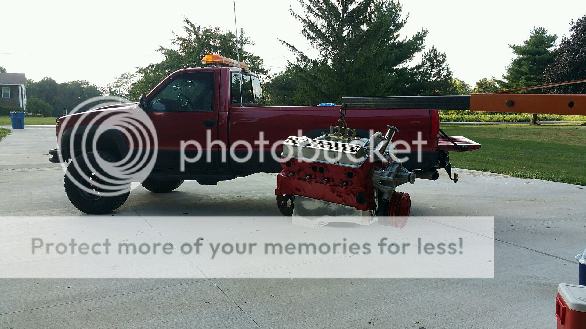

finaly got a engine hoist and stand and got the motor out of the back of the truck. I need to get a new cam and torque converter (already have one picked out - needed something a little more tame for the street) Gotta buy a few more gaskets and bolts but other than that, everything is here and I should be able to start tearing down and building up in the next few weeks when I become free
