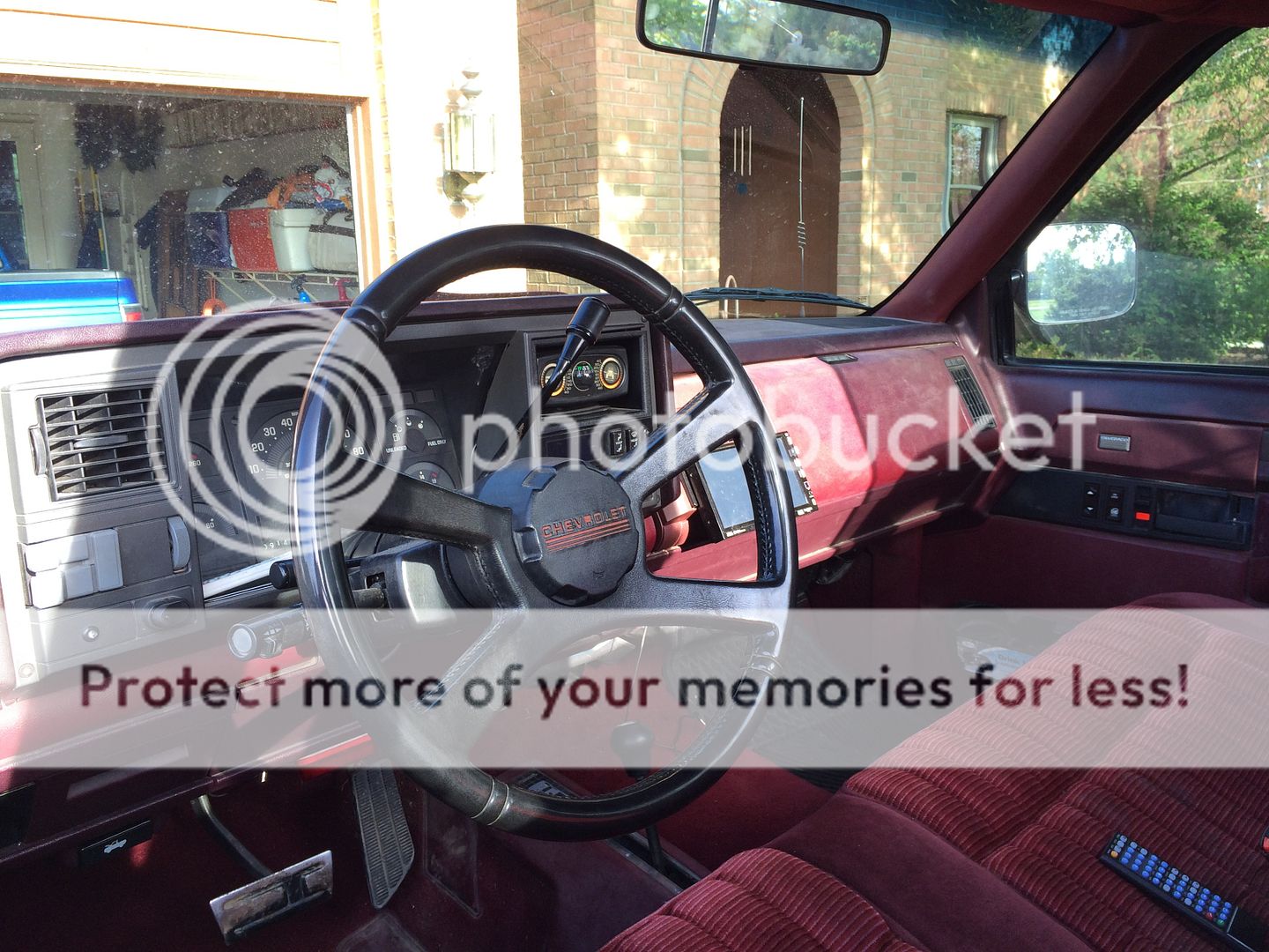

while the truck may look perfect on the out side, the inside shows its age. Glove box door broke its hing and needs new hinges. it closes, but falls off when opened
Driver side door handle broke off on the left side (uses a screw). temporally screwed it back in but will likely break off again
Trim parts are popping out on drivers door. could be glued back on buy will likely be replaces.
headliner is starting to sag in one spot. will be temporally glued.
Few dash pieces and other plastic spots on passenger door is broken. very minor. will replace if I see the parts
replace door pillar speakers as well as dash speakers. they work but sound like ass. Would like to also get a shallow sub woofer to squeeze behind the seat so that I get some form of bass. right now theres nothing. not even mids.

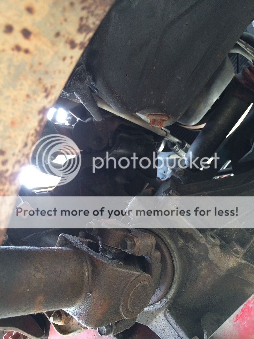

welp yesturday I attempted to fix the wipers. Turns out theres a bushing in between the motor and the transmission. that bushing is bad because I can move each wiper without turning the motor. so I go to take the wiper arms off to remove the wiper cowl and fix it, but the damn passenger wiper is stuck on the shaft part and would not budge. It probably didnt help that the hood cowl prevented me from being able to get the wiper to point all the way up to pull off.
Now I almost took off the hood, but in the end I knew that the wiper was still stuck on there, so I just gave up after an hour of sweating all over the truck. Took it into the shop this morning and will hopefully have it back at the end of the day. I hate that I had to do that for a $4 part that I could have fixed my self. Fuckin wipers lol
-Rocco

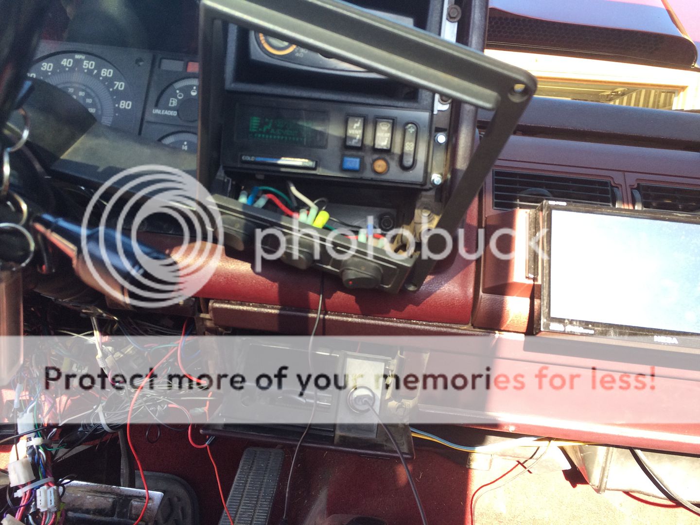

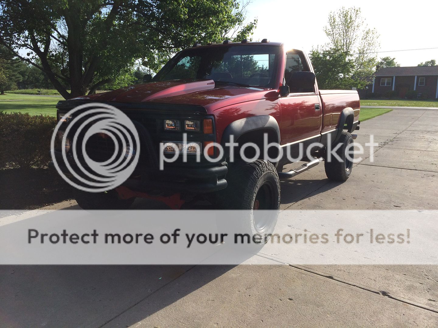

made some heavy and successful progress on the wiring today! ended up getting all the lights working once again!
started with the roof lights. found a mysterious red wire hanging from the lower power box and wondered what it was from. dug through the driver side door A pillar and found the wire running down. traced it to its end and it looks like it was knocked from its fuse. plugged it in and the lights worked! only issue was that it was on with the truck off. that spot it was plugged into had constant power. I then ran it to the gauge fuse in the fuse panel. sooo they are always on when the truck is on, but no big. Didn't fell like finding more wire to run it to the headlight switch.
next I began to tackle the rest of the stuff. Move the power wires that was connected to the battery to a better terminal (I they were poorly connected to the side terminal. moved it to the spare top terminal). I then replaced the fog light relay. I found using a tester that the remote switch wire was not sending power to the relay. So I checked the switch in the cab. That is not getting power, but all is plugged in. So here's where the fun came in...
The amound of wires running under the dash could probably stretch a mile or two down the road, and here it is all in one spot and of many different colors. I pulled, traced, and followed the wires from the switch only to finally find where they were cut. Wired it all back together to another fuse in the fuse box and suddenly, the switches had power! walked around front and saw the HID Fogs were lit! went to check the rear, but saw that the AUX reverse lights were still dead.
so off to this. ran the tester and saw that the lights was getting power, So I had to assume that it was a ground issue. And sure enough it was. on of the grounds became very rusted. cleaned it up and viola! it works! except one of the lights is burnt out. oh well no big. One is better than none!
Over all, 3 or so hours of bending like a snake under the dash was lead to good, happy results. I mean look at this mess!
but alas! It all works now. have some shitty night time pictures. at least you can see sorta how bright they are.

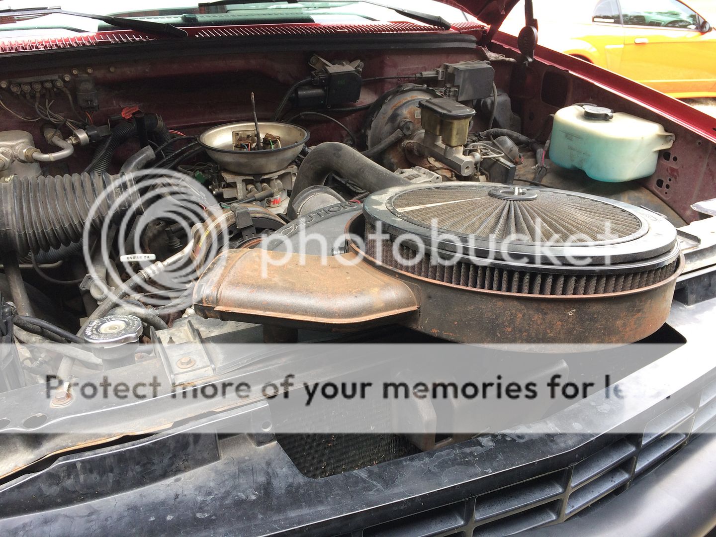

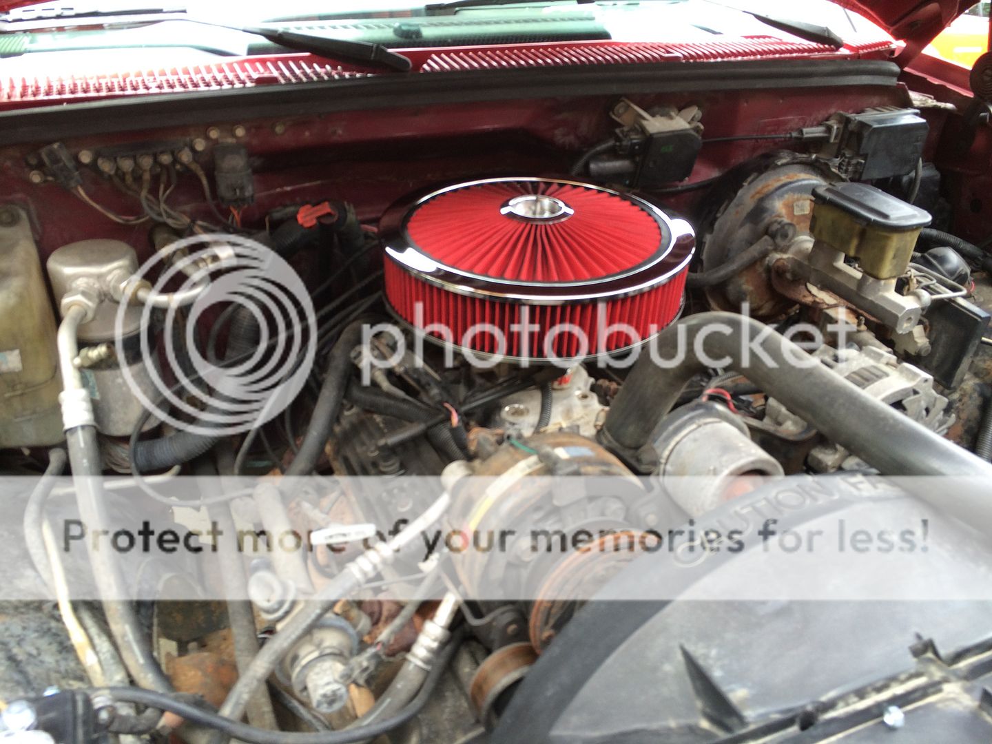

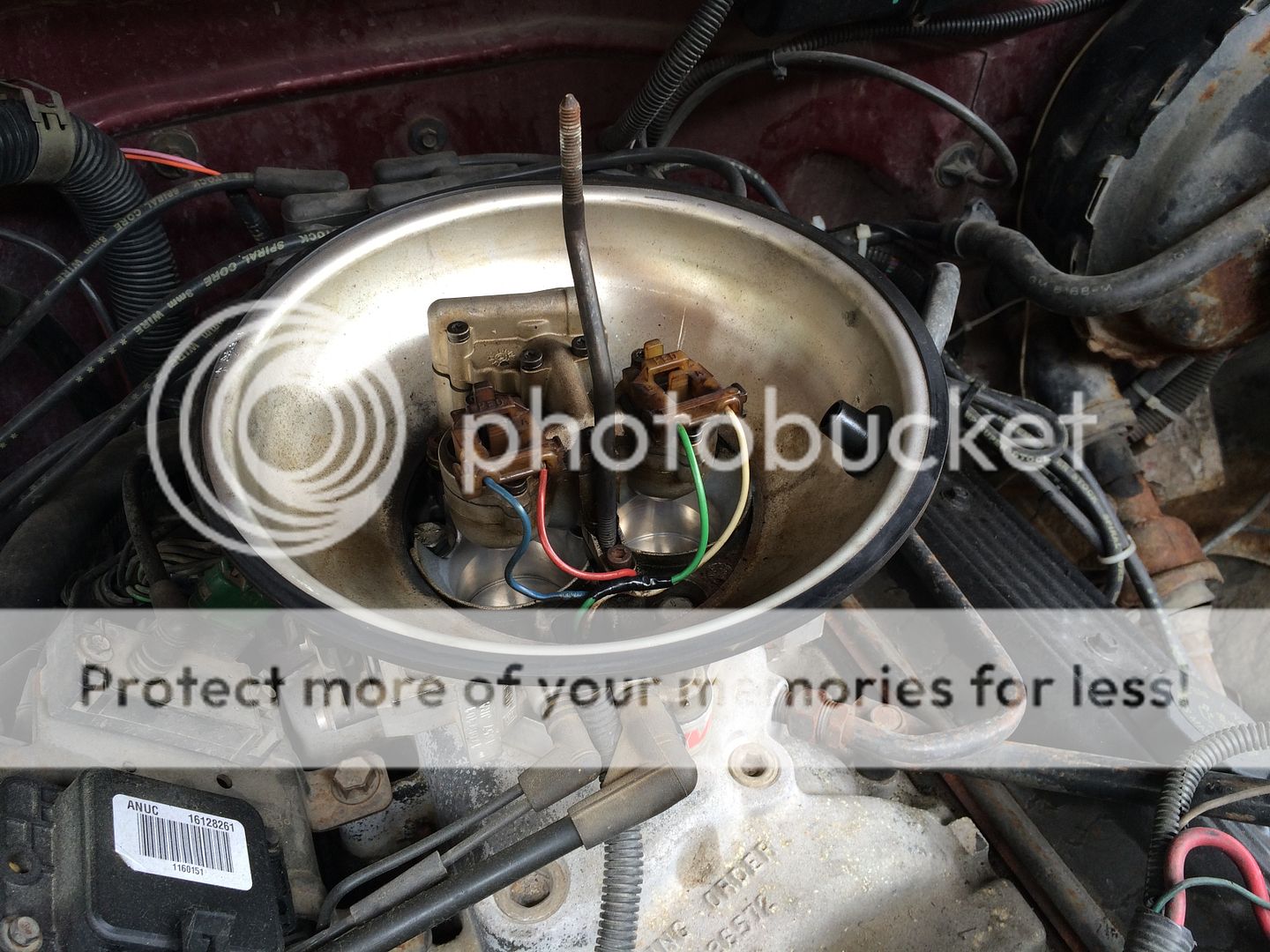

well decided to do a little work today. Went to go replace the horribly dirty K&N filter since it was just beyond cleanable. Went and bought a new specter air filter. The K&N full kit was $127!!!! I was like "Fuck that!" and got this kit for 60 bucks. Decided to trash the factory air box since it was pretty pointless. it was open at the top and the fender intake only pulled air from the front of the engine bay. Besides, Cold air intakes are pointless. the Air gets heated up by the time it travels through the tub. Anyways, while I had the air filter off, I cleaned around the engine bay a little. Didn't spend too much time on it but it looks semi better.
heres the old air filter and air box before the cleaning (well you xant really see the air box, but yeah)
injectors are looking a little dated but it works. and props to the Original owner for that ghetto wrapped wire.
So now I begin the light cleaning. Not much help considering most of the stuff is rust that doesnt clean, but I was able to knocked out most of the dirt.
Before
After
New filter on.

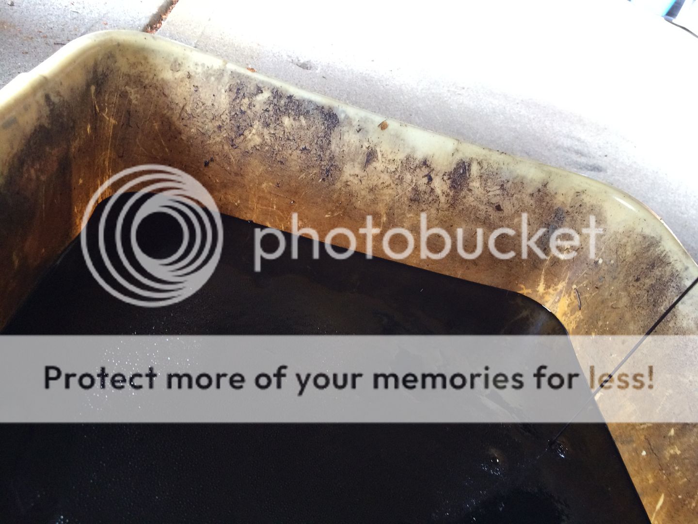

next up was to change the oil and oil filter. Man I was expecting this to be easy but found it was a challenge given the location of the drain plug. Damn thing pointed right at the front drive shaft. So I knew as soon as that bolt came out, Id be faced with a huge mess.
So I improvised! Found a metal pipe in the garage that could hold a funnel and catch the oil to avoid a mess!
never seen oil this dirty. My guess is it had to be a 3 or 4 years old.
luckily the oil filter was easy and mostly mess free. So that was my adventure for the day.
