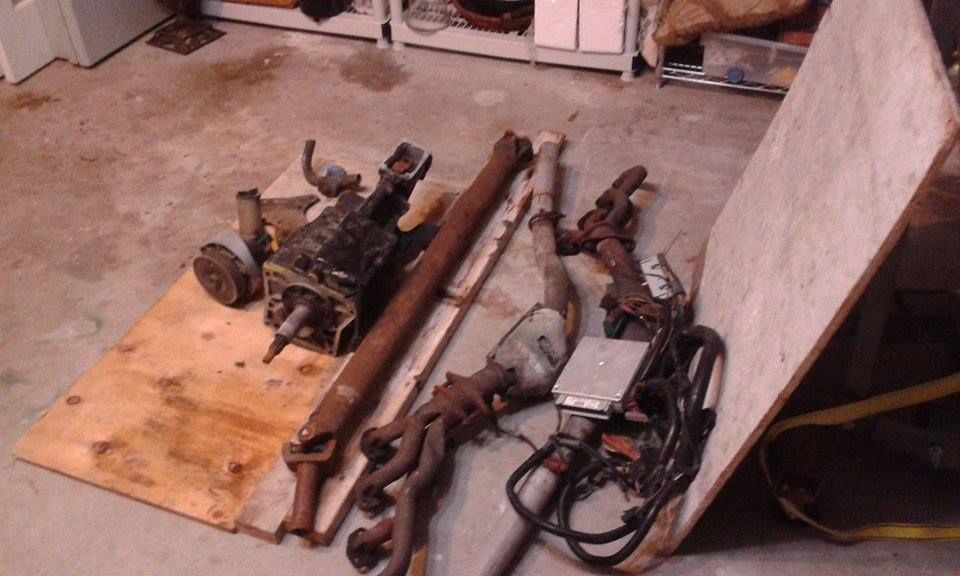

Anyways, I think I got the deal of a lifetime:
-5.0 HO completely dressed up, with everything still connected.
-t5
-bell housing
-stock clutch, flywheel
-engine harness
-engine to ECU harness
-ECU
-Exhaust manifolds, dumps
-o2 sensors
-driveshaft
for $400. Engine spins freely, and did not have any oil sludge.
I had a budget of $1400 for all this, so now I have an extra $1k to do some maintenance.
Im going to rebuild the T5, he said 1st gear popped out every once in a while.
Im getting a new clutch and flywheel
Changing the head-gaskets and head bolts for better ones, changing all the gaskets and seals on the engine, and valve springs for upgraded ones.

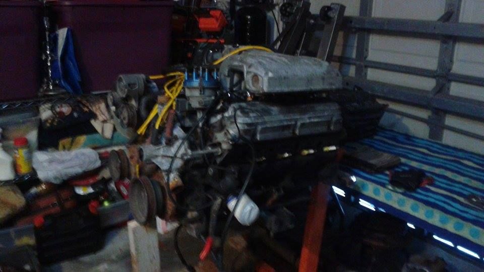

On the engine stand
And the truck I rented to pick up the engine. LeSex

Got some work done on the 302 this weekend
Installed ARP head bolts and Felpro 9333 head gaskets
resurfaced the flywheel
Stage 3 clutch
Painted everything, valve covers, water pump, block...
Custom BMW logo
Almost there
Done!
Crappy pics, Ill take some better ones this weekend. I changed every gasket on the engine, did the chrome oil dip stick, ford racing coil wires, new sparkplugs, cleaned the fuel injectors, new oil pump, and MSD distributor.
