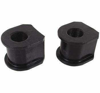

Here's what I bought and swapped out. I couldn't find Rubber Bushings anywhere online so I got them from the dealership.
For 99-04 Mustangs at least. The pictures provided below I pulled offline:
(4) OEM Rubber Steering Rack Bushings: Part#: E5DZ-3F640-B
(2) OEM Rubber Front Sway Bar Bushings: Part#: XR3Z-5493-EA
(2) Front Sway Bar Endlinks: Part#: F6ZZ-5K483-BA ***NOTE:Each set only came with two links, so I had to pick out and re-use two of my old ones. I placed those on the top and bottom, and used the new links in the middle.***
I spent a total of $88.35 for the 8 pieces.
