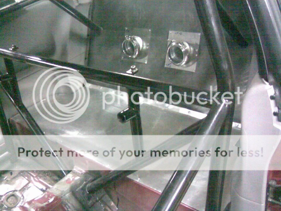

another thing i did was make seat mounts that mount the seats to the roll cage. I have kirkey drag seats so the back is mounted to the harness bar and then i have two bars that go from the rocker bar to the trans tunnel to mount the seat on.
I'm on a work computer but i'll see if i can find some pics i put online a while back. As far as a link to the parts, its just chromoly tubing that you have to fab up, hardest part is making the mount for the steering column. I removed my airbags but i dont see a reason you couldnt keep them.
Check on jegs for just a roll of carpet and then you can cut it out and glue it down yourself
also, while i had the carpet out i scraped off all that sound deadening crap, its extra weight but for a street car you may want to keep it.

Seat back mount
Heres the link to my photobucket with all the roll cage pics, theres none of the dash bar, and this is when i was running factory seats, carpet, and pretty much the whole factory interior

thats pretty nice. i see what you mean about the seats, im just going to put them in the normal way, but the back supposedly mounts to the cage so i will try to make that happen. i hope to retain alot of the factory accessories, like ac/heat, radio, airbags(they make my insurance cheaper. i plan to be able to take this car to shows, weekend rides, maybe to work on fridays, and to the track. i just want to make sure i have it built up to handle whatever i end up putting up front, and legal for the track. also are you in ohio?
