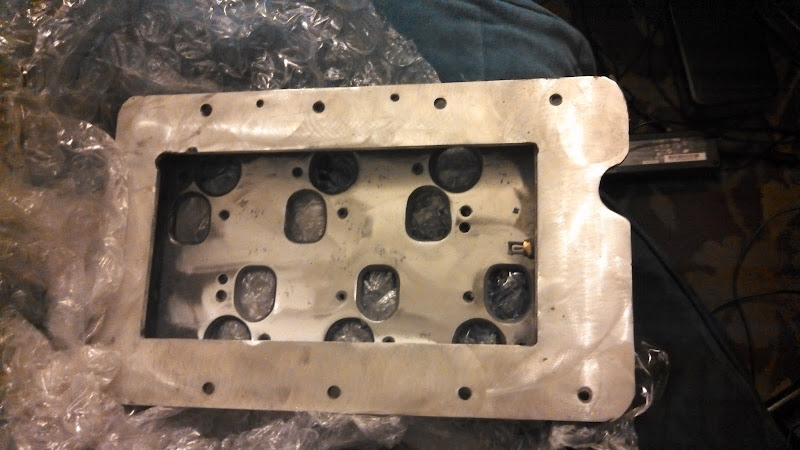

1. Adapter Plates:
There are several different kinds of adapter plates out on the market. There are (to the best of my knowledge and the people I've talked to) 4 variants of the adapter plates. Typically the adapters plates run from 700$ to 900$ depending on who is selling and what version they are selling.
Mysteed:
- The height of my mysteed plate is 2.25"
- In order to prevent the Plate warpage that happens from the welding of the plate, mysteed would send his plates to a CNC place so that they did not exhibit the warpage. Below is a pic of my mysteed plate.

Oh and to add to your adapter plates - Tom Morana makes one as well but it's a bad design. Talk of warping and the compressed air only makes it to the front 2 cylinders since there's no room for it to "spread out"
Price $720
