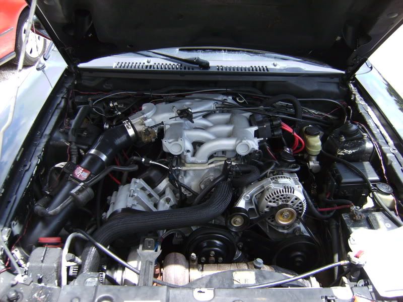

2000 Ford Mustang V6 mustang
4.2L Crank
SCAT 6.125 Forged H-beam connecting rods
Ross Forged 8:5:1 compression pistons .030over
Machined block

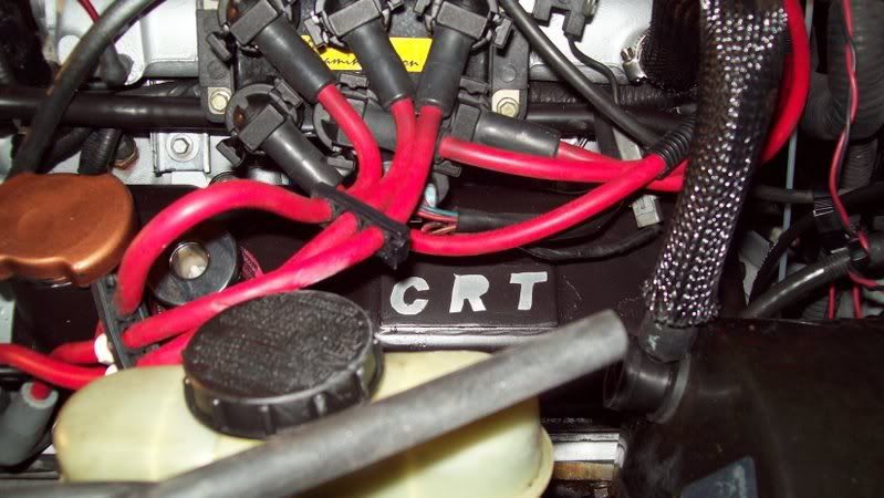

CRT Performance Ported and polished Cylinder heads
CRT ported upper intake
CRT ported Lower intake
Regrind cam .560 lift 216/216
Harden longer push rods
Comp 918 valve springs .600 lift
42% UD pulley
BBK 65mm Throttle body
VAP Intake plenum Spacer
EGR delete, EGR deleted ports in intake
ARP head stud/nuts
SCT BA2800 MAF
SCT XCAL2

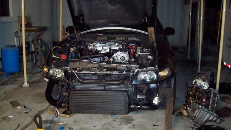

TMA Turbo's Race kit,
60-1 .70 a/r
Tial Wastegate
Tial BOV
Precision Intercooler
fuel is supported by
2 focus pumps
single FPDM
60-62lb fuel injectors
rear end work:
detriot trutrac everything else stock
Cobra R Deep dish 17x9 rears wrapped in nitto 555r's
other driveterrain parts
G-force built t5 tranny rated to 600hp
aluminum flywheel
ZOOM Stage 3 clutch
aluminum driveshaft
Suspension
Eibach Drag launch springs
Lake Wood 90/10s and 50/50s
Sway bar delete

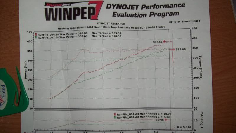

On the stock bottom end, same top end dyno results:
Scott Beers tuned the car over at mustang specialties
on 7psi the car made 350rwhp and 320rwtq
on 9psi it made 390rwhp and 350rwtq
10psi made 400rwhp and 380rwtq
12psi 100octane 439rwhp and 402rwtq
New numbers
15psi 11:0:1 a/f
497rwhp and 508rwtq
