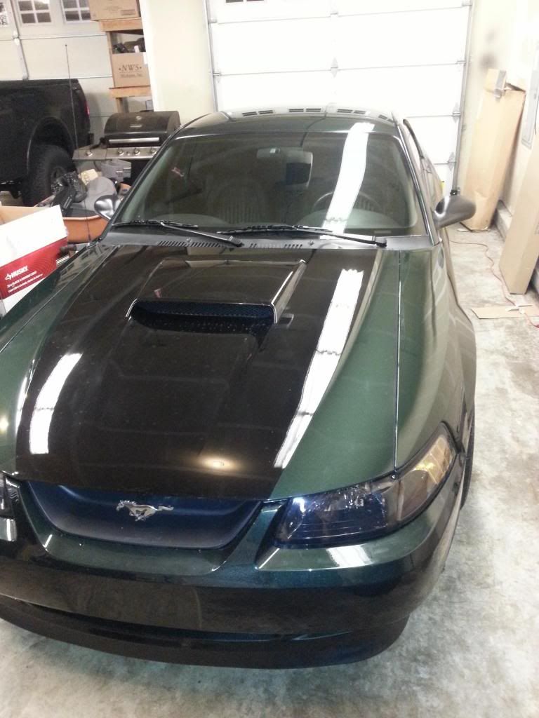

Here she sits before I started taking her apart.

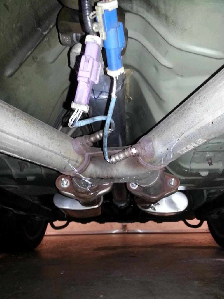

Pulling off my BBK catless X. Apparently I scraped on something. Good thing the rear o2s are shut off anyways.

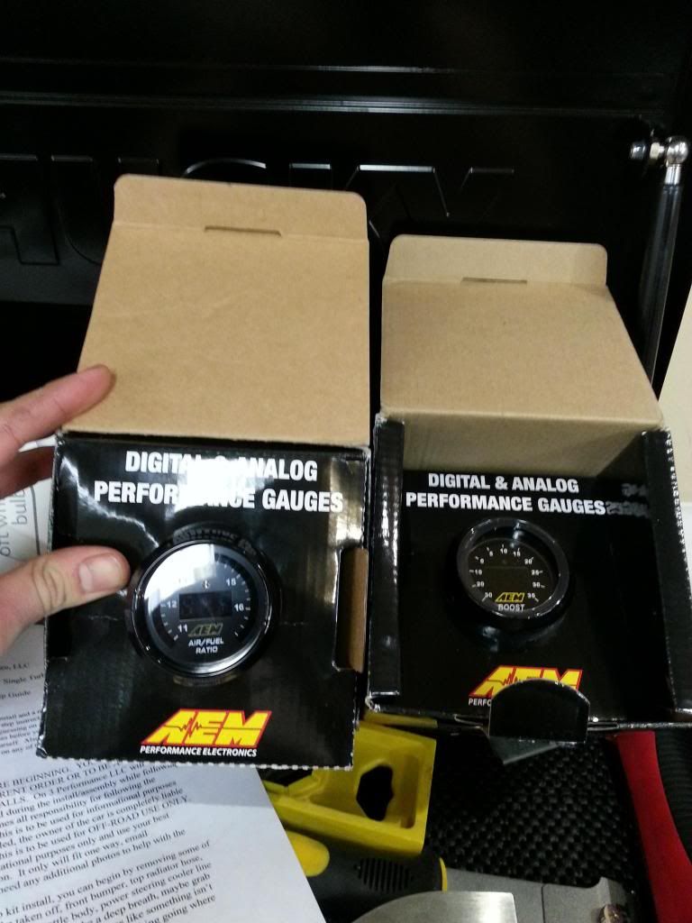

Got my AEM boost gauge and wideband
I spent quite some time trying to figure out how I wanted to mount my gauges. I really didn't want to do the typical pillar pod. Don't really like the steering column mount and blocking my ac vents are not an option. So I ended up going with the Speed of Sound pillar pod.
