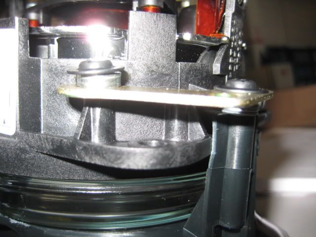

Well I'm not sure how good this write-up will be or how useful it is since the brackets I used are out of a kit we have here at the dealership for key lock cylinders. It happened that they are the perfect size and fit pretty much, but I figure at least you can see what I did and most likely come up with something similar. The only part on the bezels themselves that I modified is in the first pic. I had to cut/sand down the little angular brace that was there to keep it more rigid. Other than that, I didn't modify the bezel at all.
I'll put up the size of screws that I used when I get some free time. The pics pretty much speak for themselves because there's not a whole lot that I did to make this work. And these two brackets actually hold the fogs in there VERY well. Make sure to install the fog lights AFTER you put the bezel in and screw it to the bumper though because one corner of the fog light blocks the hole.
Only thing on the bezel that I modified:

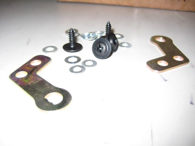

This is the stuff that I used for one fog light:
Moutning:
Finished!
Once I get the sizes, I used 5 () washers under the bracket on one side, and 3 slightly larger () washers under the screw.
