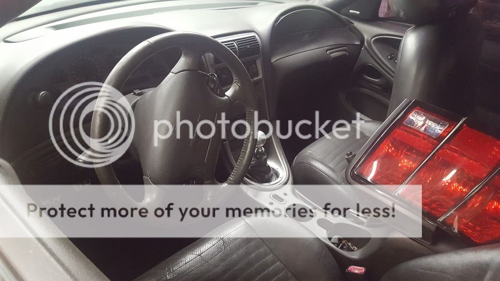

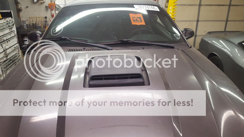

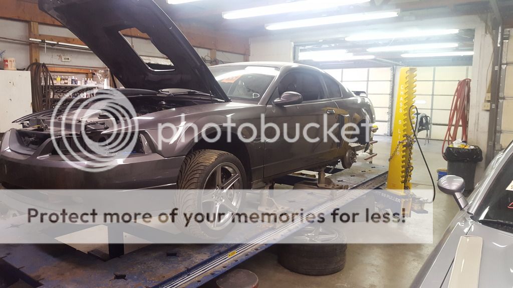

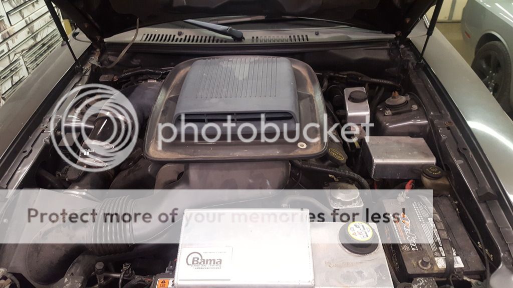

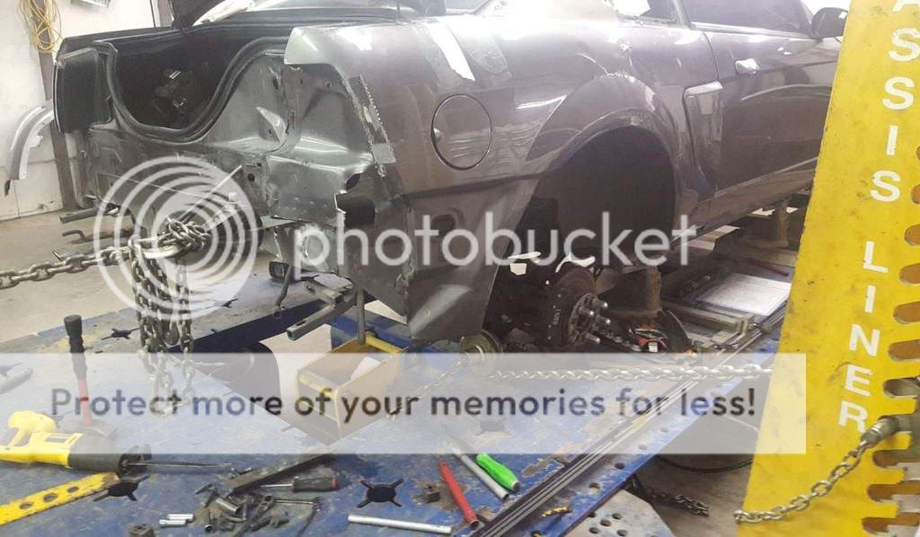

Decided to make a build thread for my mach. No major plans as of now. Just gonna do a gear swap and build the rear. Then try to run 11s NA. First I have to get it off the frame rack which I should finish today once I finished spraying a bumper cover. The cars in pretty good shape inside and out. It was hit a little harder than I anticipated buy nothing I couldn't handle. As of right now I'm gonna respray both quarters, roof, hood, bumper (new), and the decklid (new). I'm gonna fill the spoiler holes and run the car spoiler less. Gonna paint the decklid panel black between the tails, smoke the taillights, paint the roof black, and repaint the hood with the Mach 1 stripe painted. Don't have may pics as of right now.

Well I decided to go ahead and buy another body. The car is gonna need clipped. I should have went this route from the get go but I thought I could save it. Picked the body up today. Gonna get the rear windshield cut out as quick as I can. Let's take 2 cars and make 1 :lol. I'm gonna do a short clip and cut the seam through the floorboard. Gonna make my cuts on the quarter where the sail panels bolts and on the rockers where the seam meets. Gonna get started once the windshield is cut out.
