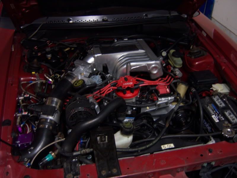

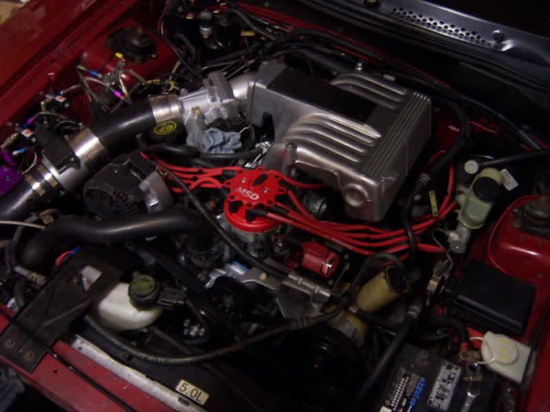

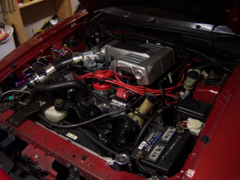

After what seems like forever, i got her running tonight...
stock block, scat 331, keith black forged pistons, comp cam, ported e7s with 1.9/1.6 valves, explorer upper and lower, mac 1 3/4 longtubes, off road h pipe, and cat back, built aode, custom valve body and edge 3000 stall. Will have a plate kit with at least a 150 shot before spring

thanks, its taken a long time to get this far with it and ive still got a very long way to go. had her since i was 17

gotta say, this motor pulls as hard as my stock 302 with a 150 shot. pretty damn pleased. now i just gotta get some better flowing heads, get the nitrous kit back on and get a tune. should be pretty fun then
