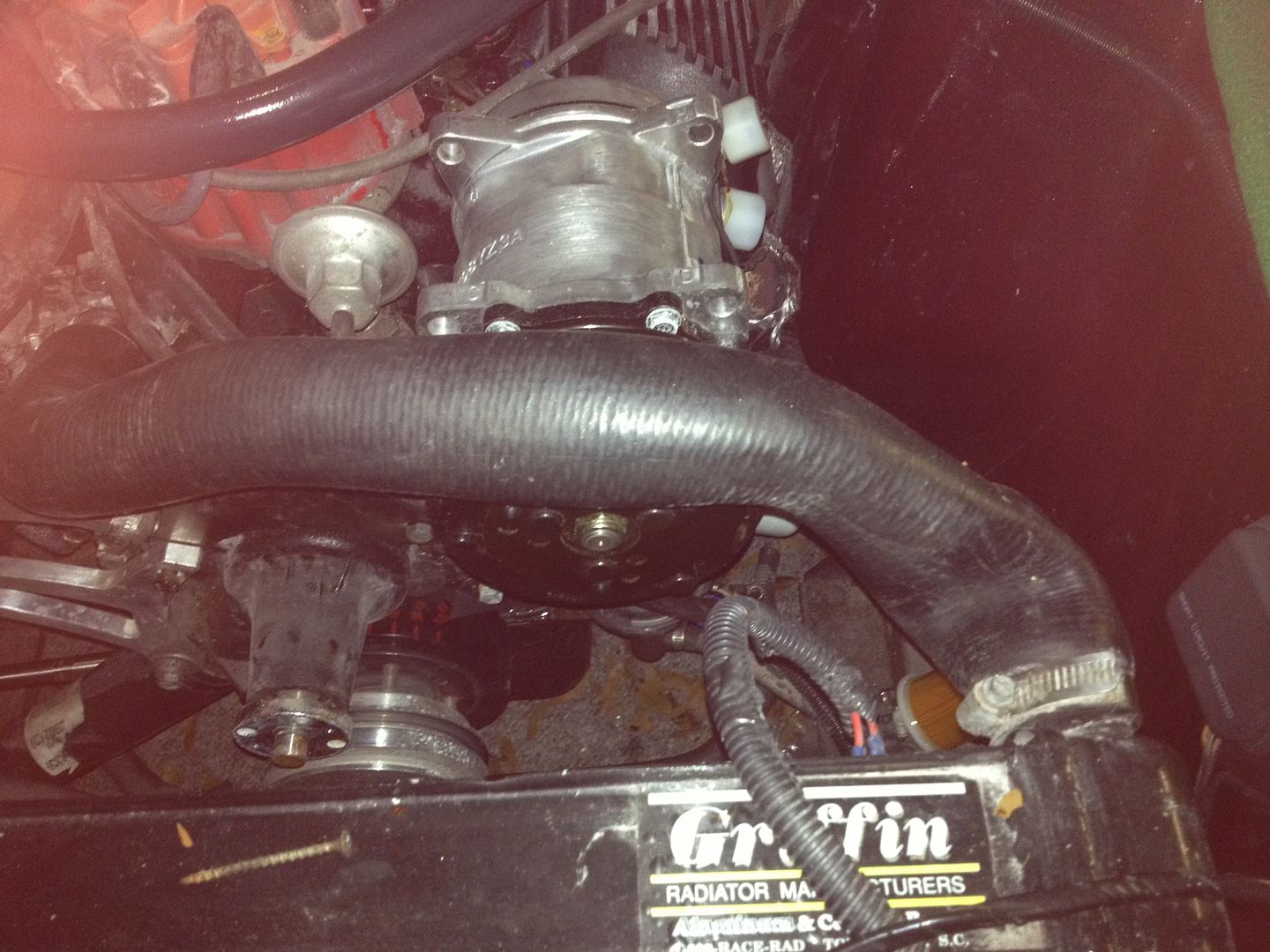

The breaking news of the month is that it is freaking HOT!!!! It didn't take long for AC to get moved up the priority list straight to #1. I've decided to go with the OLD AIR HURRICANE unit that includes the all electronic controls.
My first order of business was to try and get the bracket mounted in the engine bay and determine if I could use my existing 2-groove billet pulley, or if I'm going to have to use the ugly cast iron 3-groove they sent over (or spend more cash for a billet 3-groove). Before I had turned the first wrench I had determined that I was going to have to hack some things up. I used a really large bolt to plug the smog holes on my AFR heads, and the top of the bolt was interfering with the bracket. I wasn't keen on grinding off half of the bolt just in case I ever need to remove it, so I decided to notch the bracket:
After the bracket was installed, I noticed that the AC compressor had a 2-groove pulley on it, and sure enough, the inner groove lined up perfectly with the outer groove on my 2-groove crank pulley. What doesn't line up is the idler arm. I am either going to have to trim the idler bracket or use a 3-groove pulley. I plan on looking into how I would trim the idler arm tomorrow.
The other issue I have that will need to addressed regardless is that since I swapped to the Griffin cross flow radiator, my upper hose passes right through where the compressor needs to be. I think I am going to have a piece of stainless exhaust pipe bent by a muffler shop that will clear the compressor. Either that or shell out for a cool-flex hose. I'm strongly leaning towards the pipe, because it would be less than half the cost of the cool-flex hose.

I decided that cutting the idler arm just use a billet crank pulley was dumb, you can't see the crank pulley once you put everything on anyway. I swapped in the 3 groove pulley and everything lines up nicely, however I ran into another problem with the bracket. Old Air list the same kit for a 289/302/351, so I assumed that the bracket would have holes for both 302 deck height and 351 deck height (for mounting to the head). Well we all know what my pappy used to say about assuming. Something about a mule and you and me....
I had to make a template of my head and drill new holes in the bracket so that I could mount the support bolts. I'll take pictures tomorrow when I'm done, I need a bigger step drill bit to finish up.
