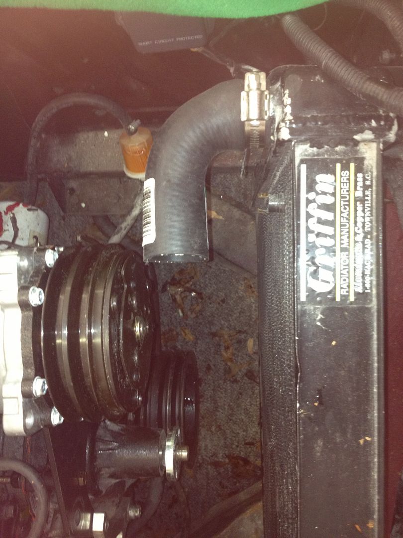

As for the cooling hoses, I was about to buy the summit hose, when I thought to ask MustangGarage how tight of a radius he could get with his hose. He snapped a picture for me, and it looked like coming out of the Radiator, the smallest turn I could make would be 6.5". I only have 4". So I bought a 90* Radiator hose and cut it as tight as I possibly could, I have about 3/8 clearance between the hose and the compressor. I think it will be fine because the front of the compressor is a cover, and is not spinning. I am trying to find a piece of stainless tubing that I can have bent at an exhaust shop to finish the run, if not then I will have to use regular exhaust pipe, and I would probably have that powder coated.
