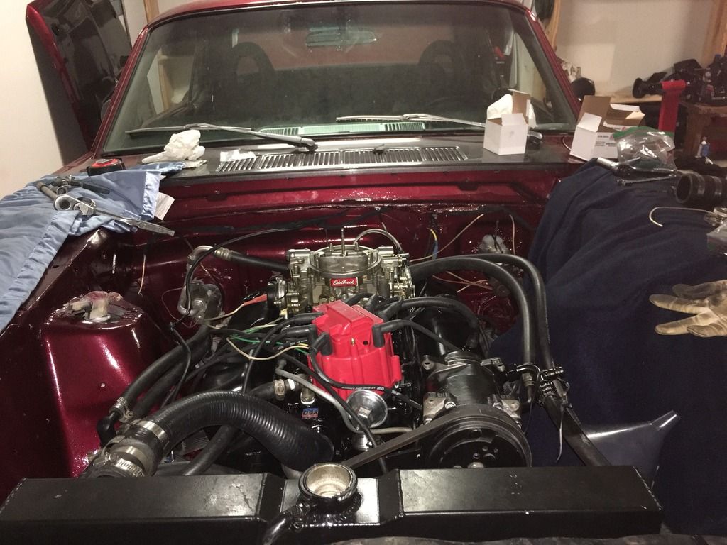

I've had a rough few weeks, and was really looking for something as a pick-me-up, so I jumped a wire from the battery to the distributor and fired the motor up for a couple of minutes. Not exactly a whole bunch you can tell by hearing a car with open exhaust running, but it cranks. I think the squeal is the alternator belt being a little loose. At least I hope that is all it is. I was initially afraid it was an oiling issue, but I pulled a valve cover and had plenty of oil.
