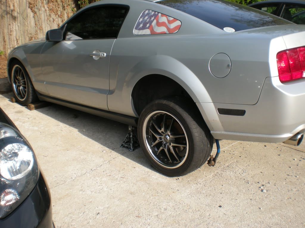

After near nearly two weeks of my car sitting like this...

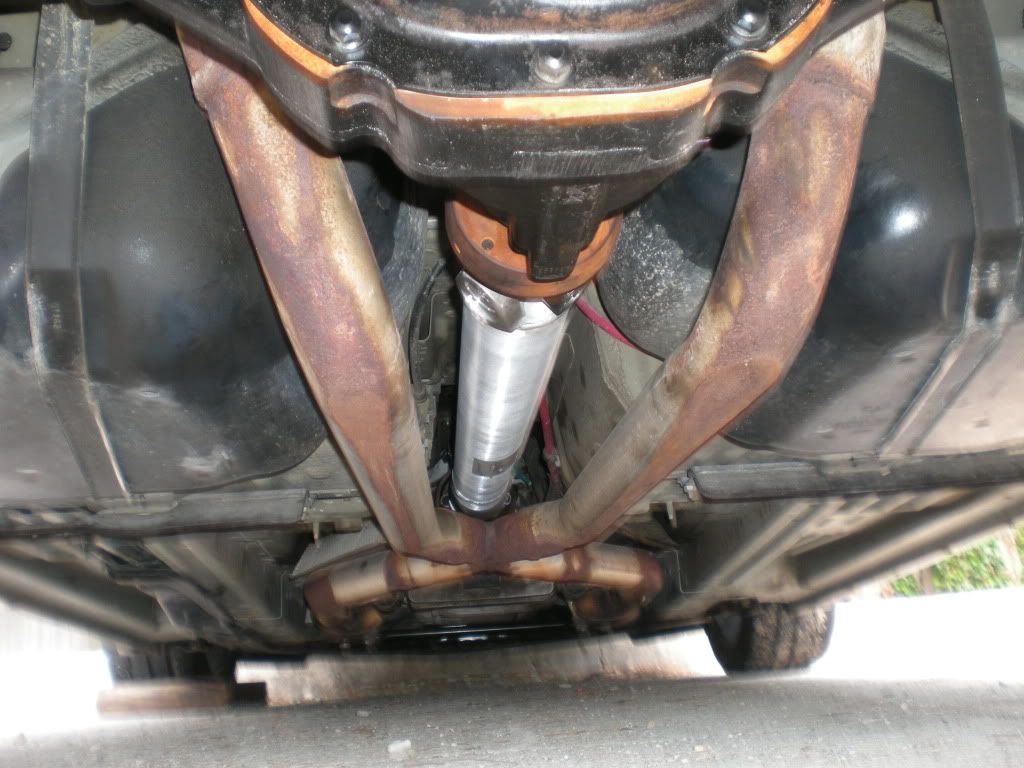

...my drive shaft cam in and I was finally able to finish installing my 8.8.
I have noticed that with the 3.5" drive shaft the engine seems to rev up quicker, and with the lsd in the 8.8 I can actually hook a decent rpm launch. I would have liked to have gotten 3.55s but for the price and convenience of picking up this 8.8 I won't complain about 3.31.
All of this means that now my only major weak link is the T5.
A side note to anyone wondering the shaftmasters 3.5" shaft with the GT 6 bolt flange costs the same as the GT shaft.
