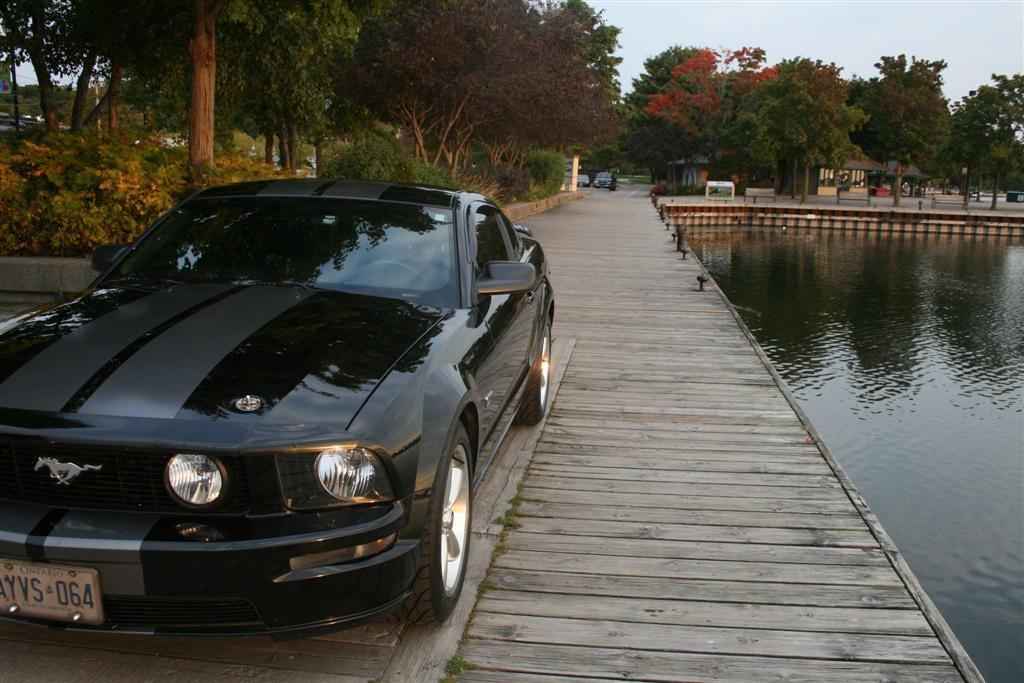

8.5" x 18" rim?
If so, please show me a few pictures of how that looks,
particularly side shots, like these:
I'm mostly interested in how much sidewall bulge there would be over
the 255/45/18's I'm running that are on the car in those pictures.
Spanks.
