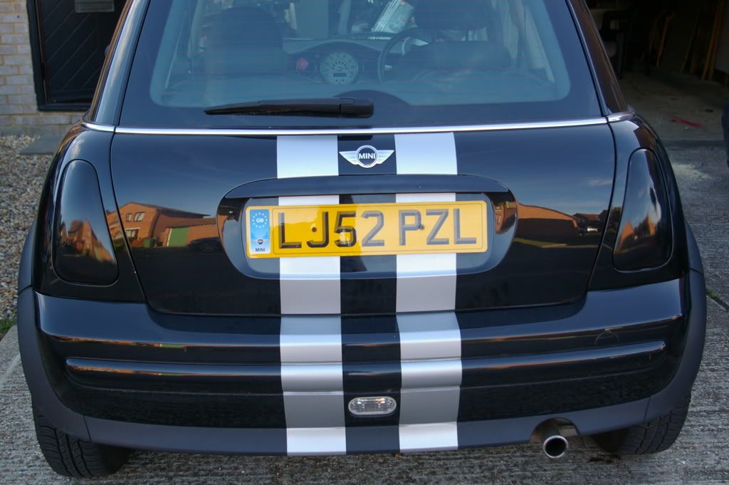

I did the back lights of my wife's Mini myself with black spary paint and a few coats of clear lacquer on top...
turned out like this...
I wouldn't imagine it's too difficult to do the front lights too, especially if they are plastic lenses
