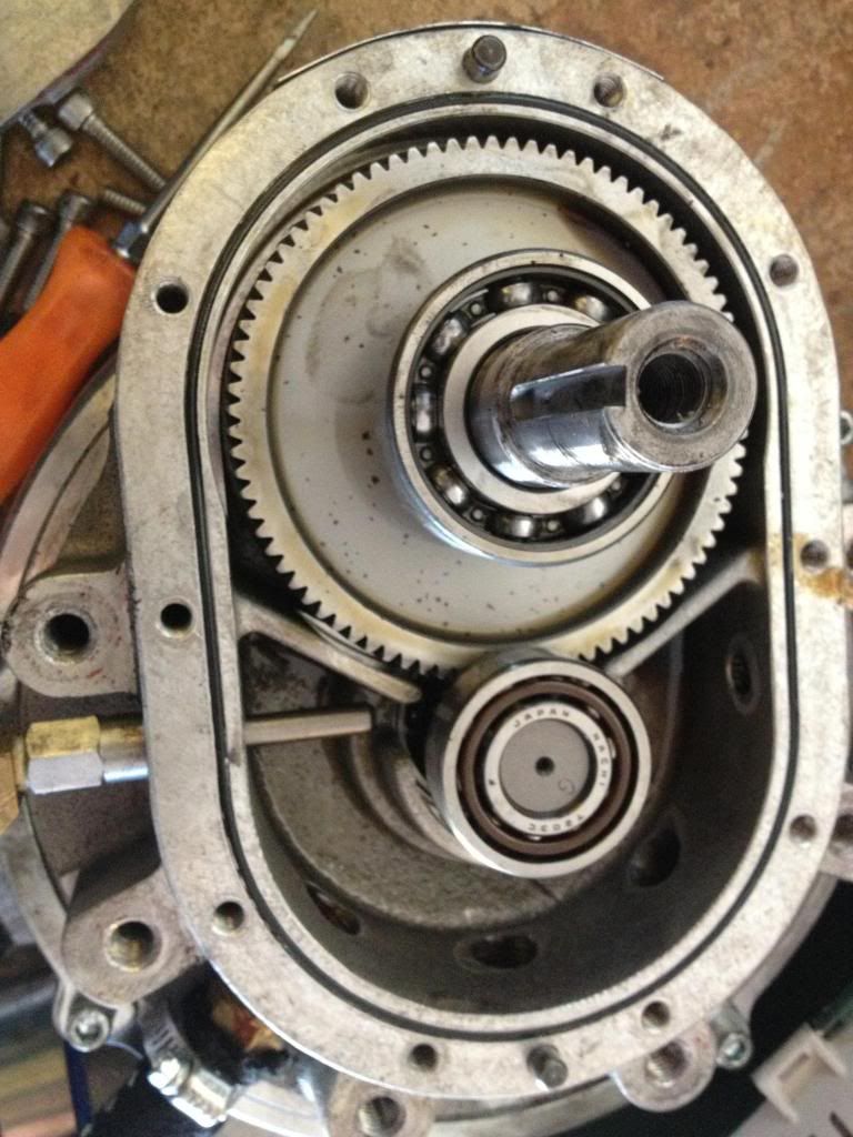

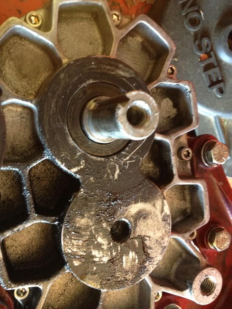

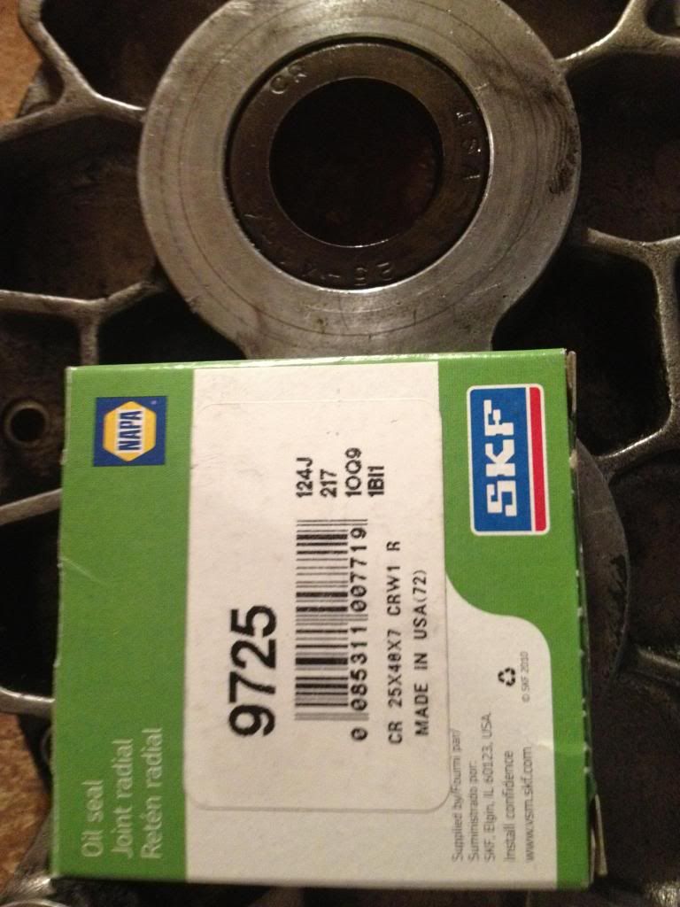

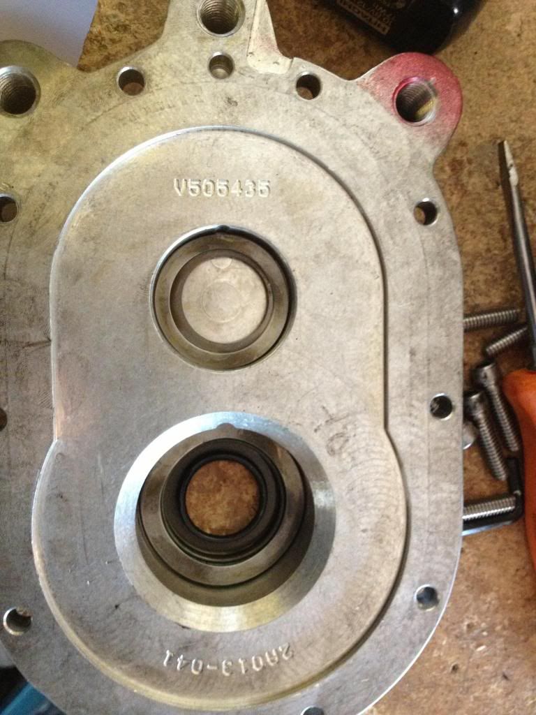

So I had a terrible belt squeel the other day when I started up the Mustang, I decided it was time to change the belt anyhow cause my pullies were slightly out of Alignment. When I looked behind the blower I found the reason the belt was squeeling. The vortech Shaft seal was leaking oil really bad. 350+ dollars to send it back to vortech OR order a seal from Napa and replaced it myself? Of course I replaced it myself, and it was very easy Just remove the bolts on the back of the blower cover then lift the housing off, Tap the seal out of the back cover, then install a new seal. Reinstall in reverse, just be careful not to pinch the big O ring. have you ever wondered what it looks like inside a T trim? well here you go. the 8 rib kit vortech sends is a pretty good kit, But the spacers were just to big for my pullies to all line up properly, so After buying a laser level, I ended up using washers to get mine lined up real good tonight. just a few things to put on tomorrow and she will be back up and running without all the squeeling.

Never had this happen before, but its just a part of the game, im just glad I was able to repair it so easily at home. While I had the blower off i cleaned everything up and got it all looking new again, tomorrow I just need to get my intercooler piping back on and make a few adjustments.

I put the part number from napa on here for the Vortech guys, im not sure if this seal will work on your procharger or not. Once you pull off the pulley on the blower look at the oil seal numbers, and youll be able to match a seal up that way. I cant imagine it being a different seal to be honest, but you never know.

Quick probably dumb question but which is the output n which is the input shafts?? I'm guessing output is were propellor is and input is were the pulley is?

Input shaft would be where the pulley mounts, the output would be the impellor.

Same exact seal is leaking on mine. I was thinking about sending mine in, but I think I'll just replace the seal. Then send the blower in to be upgraded to an Si trim. Vs $350 for new bearings and seals plus $380 to upgrade.

Dont send it in there is a part number on my first post, just get that seal from NAPA, and change it yourself its pretty easy.

Thanks man! That part, is the seal rated for that rpm?

No problem its the Exact same seal that Vortech puts in it.
