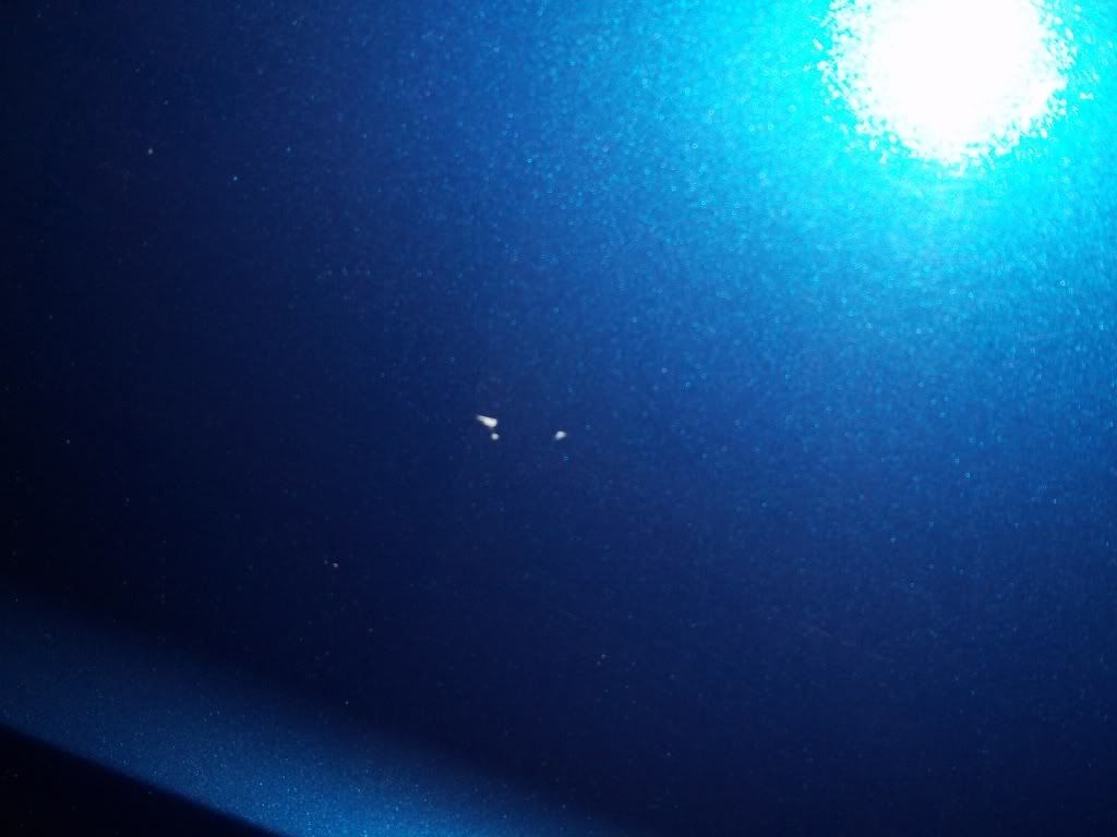

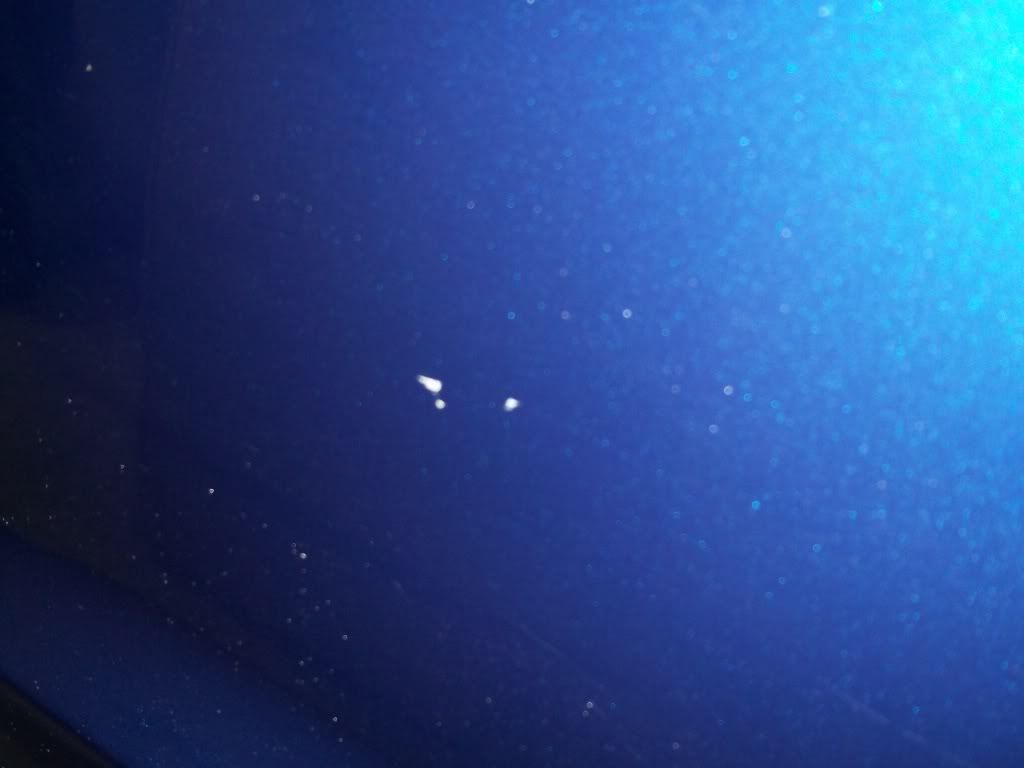

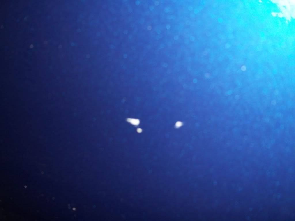

Well I came out of Publix this afternoon to find that my car had been molested by some jackass that opened his door into mine and it chipped the paint. Can I fix this myself? What can I do any products or anything I can use? I need help because this is going to really bother me.

That can be touched up. Something like DR Color Chip should take care of it.

Good luck. For future reference, if you can feel the damage with your finger nail than it can't be repaired by polishing. If you can't feel it than you can repair it by polishing with the appropriate pad and polish.

Thanks I will take all the luck I can get. I can definitely feel it with my fingernail and as soon as I saw it I new that polishing was not going to work on this. When I get the product I will post before and after pics.
