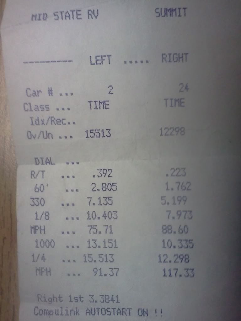

Hey guys I'm trying to get some advice on what I can do to get them time down a little. Seems a little high for my mph. My mods are a Vortech setup, 4:10's, 315/30/18 hoosiers, and Lowering springs. I know the springs are not a good setup for the track so I will have some drag springs in soon. Here is my slip.

With a 117.33mph trap, you could definatley be 11.7-11.8. With some more practice you should be down there. How is it out of the hole? Bogging at all? Thats a good 60 foot, but it could be better. If you can swing it I would look for some 15" or 16" MT ET Streets, or Hoosier QTP's

OP, definatley can do better. Just practice. And when you can, go with 16 or 15" wheels and sticky tires.

not a bad short time. if you go to a big and little set up and get the heavy 18's off, you can shave time off. 117 is good for 11.5 if you are hooking hard.

Weird you only ran 88mph in the 1/8th but ran 117mph in the 1/4th sounds like it pulls hard when it starts building boost

yep the motor is all stock besides the blower, so she lacks a little on the bottom end.
