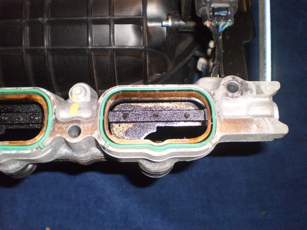

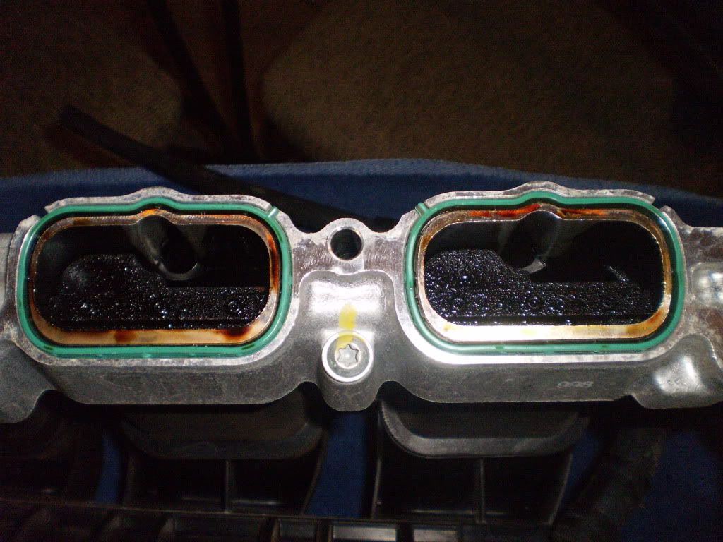

My car only has 22k miles on it. Should I already have this much build up?
Im guessing since the build up is bad there that it will also be bad around the plugs and that my chances of breaking one when changing them just went up.

i don't really know much but when i took mine off they were alot cleaner

It is because you need an oil seperator. Hit up steeda or someone like that and get one you will see a drastic reduction in build up.
So this should be expected? I knew it would have some but I just really didnt think it would have that much. I am putting a oil separator on soon so hopefully this doesnt get any worse.
Definitely get the oil seperator. Once you're cleaning up your recycled intake air you'll probably notice low rpm consistancy that wasn't there before.
I'm running valve cover breathers, but can't recommend them becuase I'm going to swap for a seperator kit to get rid of the in cabin fumes. :eek: x_x

mine were A LOT cleaner when i took them off at 18K miles...i also have a breather set up on both valve covers though...
